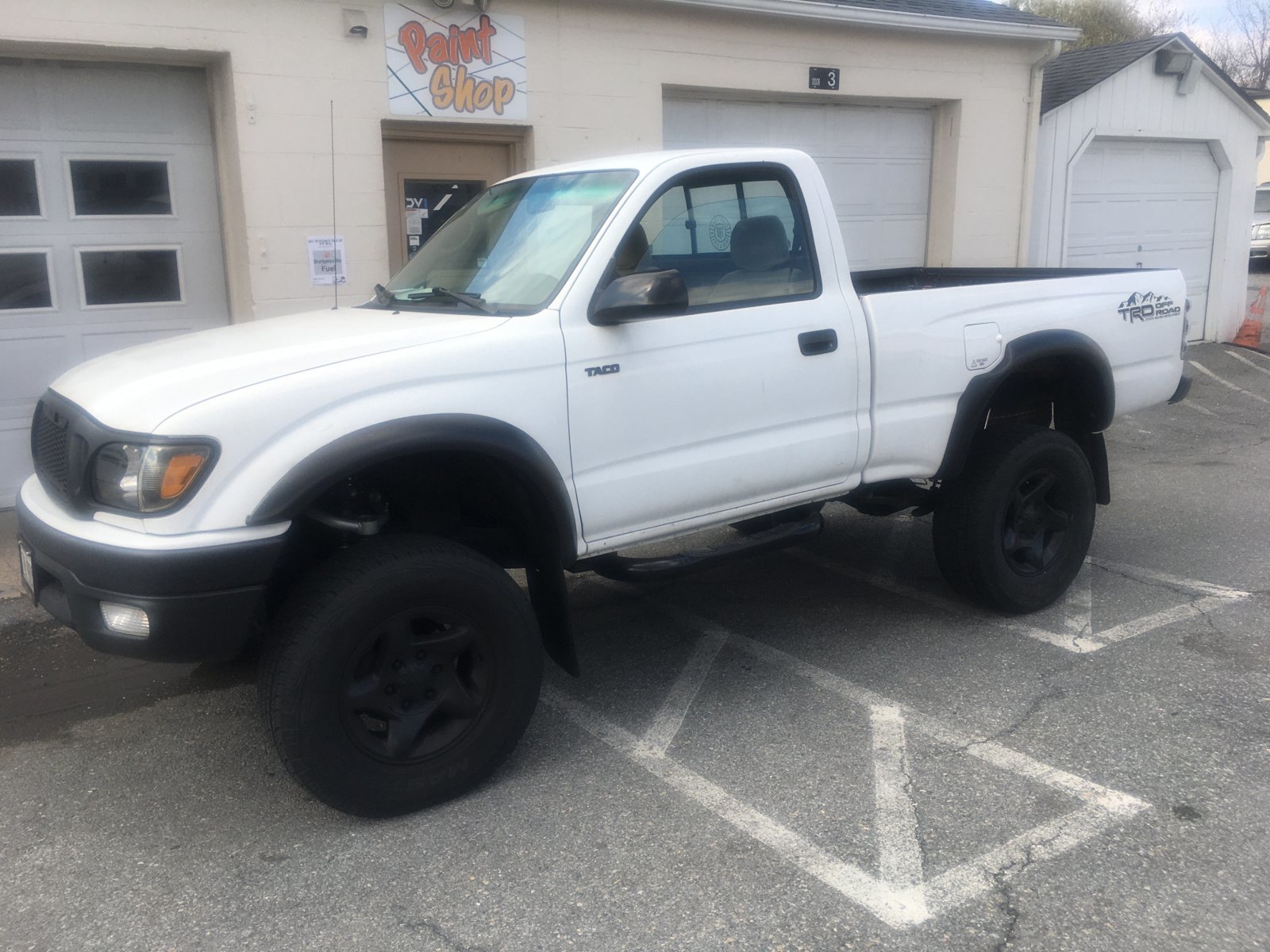

    this is after I did some body work and painting and blacked out all the chrome and wheels, but before I did the suspension and swapped out the frame, which was completely rusted out! But the body is in great shape with almost no rust at all.

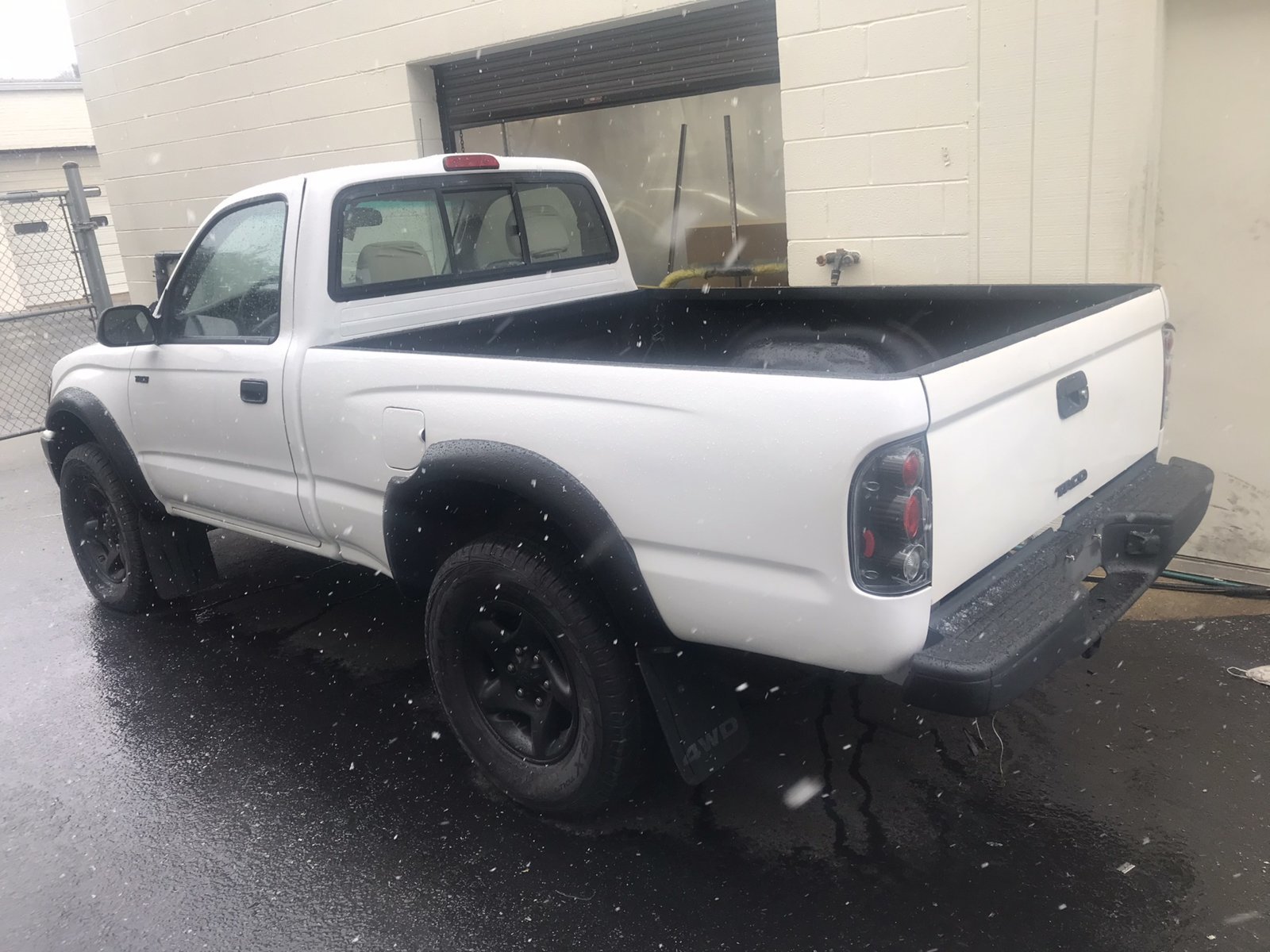

    I found out that there was a recall on the frame, so I took it to the dealership to get it replaced, but they said it was too old and the recall had expired (I didn’t realize that a safety recall could expire) but I was lucky enough to find a frame that was in good condition, so I spent the better part of the past year swapping everything over to the new frame.

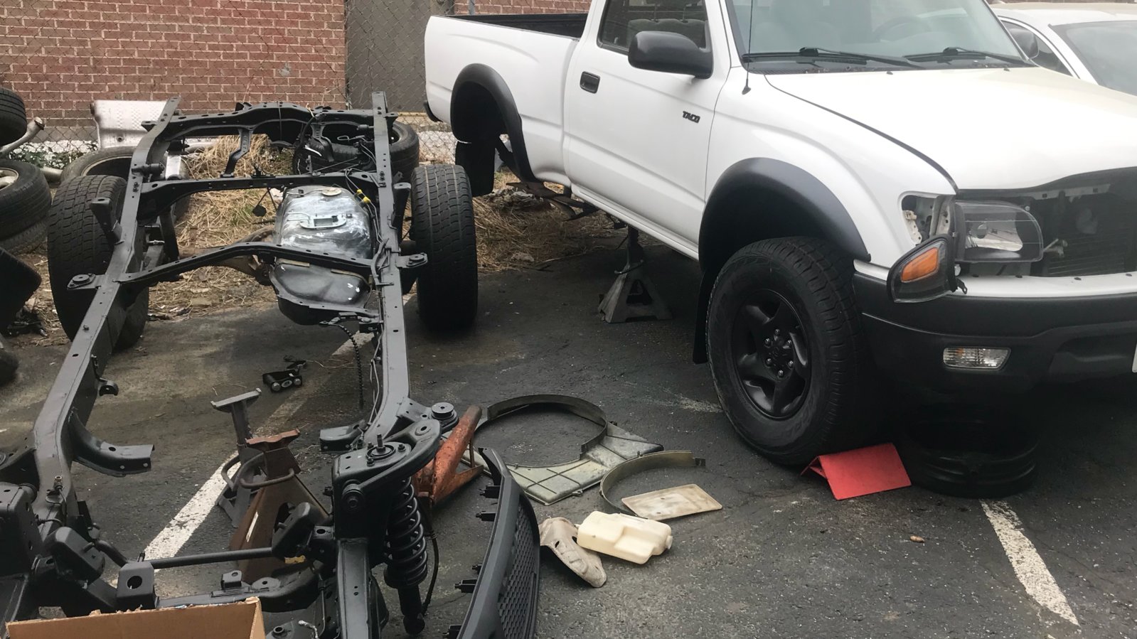

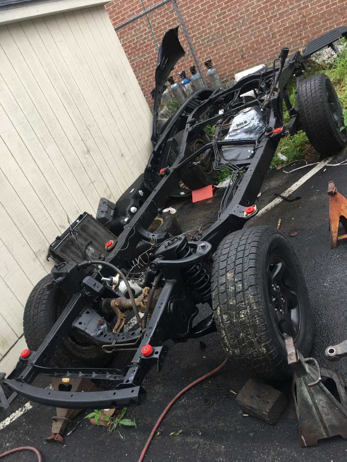

    62BC5F80-301C-49E4-A9FB-DB2F2869342C.png EBA9DA70-5512-4BA4-B99C-B8F0CDD51D40.jpg
    Getting ready for the frame swap. The old frame was rusted out so badly that the rear bed section was literally breaking off with the front cab part on jack stands lol.

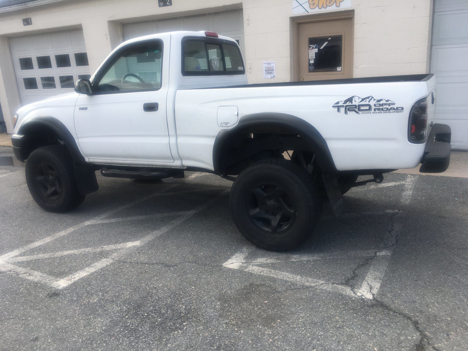

    This is after the new frame and suspension
    Now I need some bigger tires to fill that gap!!! Any recommendations for 33” all terrain tires that look cool and also ride good on the street?

    The rear sits about an inch higher than the front but I plan on getting a camper cap for the back so hopefully it will level out nicely with the added weight on the rear
