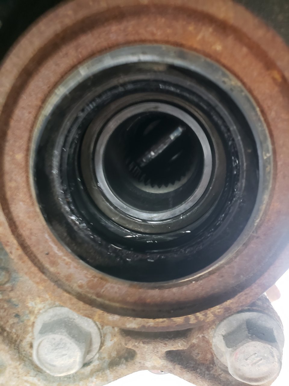

  12. Jul 2, 2022 at 10:03 PM
    Chinytaco
    Chinytaco [OP] Member
    Jul 2, 2022
    #400554
    15
    Christopher
    2012 tacoma
    Lift

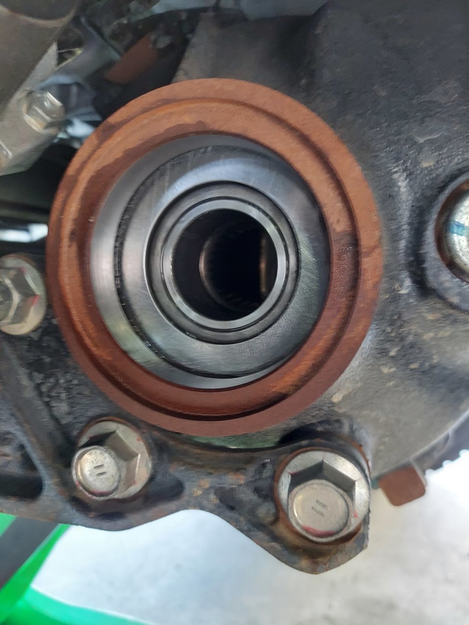

  13. Jul 2, 2022 at 10:03 PM
    Chinytaco
    Jul 2, 2022
    #400554
    15
    Christopher
    2012 tacoma
    Lift
    Is more the 1 sleeve attached to the diff housing

  15. Jul 2, 2022 at 11:07 PM
    Chinytaco
    Jul 2, 2022
    #400554
    15
    Christopher
    2012 tacoma
    Lift
    How can I pull it back out without taking the diff apart

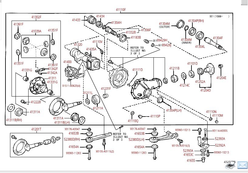

  16. Jul 2, 2022 at 11:21 PM
    #16
    TnShooter
    TnShooter The TacomaWorld Stray
    Sep 2, 2010
    #42625
    21,099
    Deogee
    07' TRD Off-Road, Auto
    STOCK
    I don’t know, I’m still trying to figure out how it moved?
    I’ve even looked at diagrams and I can’t figure out what that is.
    I think it’s part #41311B in the diagram. Which is a plate washer that is in front of the bearing.
    I’d honestly wait until some other guys jump in, I just don’t think it should have moved. The bearing I believe is pressed against the carrier.

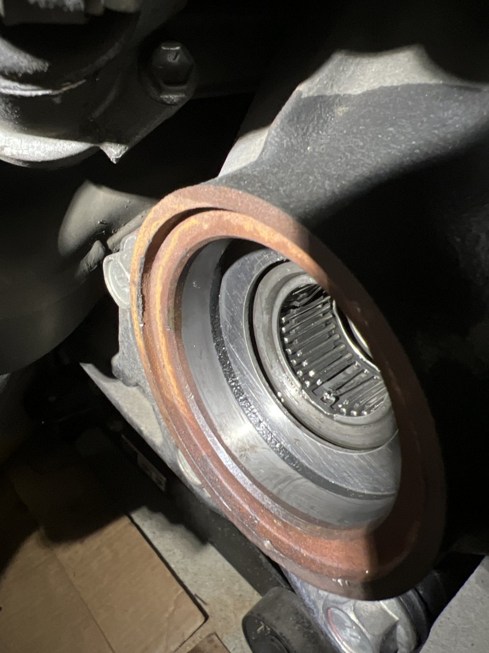

  17. Jul 2, 2022 at 11:28 PM
    #17
    Superdave1.0
    Superdave1.0 Grandma Dave
    Dec 27, 2018
    #277158
    6,234
    SoCal
    LX470, 2025 Civic Si
    I think the diff is still ok and not affected. I could be wrong.
    Here are a couple photos of ecgs bushings I've done. I'd bet the OP can still successfully pull the needle bearing out, and install an ecgs bushing. I've only used ecgs tools to remove and install the bushing, so I can't comment on other tools for the job.
    TnShooter[QUOTED] likes this.
