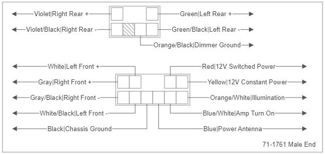

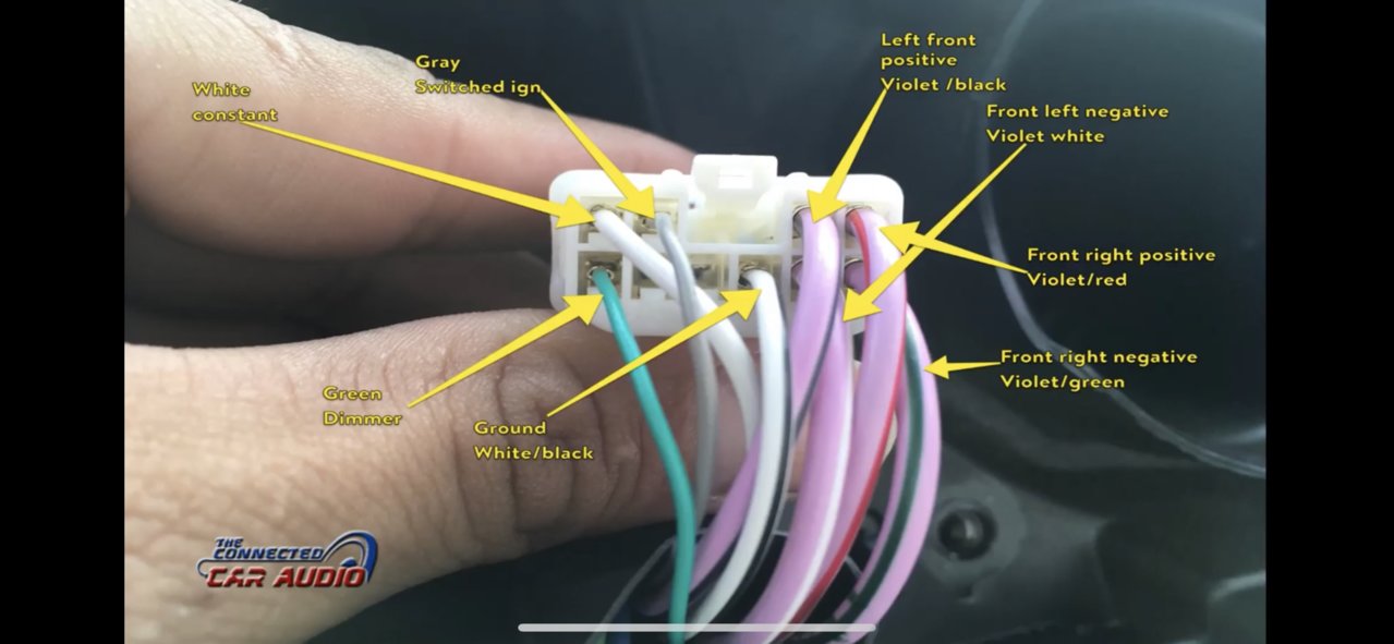

    Question? I’m trying to add a amplifier to my stock radio (non JBL) 2016 Tacoma SR. Can I splice into the ignition wire (grey Switched ign) to run the remote wire going to the amplifier?

    If I'm not mistaken that is the photo from the 2020...

    Blue wire with a white stripe. It “might” be a different color, not sure because I used a metra harness, but the location would at least be correct.
