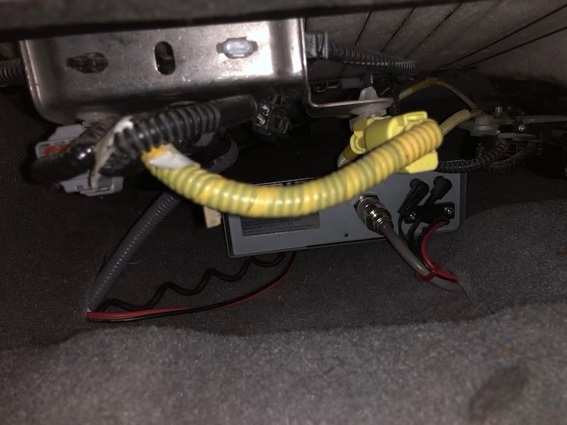

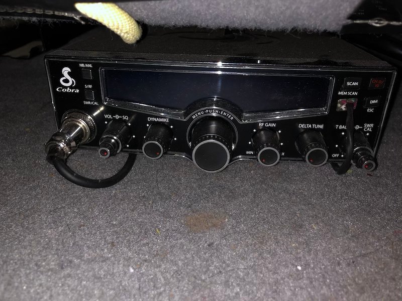

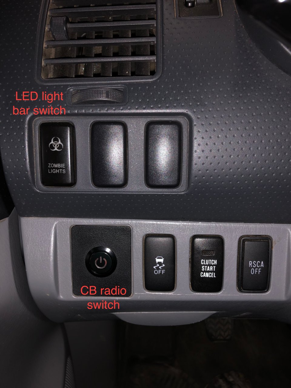

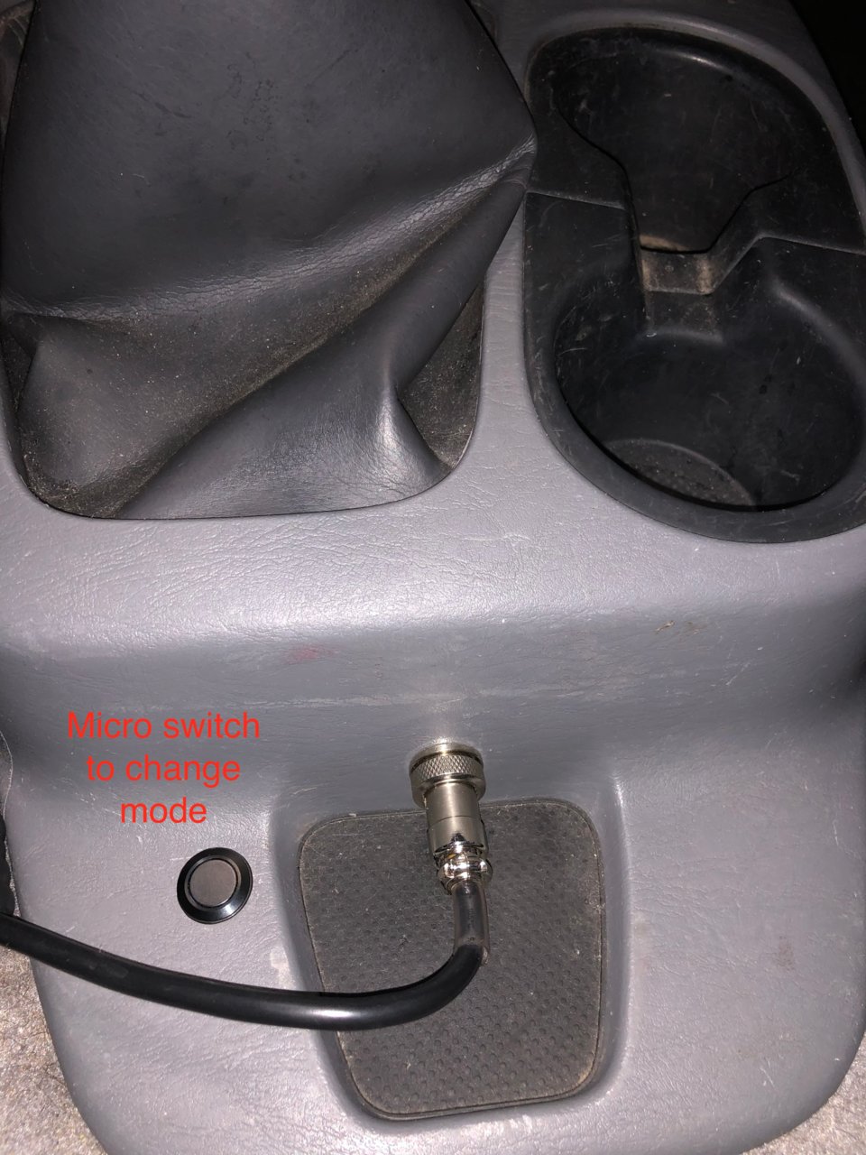

    Next I wired up a cobra 29LX CB radio. I wired it directly to the battery through a push button switch. Since there isn’t much room to begin with in the access cab I mounted it under the seat and ran the microphone port underneath the carpet to the trim right behind the shifter. I then added an external speak behind the drivers seat headrest and a loud speaker in the grill. Next problem was that I couldn’t switch from the CB to my PA without getting out of the truck so I took apart the CB and wired a micro switch directly to the contacts and put the switch next the the microphone port. Pics to come...

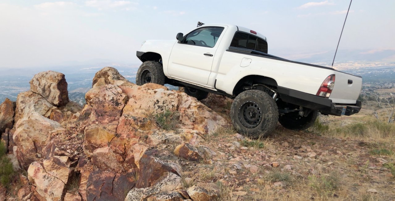

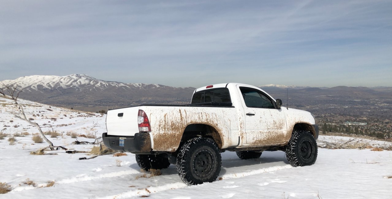

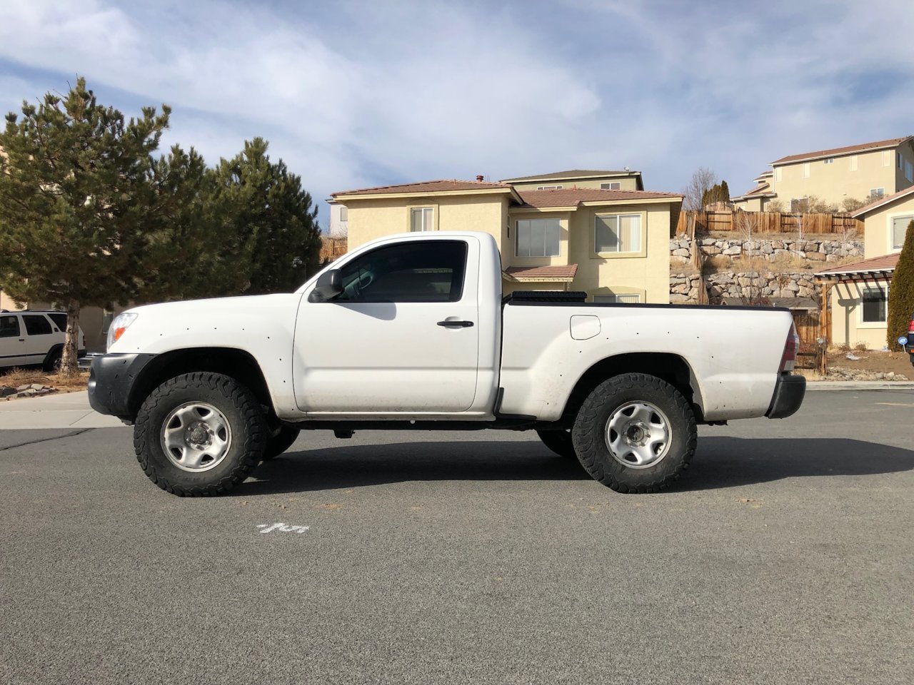

    Then it was finally time for a lift. I ordered up some Fox Racing 2.5’s with the external reservoirs, pro comp UCAs, OME progressive leafs, front diff drop, Method wheels, and BFG AT’s in 285/70/17.

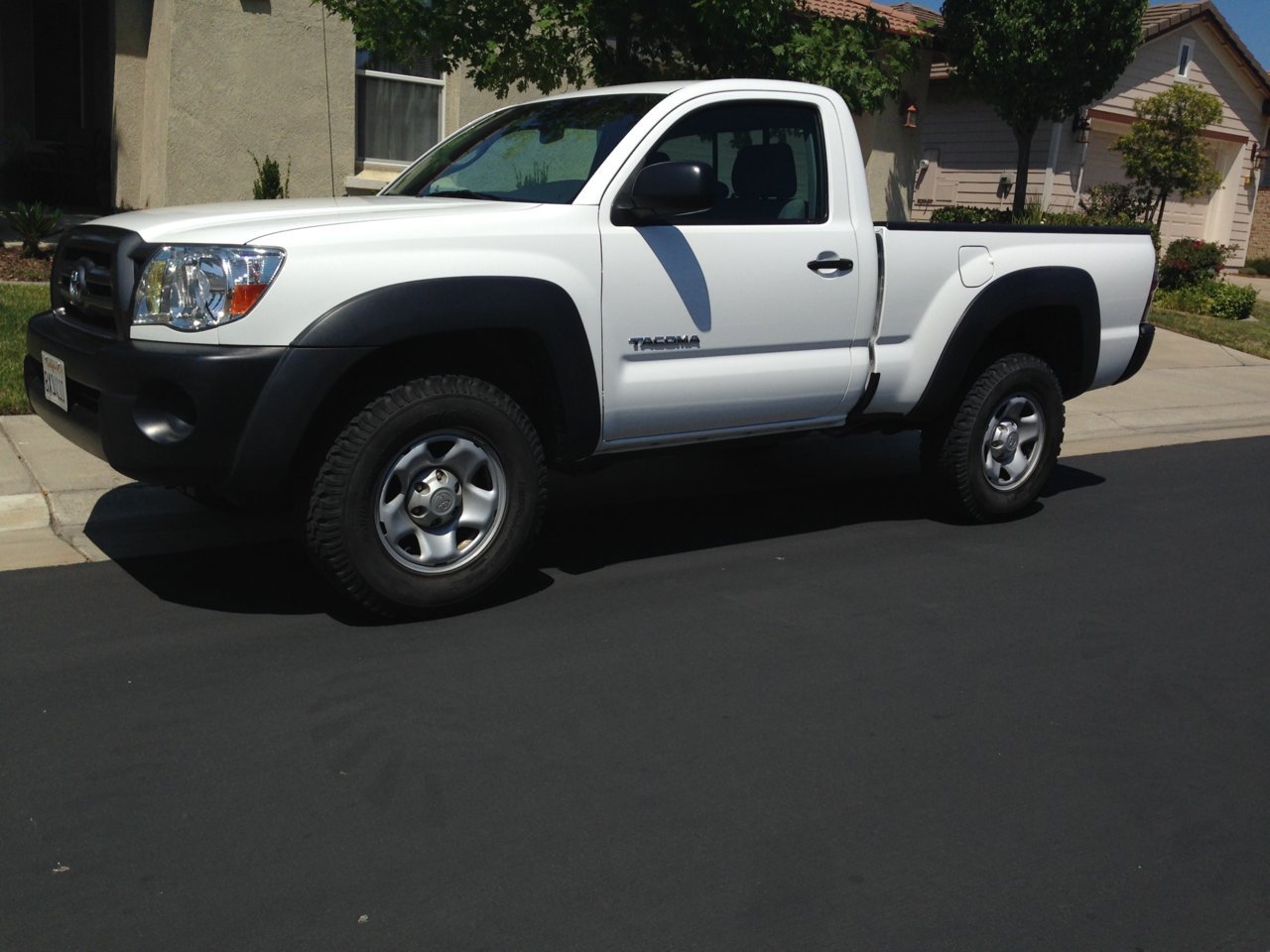

    Before the lift. I think I had 200 lbs of sand bags in the back when I took this picture.

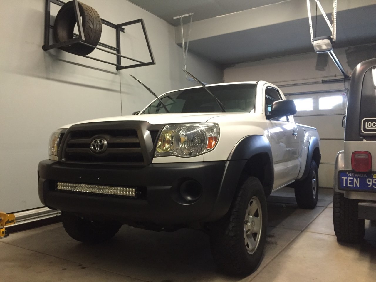

    After.

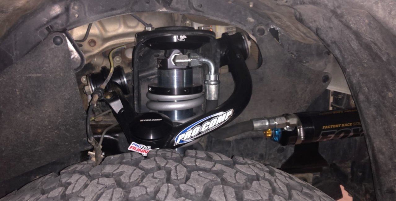

    Here’s a pic of the front suspension.
    I got roughly 3 inches of lift in the front and 4 in the back. I’ve been keeping the sand bags in the back to try and settle the new leaf springs a bit faster. With the sand bags I have 3 inches of lift in the rear.
    I had to do some minor trimming to the front fender liner because the tires were rubbing but that was about it.

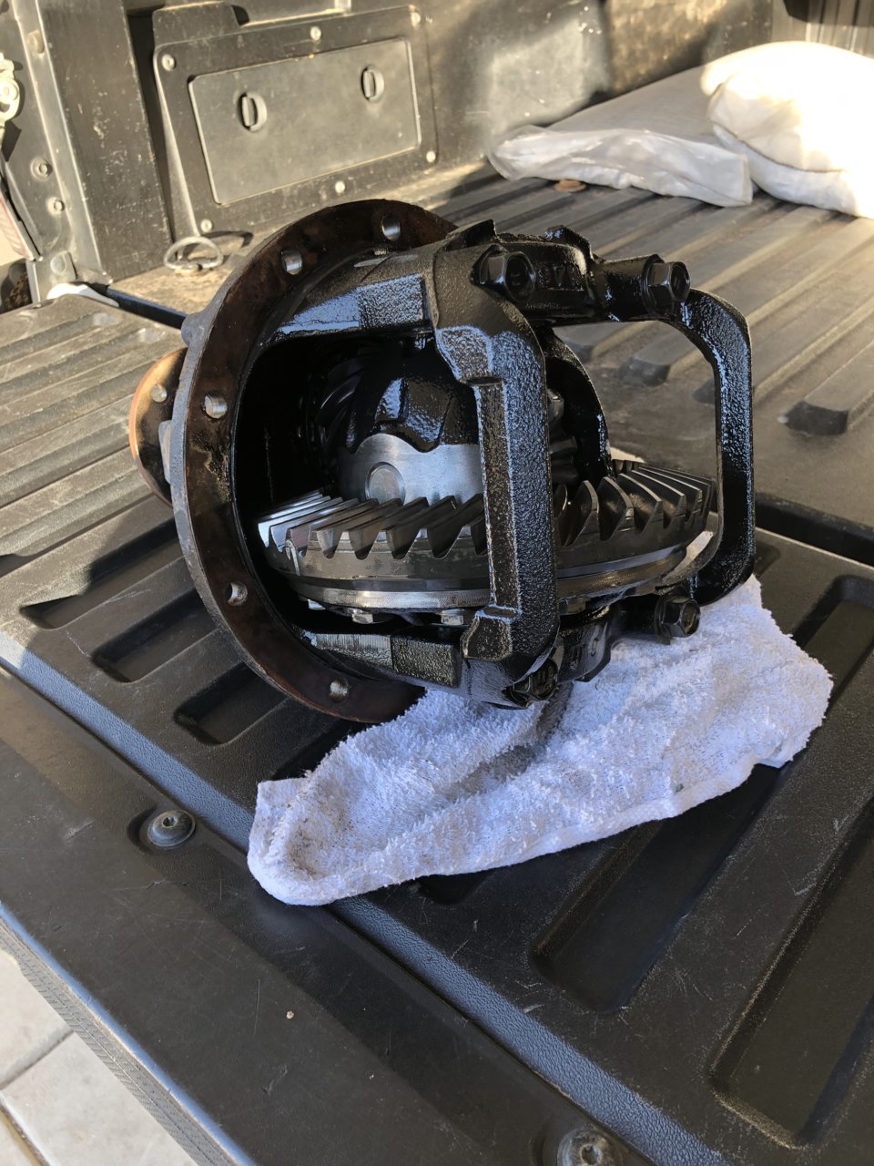

    After the lift/tires my truck was hurting with the stock gears, and fuel consumption was horrible. So I decided to re gear to 4.88’s. I ordered up some nitro gears and started that adventure.
    Pulled the rear diff

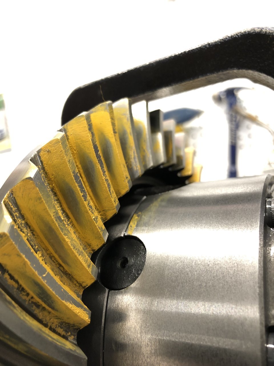

    This was one of my pattern checks
    I put in the solid spacer instead of using the crush sleeve (definitely my preferred method) and I also put in a Yukon LSD since it’s mostly my DD and didn’t want to put in a locker.

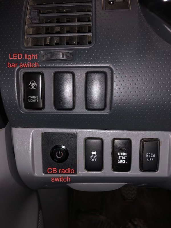

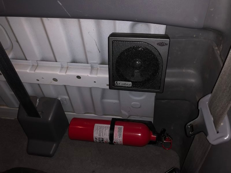

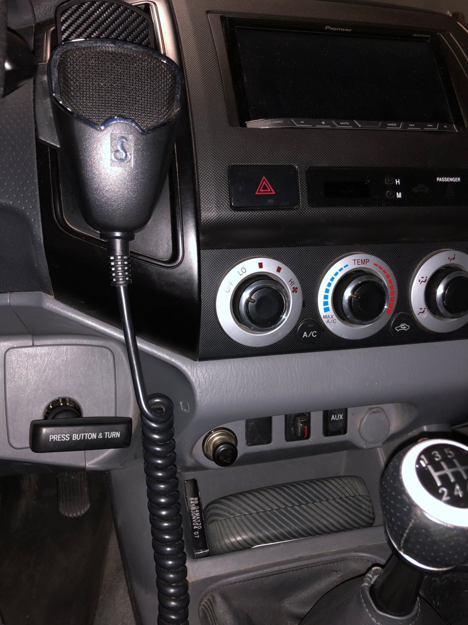

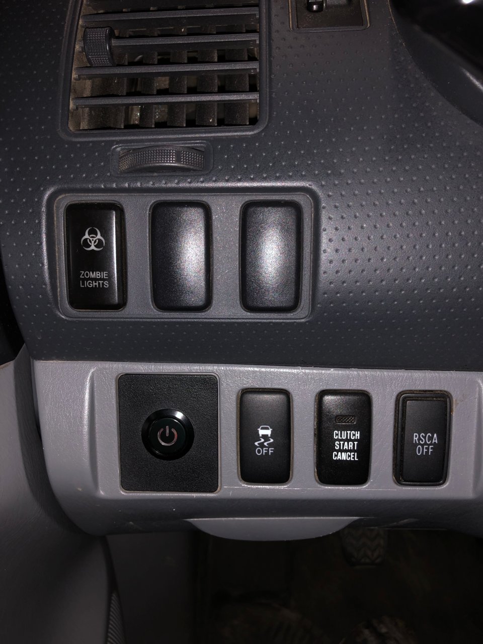

    Here are some pics of my CB radio install.

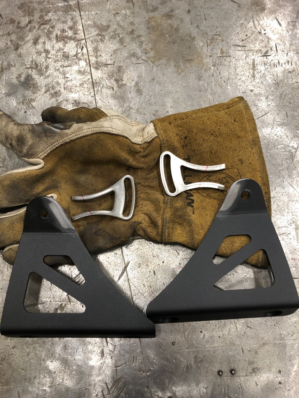

    I have to modify the Cali Raised brackets for the Baja Designs light bar so I cut the BD brackets and I’ll be welding those to the CR brackets tomorrow night after I take some measurements on the light bar.

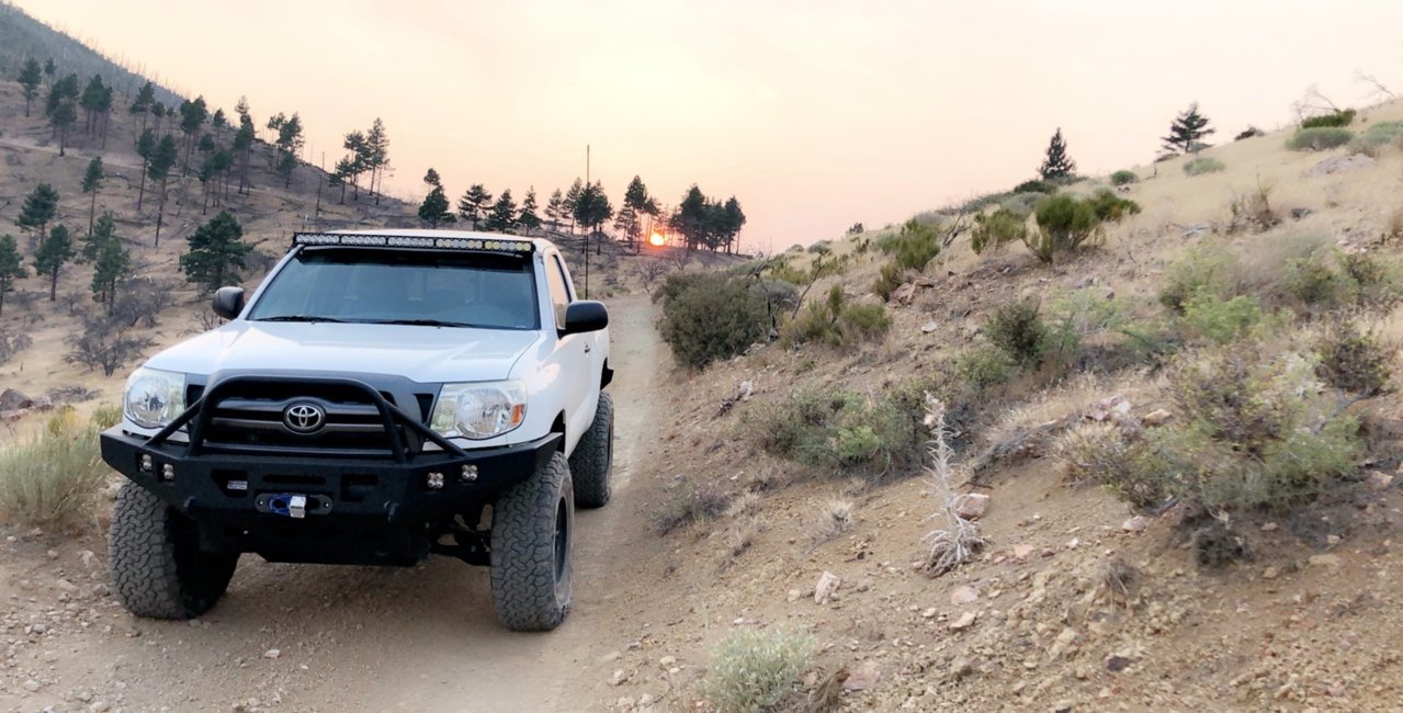

    Haven't had time to update this thread in a while. I put on my relentless front and rear bumpers, Warn winch, and Baja lights. Hopefully I'll be able to weld at home soon and then I'll do the cab mounts and sliders.
