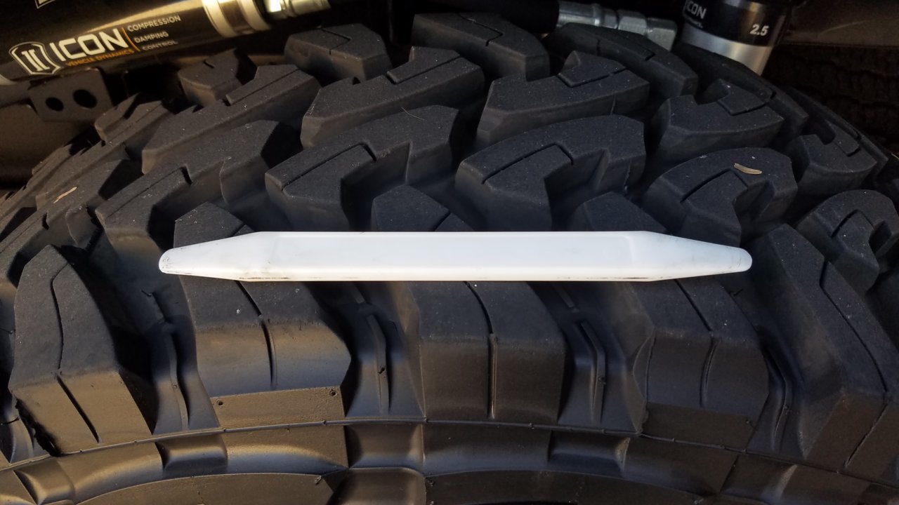

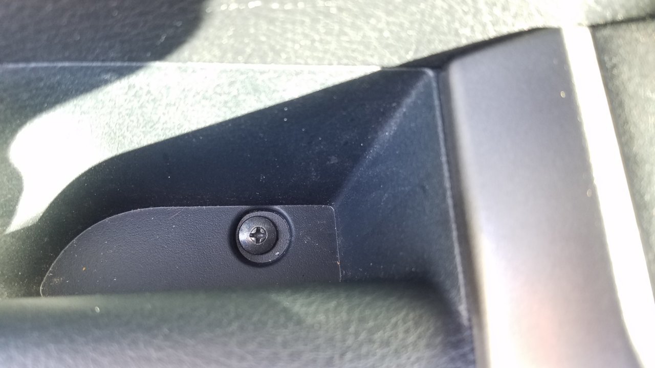

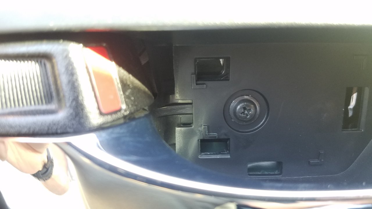

    Here's the tool.

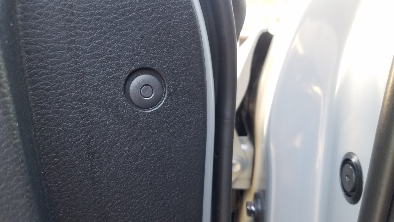

    Here's the screw behind the door handle.
    Here's the screw under the other door handle carpet.
    You'll also need to take this clip out. Just push the middle part in a little and it should pull out. Also remove the little piece above this. Super easy too, just gently pull it off.
    Then just give it a bit of a yank! I started bottom front by the speaker and then yanked it all the way around.
    There's a video here.
    https://m.youtube.com/watch?v=w8Quqpto81c

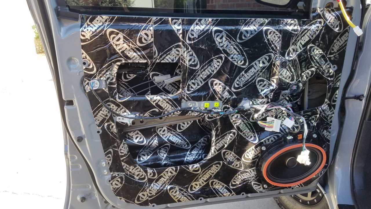

    How much dynomat does each door take? Did you do anything else or just the doors? One last question if you only did the doors did it make that much of a difference? My wife doesn't care for the exhaust note so much.
