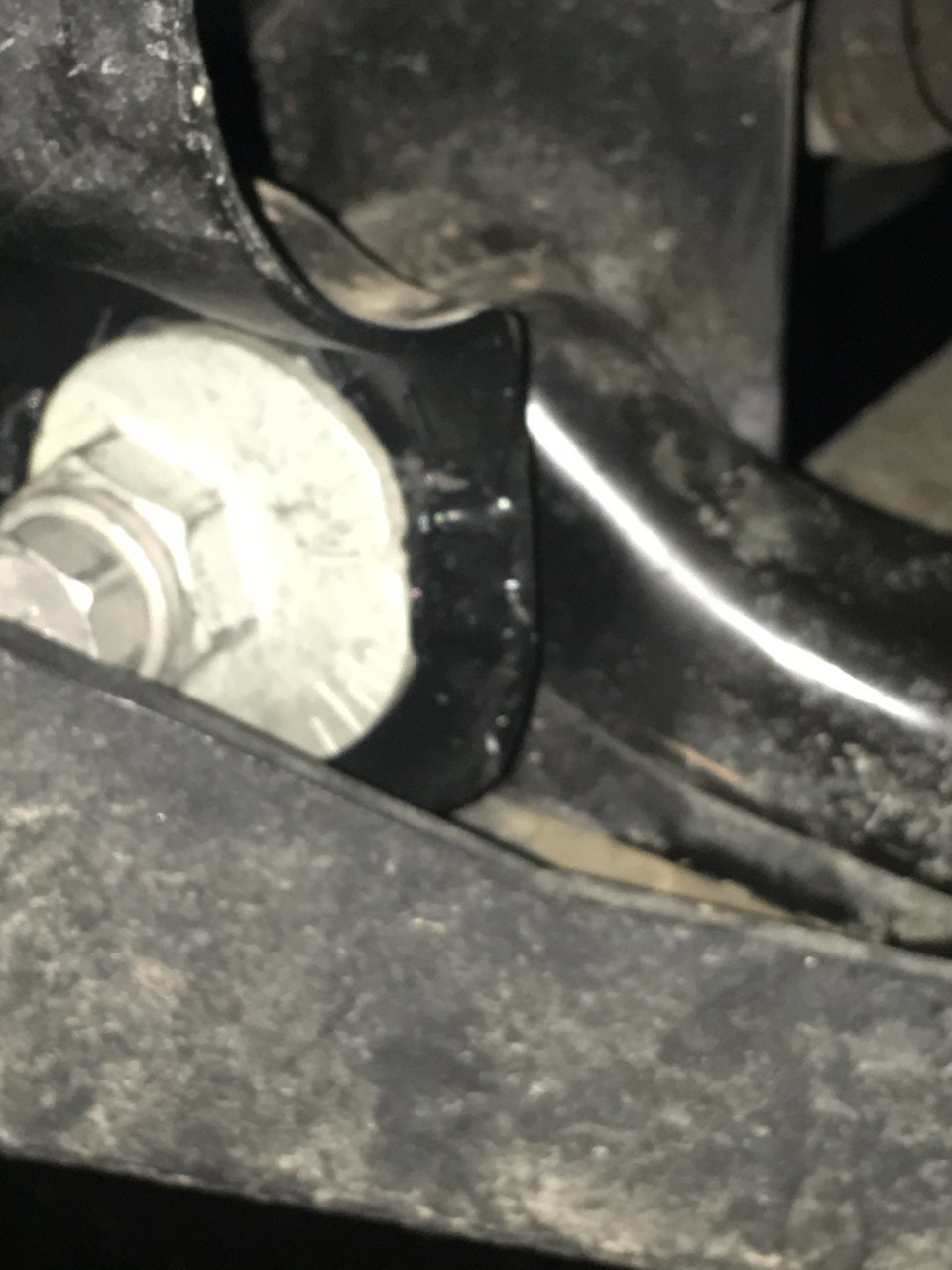

    Nah, I didn’t get any pics of the damage. Took a couple after pics. The dealership actually did something good on the repair though. They ran a couple beads along the tabs to reinforce them. I just wish they would’ve done the passenger side as well.
    74B124F5-8CF5-48EC-9710-F97F2851D571.jpg 3F4DA70D-F93E-4BCC-831B-9A357388C588.jpg

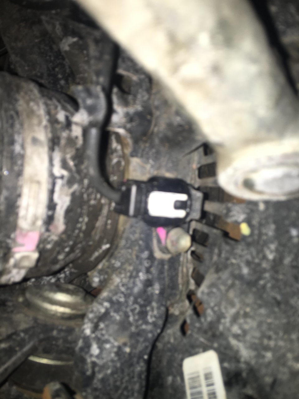

    I was told that I damaged the pins on the sensor, but not by a frontal assault, it was caused by my tire droop. I asked if I could get a longer harness, they said no. I asked for recommendations and they said lower the lift - LOL!
    The shitty part was that I couldn’t get my rear e-locker to engage. Also, had trouble getting the truck into 4lo. Crawl Control was non existent. All kinds of errors on the HUD. Have you ever heard of anything like that?
