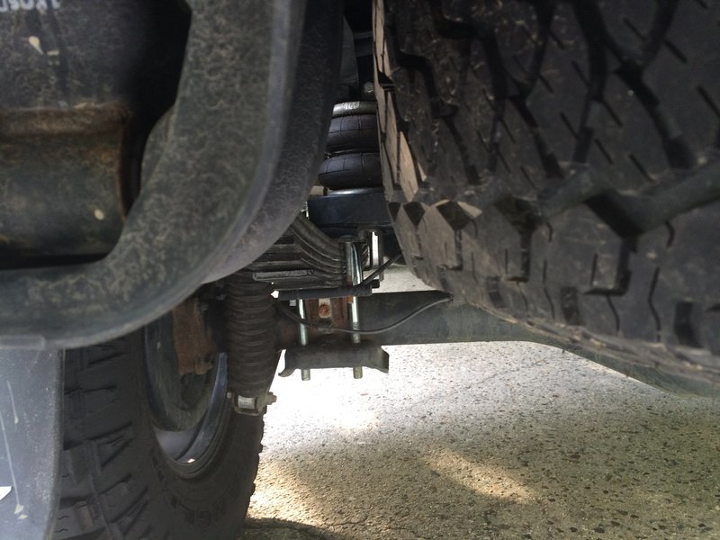

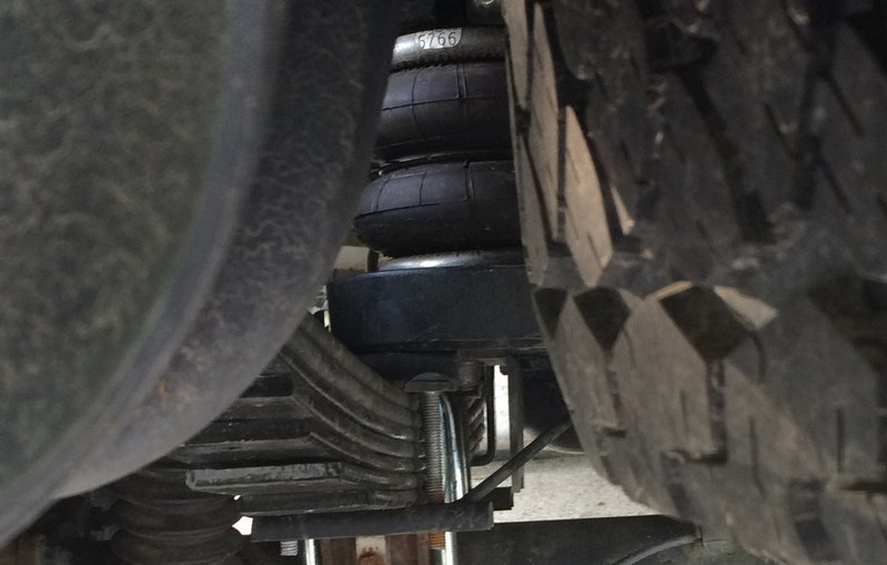

    Been awhile since i've been on here. Install went great. Got about 2 1/2" of lift from the upgrade pack (not meant to be a lift pack per Hellwig). Replaced shocks with 5160 bilsteins and kept the firestone ride rites. Ride is a bit stiff with empty bed but rides great when towing or with a little bit of weight. Noticeable difference with 1-200lbs vs empty on ride quality. I have the readylift front level spacer from their SST kit up front with these in the back and its right at a 2 3/4"" rake, a bit much but i've learned to like it. Almost Levels out with normal trailer load (roughly 5-600lb tongue weight. I've squatted it below level with full trailer load but thats why i kept the ride rites. When not towing, I just remove valve stem, compress bag, re-tighten stem and they stay nice and tucked out of the way. Leafs are stiff enough not worried about bottoming out.
    Future possibility: may remove the shortest leaf to reduce rake.
    If it doesn't level out with what you're planning to do, highly recommend the ride rites. Never had any complaints about them. Also, have daystar cups for what little offroading I do to prevent bag stretching.
