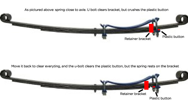

    So I have 4 leafs/leaves. I'm thinking my truck may have the TSB since I don't have 3, not sure though. Toyota doesn't show history of the TSB being performed on my truck btw. Did some tacoma's roll fresh out of the oven with 4 and some 3?
    Question is... why do I have two retainer brackets on each side? You see the image below, 1 ret bracket and one plastic button, I have two of each front and back. Just not sure If ill be able to squeeze these things in without rubbing on one of the many brackets, buttons etc. I have going on.

    Maybe the previous owner installed an add a leaf?

    They'll work, you just have to play with positioning them. I had some on my reg cab but ditched them after scoring a 4 leaf oem pack. They did make a bit of difference but not much that I could really tell.

    I didn't get more than 1/4" if that much and that is on reg cab. Wouldn't expect any lift from them, only reinforcement & a bit of axle wrap help.
