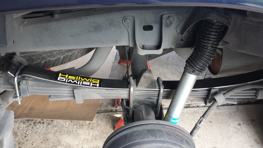

    I just installed the 981 on my 2012. If you see below...the 979 is for 05-11. The 981 fits all 05-15.
    The 2012-2015 have one shackle near the gas take that mounts sideways, and the 05-11 does not require this, but can be mounted this way.
    I am pretty happy with mine so far...just trying to adjust to find the sweet spot.
    I had them tighten down a lot when I first installed, and the rear end was noticeably stiffer. I drove over my usual Rail Road tracks that always make me hit my bump stops...and they did not hit. It raised the rear about 1"
    So I loosened them up and rear was back to "stock feel" (and height), but now I hit the bump stops on the RR tracks. So I am still tightening a little each day, trying to find the spot where it isn't stiff and I don't hit my bump stops. But even the Stiffness isn't that bad...I am just picky.
    Overall very happy with them...just waiting to carry something heavy...but nothing planned in the immediate future.
