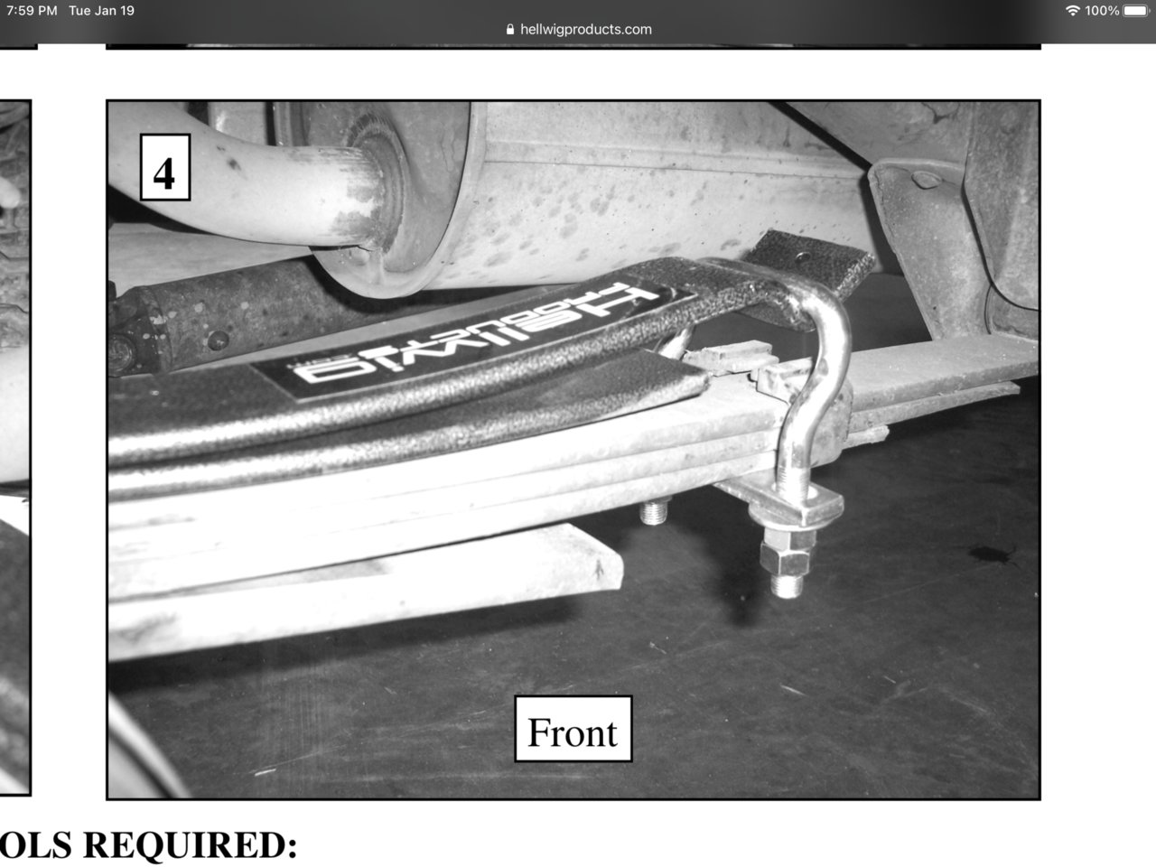

    I had ordered the Hellwig for my 2015 and then canceled my order because I found out that the steel band on my leaf spring would interfere with proper placement. It was recommended that I cut it off, and I didn’t want to do that. It may be different for your leaf pack, just be aware.
    Someone also mentioned that they can send you a dog leg ubolt that with solve the problem. But I never looked into it.

  7. Jan 19, 2021 at 3:42 PM
    ejl923
    ejl923 Well-Known Member
    Oct 15, 2014
    #140378
    1,255
    Eric
    Western Mass
    15 DCSB TRD Off Road
    i emailed them once and they responded to order part 980 due to interference, just fyi. I might order them and just use for winter. i plow and keep a lot of sand in the back

  9. Jan 19, 2021 at 4:05 PM
    spitdog
    spitdog Well-Known Member
    Sep 2, 2014
    #137440
    3,992
    2015 Access Cab V6 4x4 SR5 MGM
    Thanks, I will save that info for sure
  10. Jan 19, 2021 at 5:02 PM
    spitdog
    Sep 2, 2014
    #137440
    3,992
    This is the dog leg ubolt some would need.
