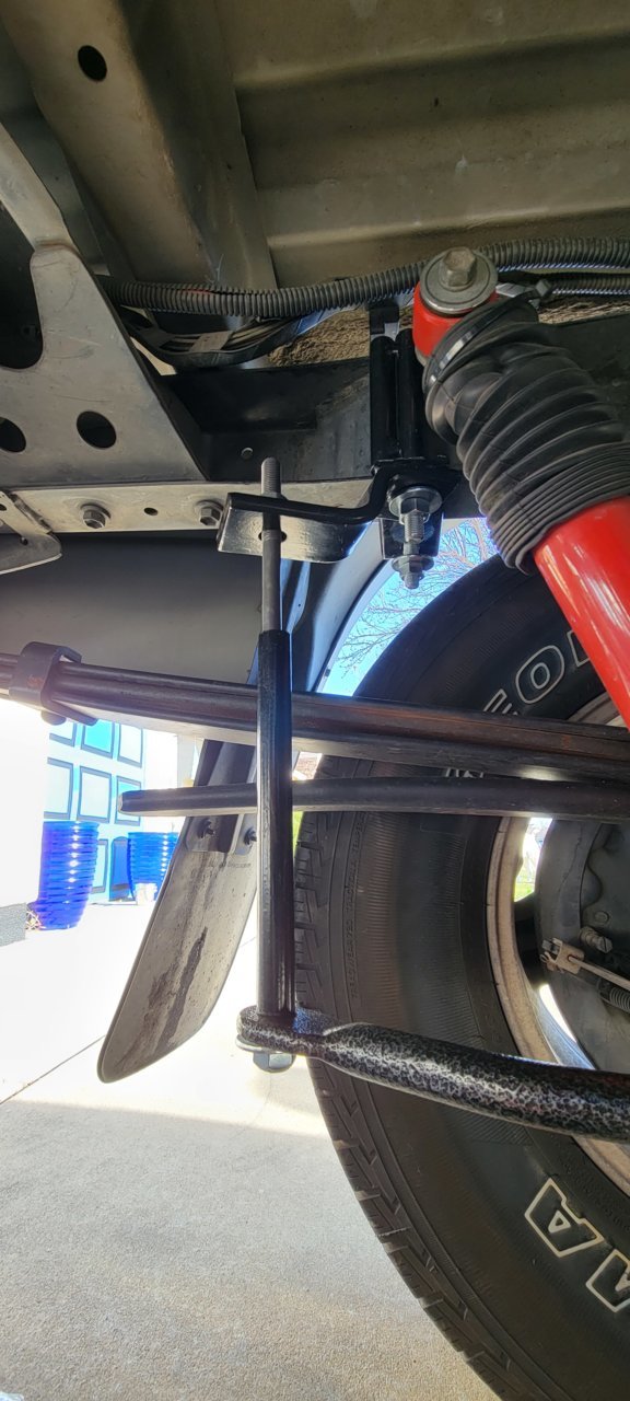

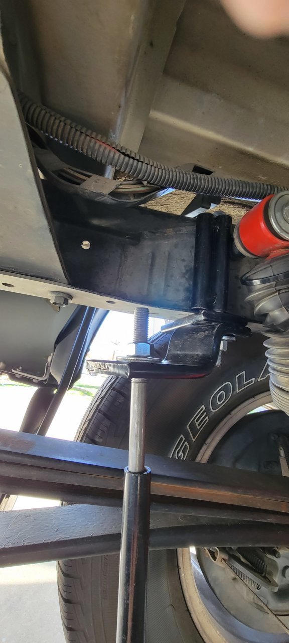

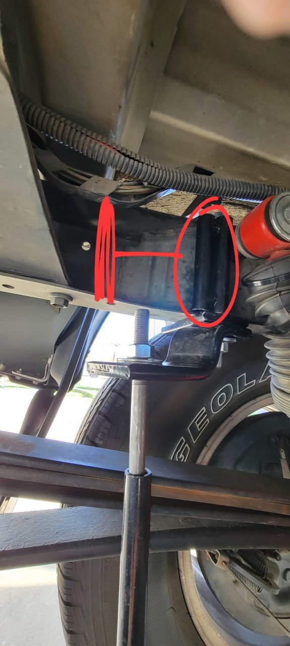

    Pictures of the driver side mount temp installed, nothing is tight.
    Safety inspector checking things out.
    The double pipe part that is supposed to fit inside the frame doesn't. I can shorten it and mess around, but if someone has a mount already created...
    For clarity I do have a 6 lug Tacoma.

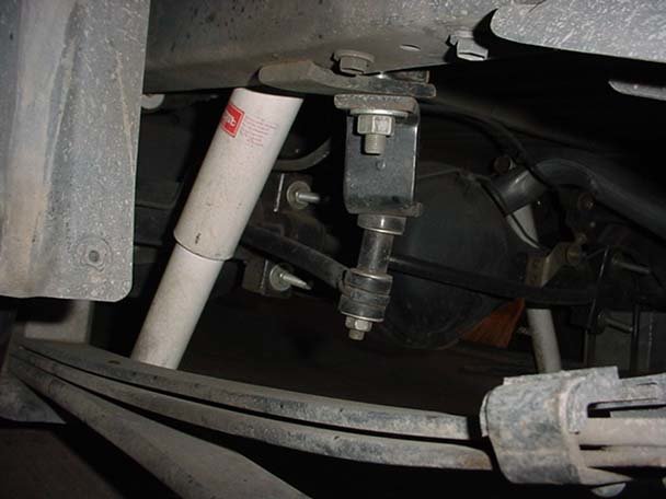

    Good statement regarding aftermarket sway bar that use ubolt, that is cheesy.

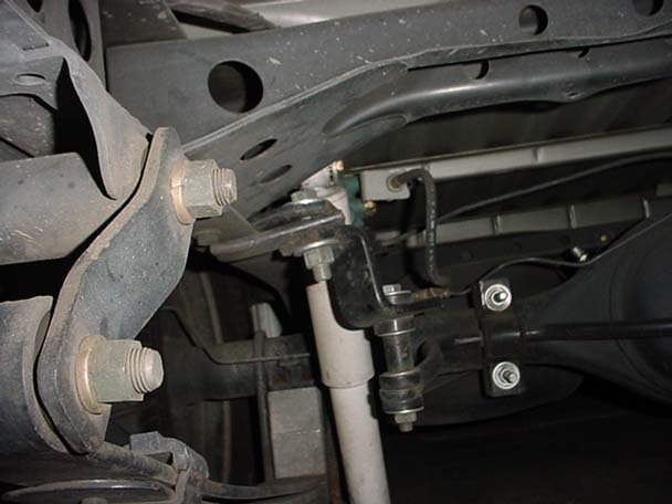

    Can't you relocate the frame ubolt closer to the spare tire xmember and rotate the upper 90° plate to face the opposite direction?

    Yes I can, but I'm was trying to find out what the StreetTaco mount looked like or what other people have done... kind like the picture you posted.

    I agree I think OP has the brackets backwards looking at the Hellwig pictures.
