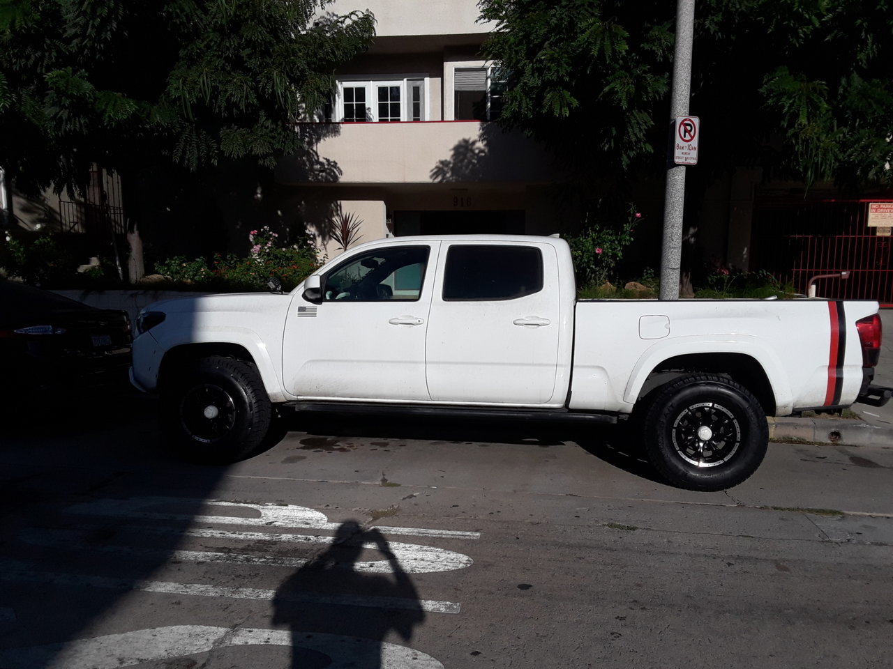

    I'm new to lifting trucks and have been searching and could not find the answer yet. My question is will these 17x9 Helo HE878 wheels (6x5.5 BP) (-12 mm) fit my stock prerunner with no lift. I plan on putting 265/70/17.image.jpg

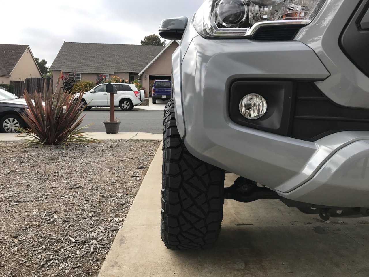

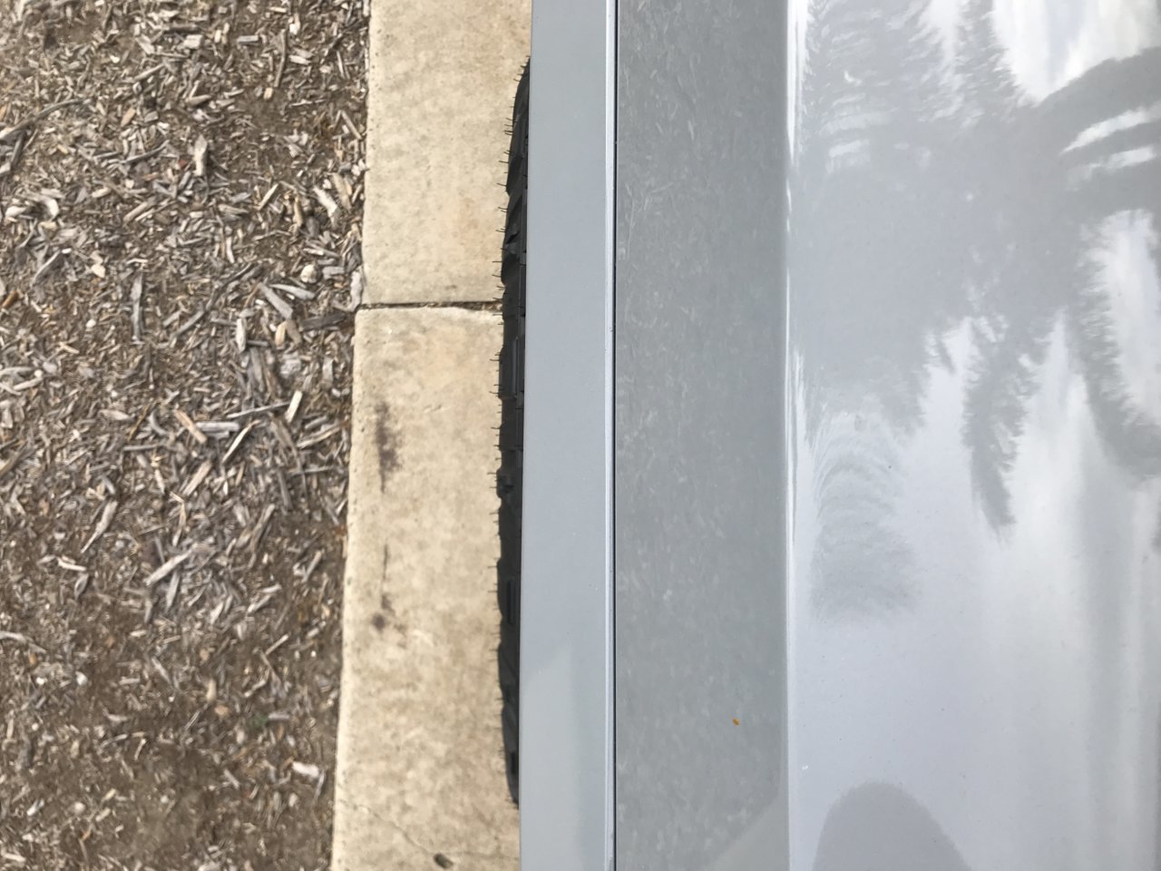

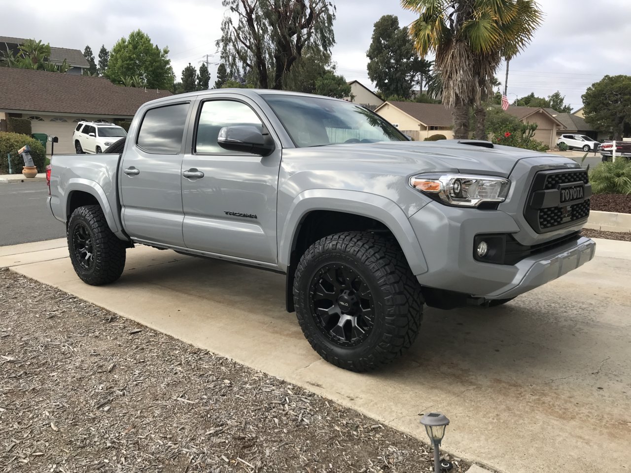

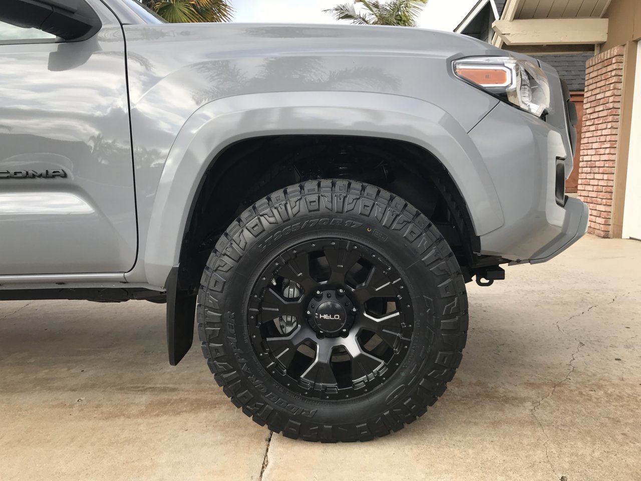

    A few years after the OP posted, but figured I'd share since I just had this setup installed tonight on a 2019 Tacoma TRD Sport (not 4x4, no lift). Helo 878 wheels with specs of 17x9, -12mm offset. Nitto Ridge Grapplers 265/70r17 tires. There is some "poke" - enough to give it a great aggressive stance (combined with the Ridge Grapplers!) - but not so much that it looks out of place. I am getting some rubbing on the front mud flaps — will have to modify, replace with aftermarket, or remove altogether. Other than that, this setup looks and drives great!
