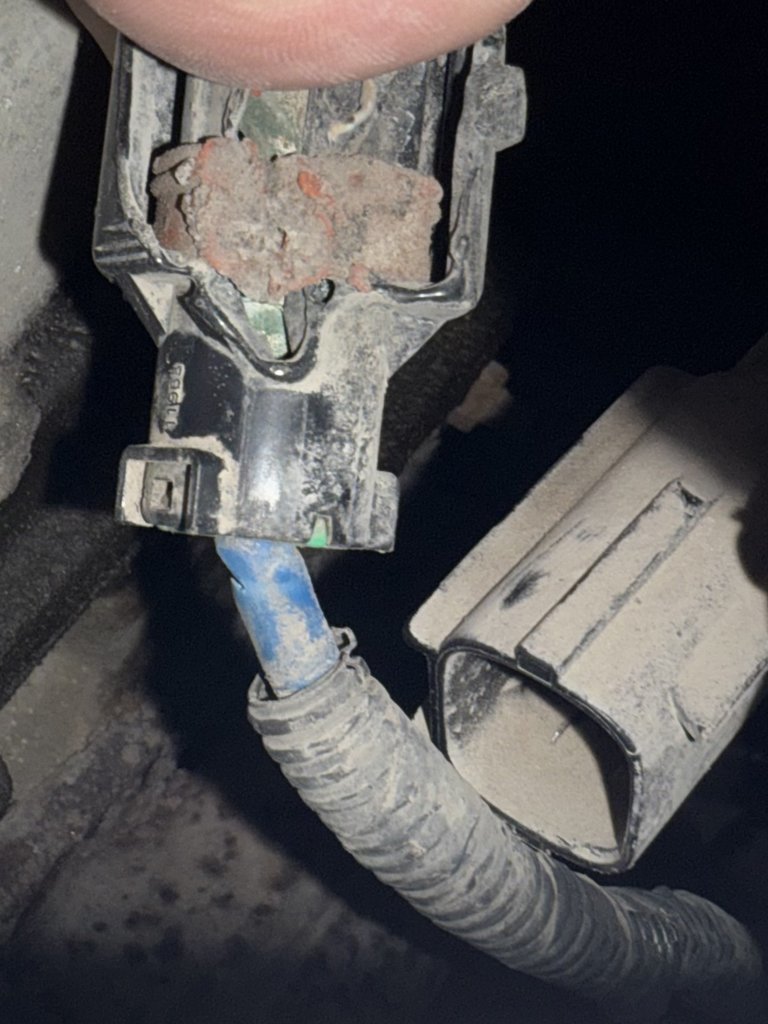

    I tried searching Google and several forums to try and get an idea of what this damaged plug is on the passenger side of the engine bay. Anyone know what it is and where it should be plugged in (2007)? Is it supposed to go in the plug in the second picture? CheersIMG_9190.jpg IMG_9191.jpg

    What are the wire colors?

    Is there a chance it is for an accessory your truck doesn’t have? Or possibly a test plug? I feel like I’ve found a few under the hood over the years…

    Maybe. That would explain why I haven’t noticed anything

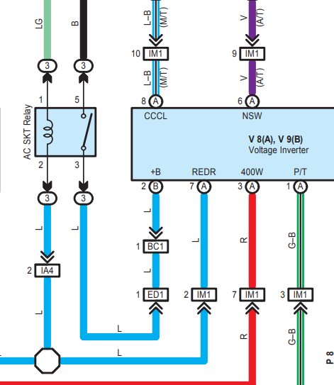

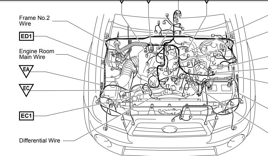

    Pretty sure that's Connector ED1, it's the main power going from the AC SKT Relay to the Inverter for the bed power outlet.
    Not sure how it would have gotten unplugged.

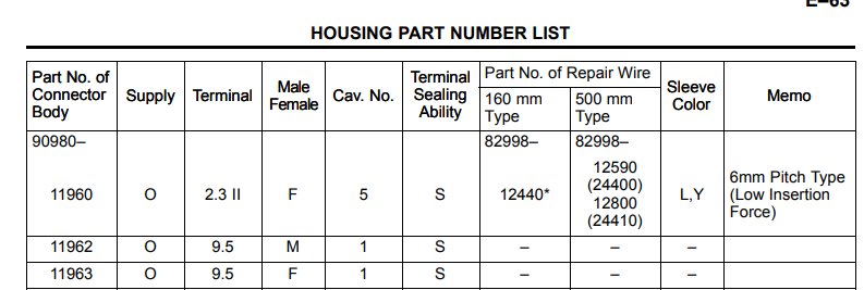

    It doesn't show the part numbers for the terminals but the numbers it shows for the body halves are 90980-11963 & 90980-11962
    I can maybe dig around some more tonight and see what I can come up with.

    Toyota doesn't seem to list a part number for repair terminals for those connectors. @caribe makaira

    repair pigtails only...

    Thanks guys. I called the stealership and was told if I wanted to fix I could purchase the housing and would have to wire them individually to the connector.
