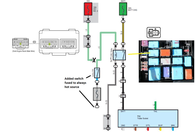

    Well I suppose you could run a wire from something that is always hot such as the 10 amp Horn Fuse under the hood panel or the 20 amp door lock fuse inside the dash behind the coin pocket left of the steering wheel.

    Find the junction box No. 1 at the left kick panel. There 2 connectors. One has 16 wires to it the other 18. Looking at it straight on is the right hand connector (18 wires). Counting from left to right the middle wire (#5) on bottom row.(Lime Green). That's your 30 Amp Battery Charging Relay pin 2 (86) IGN. Cut with enough to crimp a wire towards the connector. That would go to your added/needed switch to activate the relay with key off. Cap/insulate the other side off cut wire since it ties into the 10 amp IGN No.2 fuse. Find your preferred hot source in cab for juice to the added switch. Fuse the added circuit. Use the battery charging pin #2 on your 7 pin trailer connector for your added lamps.
