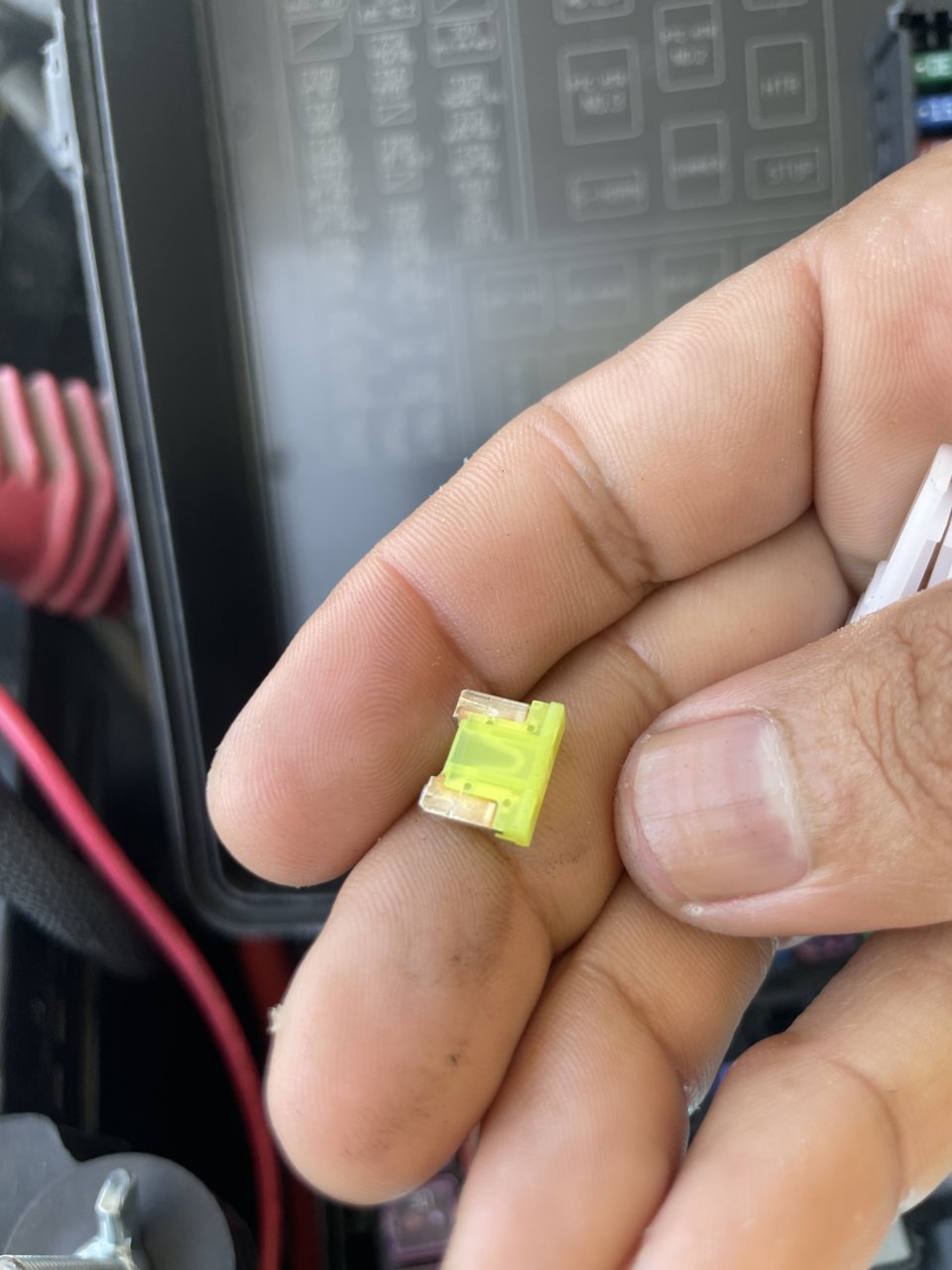

    A few days ago I drove to work bumping music and when I left my oem deck didn’t turn on.
    I checked fuses under hood and dash and they are all fine, does the oem radio have a fuse like the aftermarket ones? Since the deck is out it doesn’t show anything on the cluster and USB port not charging since all of that is together.

    I did check the (radio 1) 20 and (radio 2&3) 30 fuses but they look good. i unplugged the battery for about 30 mins and still nothing.

    Double check them with a DVM
