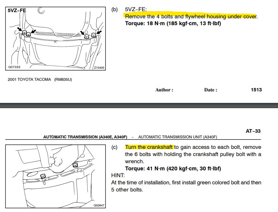

    @bigizzy, pull the inspection plate and see if you can confirm any cracking. If you end up pulling the transmission (not a difficult job, just time consuming) to replace the flexplate/rear main seal, be sure to start with the black bolt when mating the torque converter to the flexplate. A transmission jack is a must-have for this job. Also, second the OEM recommendation. :thumbsup:

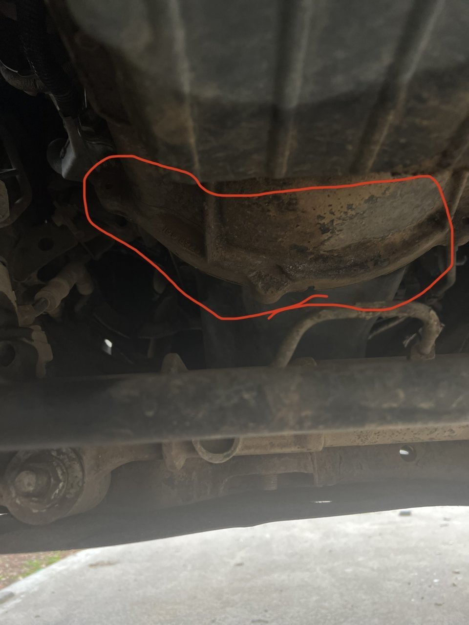

    Thank you Jacob and Mike!! I’ll definitely go look into these suggestions. You guys are awesome, I’ll let you know what I find out.

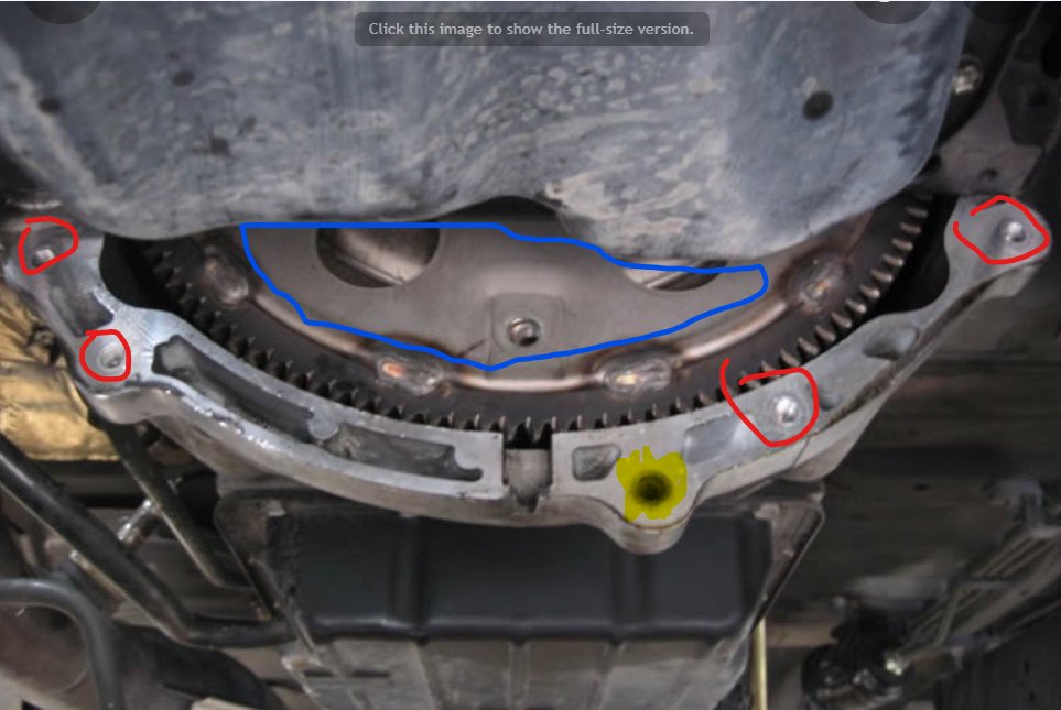

    If you aren't already familiar with it - Remove the inspection plate by removing 4 bolts holding it in place. For what you are doing, not necessary to remove the bolts securing the torque converter. Just slowly turn the crankshaft so the torque converter/flexplate turn so you can visually look for any cracks. If you don't see anything, it'll be time to make the decision whether to pull the transmission as cracking may not yet be visible in that inspection area.
    Red circles are the 4 bolts holding the plate/cover in place. The yellow area does not have a bolt.
    As you turn the crankshaft, you're looking in the blue circled area of the flex plate for any cracks. If you find any at all, its time to pull the transmission and replace the flexplate with an OEM plate.
    Good luck.
    (stole the pic from another thread thx charry323)
