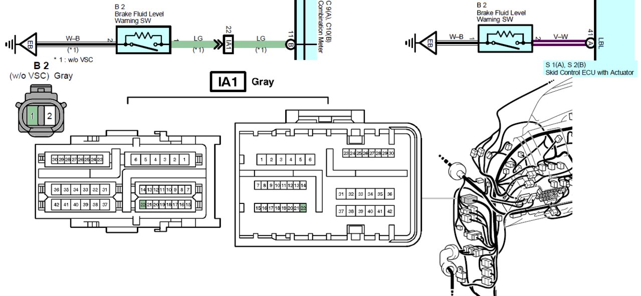

    Yes.
    pickup truck
    Find out what resistance the brake fluid reservoir uses to keep the light from coming on, hang that many Ohms on the exposed wires and just delete the sending unit...
    Edit, it's probably just opened/closed switch and you can just twist wires together.

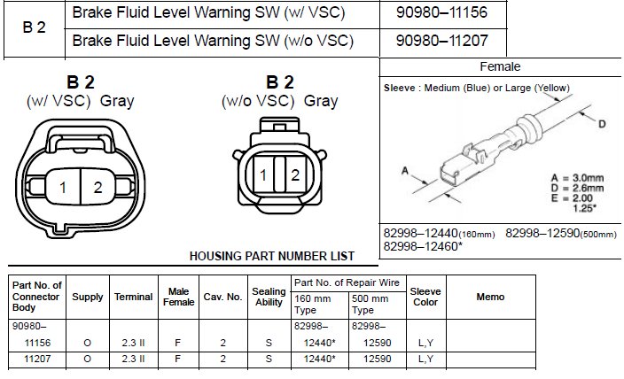

    Hold the presses. Looking at this^^^, it shows a completely different connector for without VSC. The OP's truck doesn't have VSC.
  15. Aug 15, 2019 at 9:07 PM
    #35
    6 gearT444E
    6 gearT444E Certified Electron Pusher
    Feb 3, 2018
    #243372
    7,798
    Deep South
    Herculiner Hootus
    This file right here. If he has VSC it is indeed a different part number. Looks like a regular master CYL to me so that P/N may not work for his application.
    OP - Remove the connector from the master CYL and snap a pic so we can see what the connector looks like
    Jimmyh and Muddinfun[QUOTED] like this.
