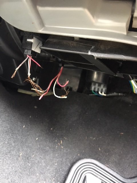

    I thought I lost my wallet last night so I was looking around and I think I found the problem (see attached photo)
    I have reviewed the wiring harness diagrams, but can't narrow it down, it is under the dash in the passenger foot well.IMG_6739.jpg

    I have the same box on my single cab. My factory service manual doesn't ever refer to it, and I really don't know what it is.

    Currently have no shift lock or Air conditioning, so it must be tied into IGN1.

    Pull out the shrink wrap and get to wiring

    I was able to splice everything back together and everything seemed to be working on my drive in to work. I wish I had found that before I spent $500 in diagnostic testing that got me no where...
