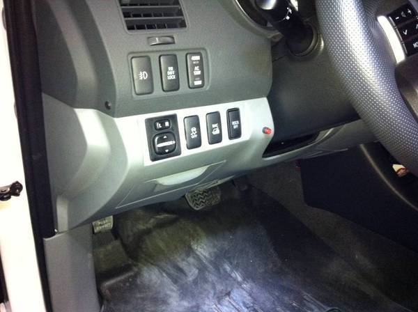

    X2 on this. Also pic of this red alarm button your hitting. Because I also think you mean the panic button.

    The mod shouldn't touch any ignition fuses, and after the mod. I could still turn on the inverter just fine. I'll check the fuses anyway. Here's a photo of the red button; it's not located on the key fob.
    This is what I was thinking, but can't figure out how to reset this protection feature. Only at the dealership? Or......
    I'll give this a try. This sounds like it could be the invincibility cheat code I am looking for.

    Oh ok, is that a factory alarm? Or dealer installed, or aftermarket.
