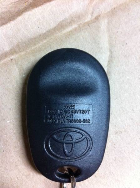

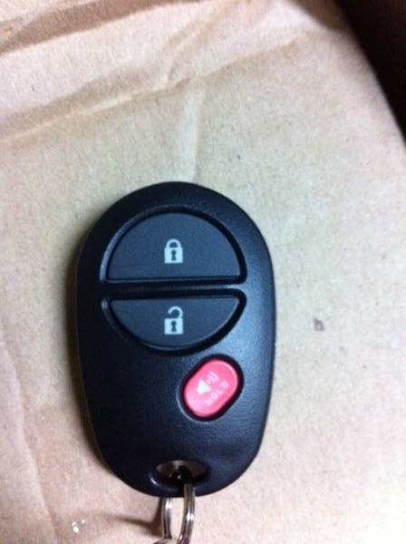

    The generic info you found looks to be the same instructions I have for my "Remote Keyless Entry Upgrade Security System", but just in a different print out. Here's the key fob I have.
    [​IMG][​IMG]
    Actually I hadn't tried that, but it didn't work :(
    I did it pretty fast, within a second. However, when you say push it three times, does that mean cycle the alarm 3 times (6 presses), or just press the button three times?
    I think I found the fuse for the security system, either that or just for the shock sensor. Any idea if pulling this, and replacing will help? or just hurt me more?

    It was a bypass for the starter kill. Like if I lost my key fob and still needed to start my car. I would hold the red button down push in the clutch and turn the key and my car would start. Not sure if its the same button but I had to have it pressed in while turning the key.

    You have a gst installed alarm upgrade the module should be up by the parking bake its a black box with a with label that has a 00012 number on it.
