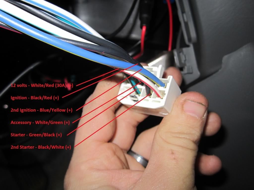

    4) Did you ever locate the ignition harness? This connector running down the steering column or in close proximity should contain all the constant 12 volts, ignition, accessory, and starter wires going to the key cyclinder. If you find this and can access it, probe the wires with a digital multimeter. Check the starter wire for 12 volts when turning the key all the way. Yes/No?
    Did you say the car would try to crank or not (no sound when turning to "start" position) Saw - no turn means the starter isn't getting juice (i know, duh). Either ignition is not supply voltage or the immbolizer is is still activated - which I and others mentioned earlier.

    Found this online- can't validate it for the 2013 but is most likely it - try checking these wires for their functionality
    See the 4 pin connector right below the fuses (heavy gauge wire - only populated with 3 wires) that appears to be part of the ignition harness if you can't get to the other harness. You could probe these with a digitl multimeter...

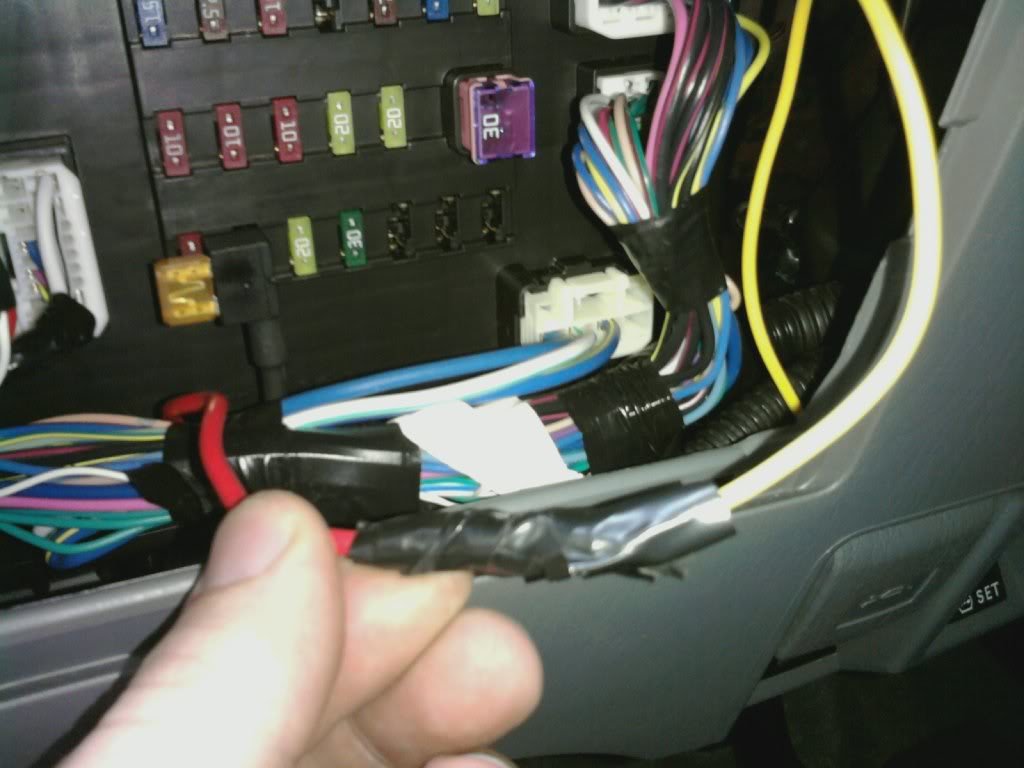

    Pic from the mod thread you posted
    242483_10101067064441194_9311444_8151656_be119b65f13801f45732e0ce508dc48138e6aa2a.jpg
