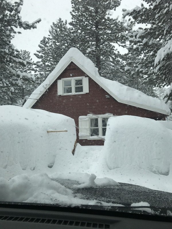

    Was it snow or packed ice?
    If you are on the bfg rugged trails I feel confident they are your problem. Apologies if anyone else is in love with those but I found them to be miserable in inclement weather. There is hardly any siping which is what you need for packed snow or ice.
    ATRAC will only engage in 4-low. I would certainly give that a try if this is a driveway or some place that is safe to stop but if it is a normal street on your commute I don't think I would bother. If you were in 2-hi you could press the traction control off switch which can help if you need some wheel slip but this doesn't sound like that.
    If you have to get up it, I would use 4-low, rear locker, no atrac, and plan on mashing the gas all the way up with wheel spin galore. I don't like electronic traction aids in snow other than the abs on ice. I think your tires are letting you down, not the truck.
    my driveway is my bona fides for commenting on snowy driving.
