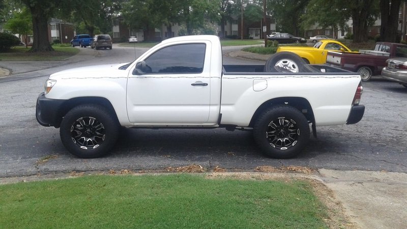

    Hey guys & gals! So, my boyfriend has a 2011 Tacoma 2WD. He's in basic training right now, so I wanted to surprise him when he got home. However, ran into some problems.

    So just go in and cut the black box out in that hump and put some new well liners on it? Do I need to go in and cover it up with anything to prevent junk from getting in that area?

    Yes. It is higher compared to stock.

    Hate to break it to you, but they did not lift that truck..

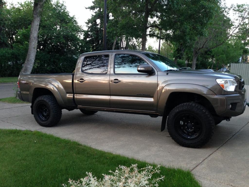

    This is my lift set at around 2" with 265's...

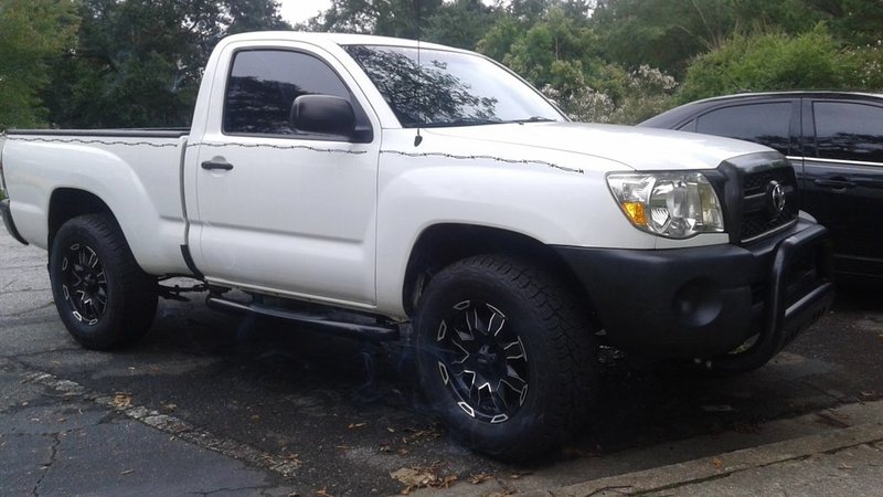

    It's is a -10 offset. They protrude some, but the only place it is scrubbing is where the black box and is. Other than that, it drives good. I put long bar steps on it yesterday. I will get yall a closer up to date pic when I get home. I'm sorry if I sound dumb when it comes to this stuff, but I try to do more research before I do anything.

    Just wanted to say thanks for everybody suggestions. I took off both black boxes this morning and no more scrubbing. Woohoo!
