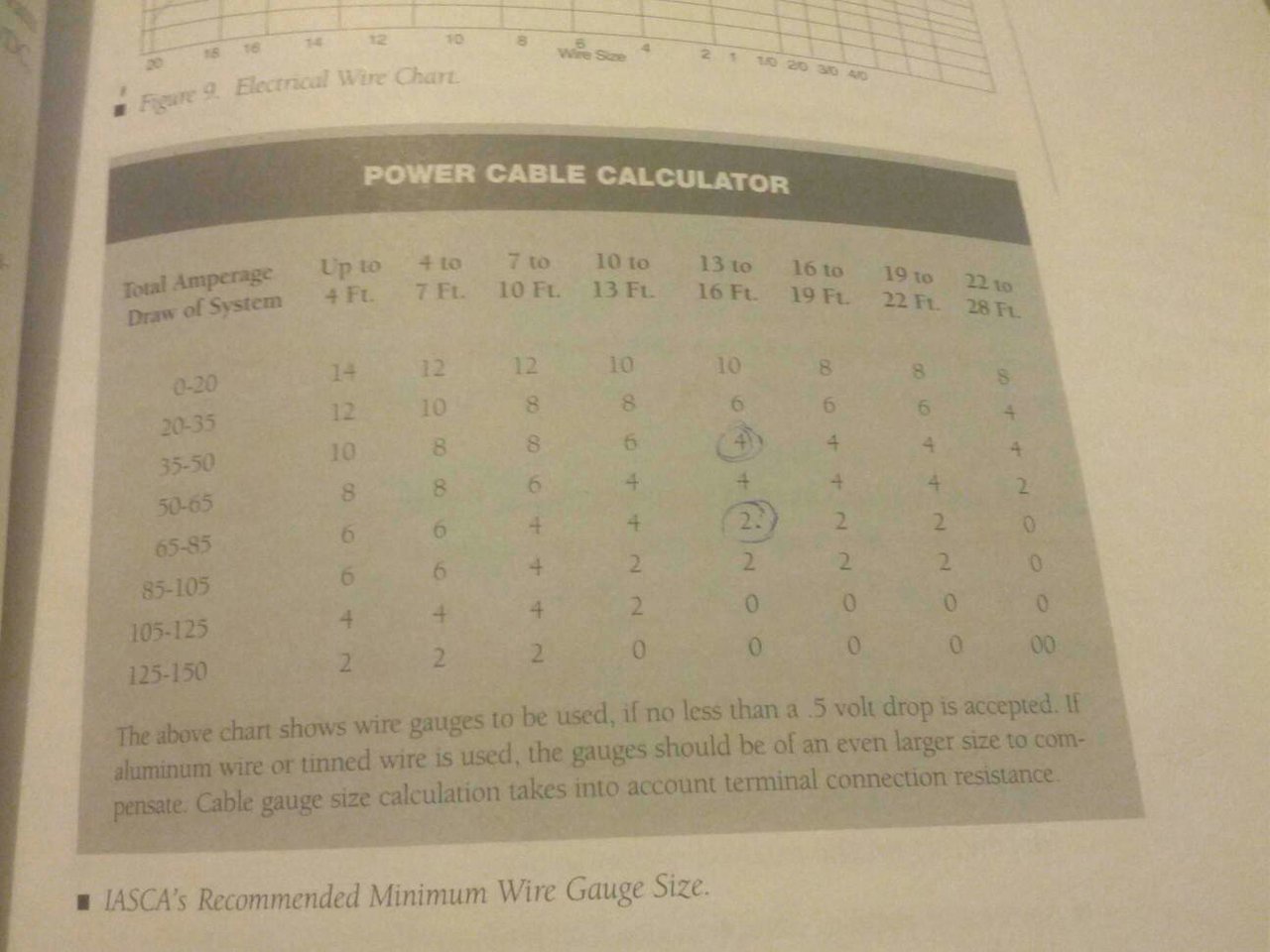

    Yeah, I told him 12 since he already had 12g wire to just use that. I think 10 is a little excessive, no? This is IASCA's Recommended Wire Gauge Size Chart as per the MECP Handbook:
    His lights are 55w each for a total of 165w running off a 12v system equals about 13.75 amps of current being drawn in total by the battery -> fuse -> relay wire. Assuming that wire is no more than 4' long, that would require only a 14g wire to run continuous current.
    The problem is that during initial start-up of HID ballasts, the amperage will spike to about 10amps per ballast on average, which would create a total draw of around 30amps on that wire for the first 3-5 seconds. Up to 35amps for 4' shows 12g wire is recommended. 10g is a very large wire, and I think he would only need 10g if his battery to relay wire was either longer than 4 feet, or if his ballasts draw more than 35amps, but since this is a 40amp max relay, that is unlikely, otherwise the relay would fail first. Also, OP said he used a 30amp fuse, so he cant be drawing more than 30 max, which keeps him in the said 12g wire recommendation.

    12 is okay for continuous, but like you mentioned earlier, the startup current can be much higher and it could be a problem, particularly with 55w ballasts.
    And I was thinking in the 7ft range.
