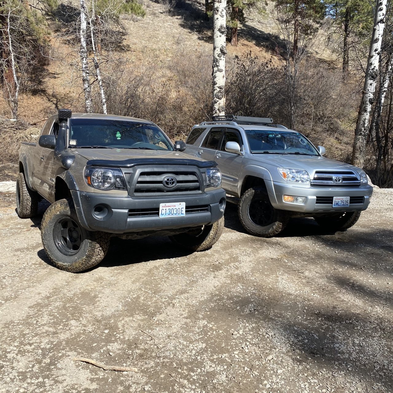

    So the 4Runner went in for the trans service today, they didn’t mention anything abnormal so I assume everything’s good there. We decided to try and go wheelin again on some novice trails because it’s my sister’s first 4wd. Temp held great the entire time, and we stopped to snap this pic... then I noticed something...
    (My Taco on left, sis’s 4Runner on right)
    ...the lower radiator hose has a small, and I mean small, pin-hole leak at the bottom. Doesn’t drip when the motors off, but when it’s on and the system pressurizes it drips maybe every 5-10 seconds?
    Next step is some new radiator hoses, (shoulda done them at the coolant flush/refill). Since we just did the flush, we plan on reusing and filtering the coolant back in afterwords because it’s fresh coolant.
