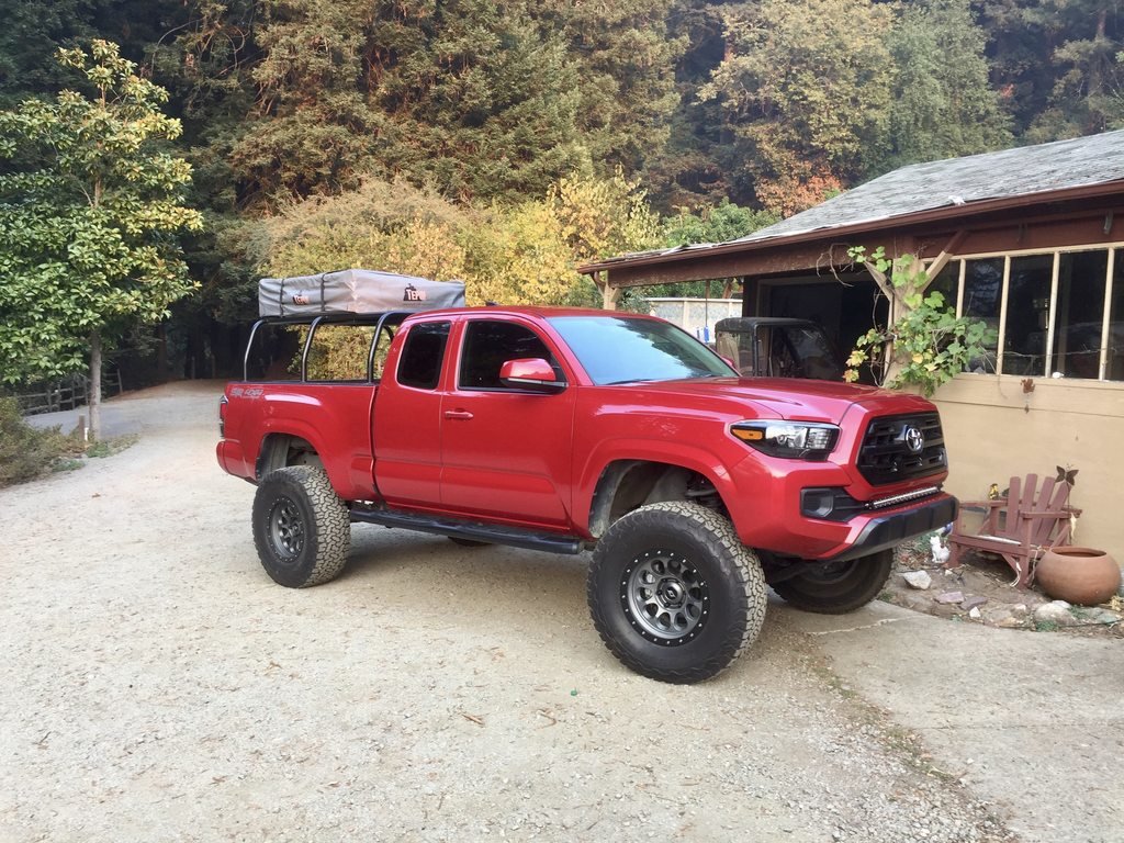

    Short and simple. I need more clearance....
    The 2.7l sr5 extended cab doesn’t come with a tow package so, to start, I added an oem bumper hitch and replaced the stock assembly bumper. Roughly added 62 lbs to the rear end. I added an SSO front plate with a winch. Added weight to the front is roughly 170 lbs.
    overall I want a 3 inch leveled lift all around. I attempted to keep all the add on as lightweight as I could for this purpose. Now trying to figure out a solid lift setup is the challenge. Any more skilled than I feel free to chime in
