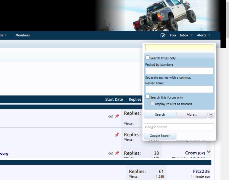

    First, thanks for at least having a clearly written thread.
    Because of the first statement I helped you out with this link:
    https://www.tacomaworld.com/forums/suspension.18/
    Second there is a search function because this question has been asked a few times previously.
