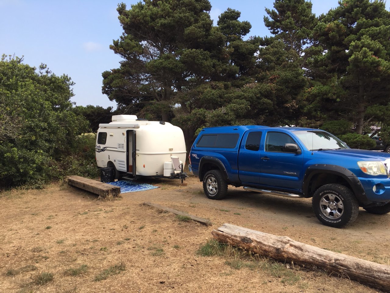

    IMG_1608.jpg I have been towing a 2006 17 ft Spirit Deluxe Casita travel trailer for 9 yrs now, with my 2006 Tacoma TRD Offroad access cab V6, automatic. Its done well over the yrs. I tow in 4th gear per the manual which keeps the transmission temps cooler, and keeps you from blowing up your overdrive gears, and I use the gears also, downshifting, when going downhill as well if needed on curvy roads. A 3rd gen will not help with towing, your 2nd gen is geared much better than the 3rd gen allowing more use of powerband. Personally I will be going to a Tundra TRD Pro soon, since I tow quite a bit per yr, there are less mfgr issues with the Tundra as well, than the Tacoma. Mpg is the bad part of owning a Tundra, your payload of the truck is better at 1630 lbs with Tundra, Most Tacomas are around 1200 lbs payload, which is not much when your headed camping. No wiggle room for extra passengers, etc with the Tacoma where with the Tundra its no problem carrying extra two passengers and not exceeding max payload.
