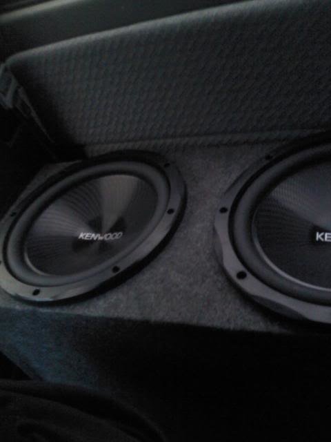

    I fit two 12's in the back for under 300 bucks

    Could you give me some more details? What kind of subs and box? Is the passenger seat still open?

    Two kenwood subs in a sealed box bought from a speaker store installed by myself only took an hour sit behind passenger seat still have one seat behind the drivers seat.nanything else man?

    That looks awesome. Thanks! Thats pretty much exactly what I want to do.

    I can send you more pictures tomorrow evening if you would like fair warning these might cause hearing loss... I'm running them on a 3500w amp :cool:
