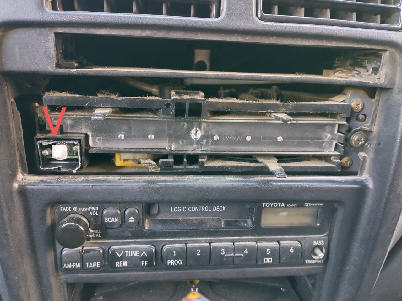

    Hi all,
    My AC switch failed a while back and I tried to replace it by matching the Bosch part number on eBay. While it fit it doesn't work and now it won't come out. I've got an OEM one to install and would love any tips. The plastic is broken from using needle nose pliers to grab it and pull but I think there are a couple tabs that I'm not seeing in the back. The red V for clarity...

    I see four screws that are holding the unit in place, correct? Three on the right and one that's recessed on the left behind the red V. It should just be friction holding the switch in there, yeah?

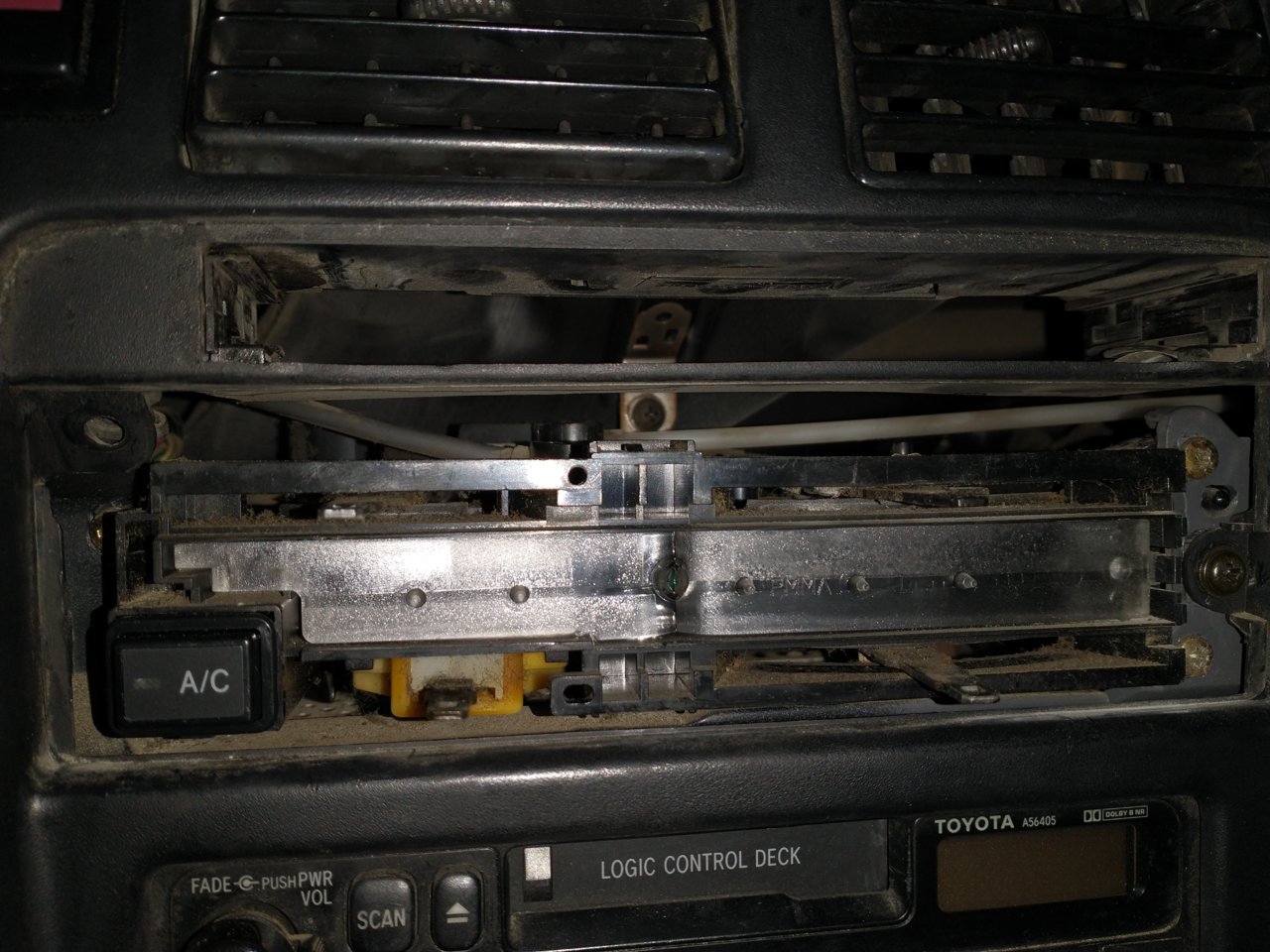

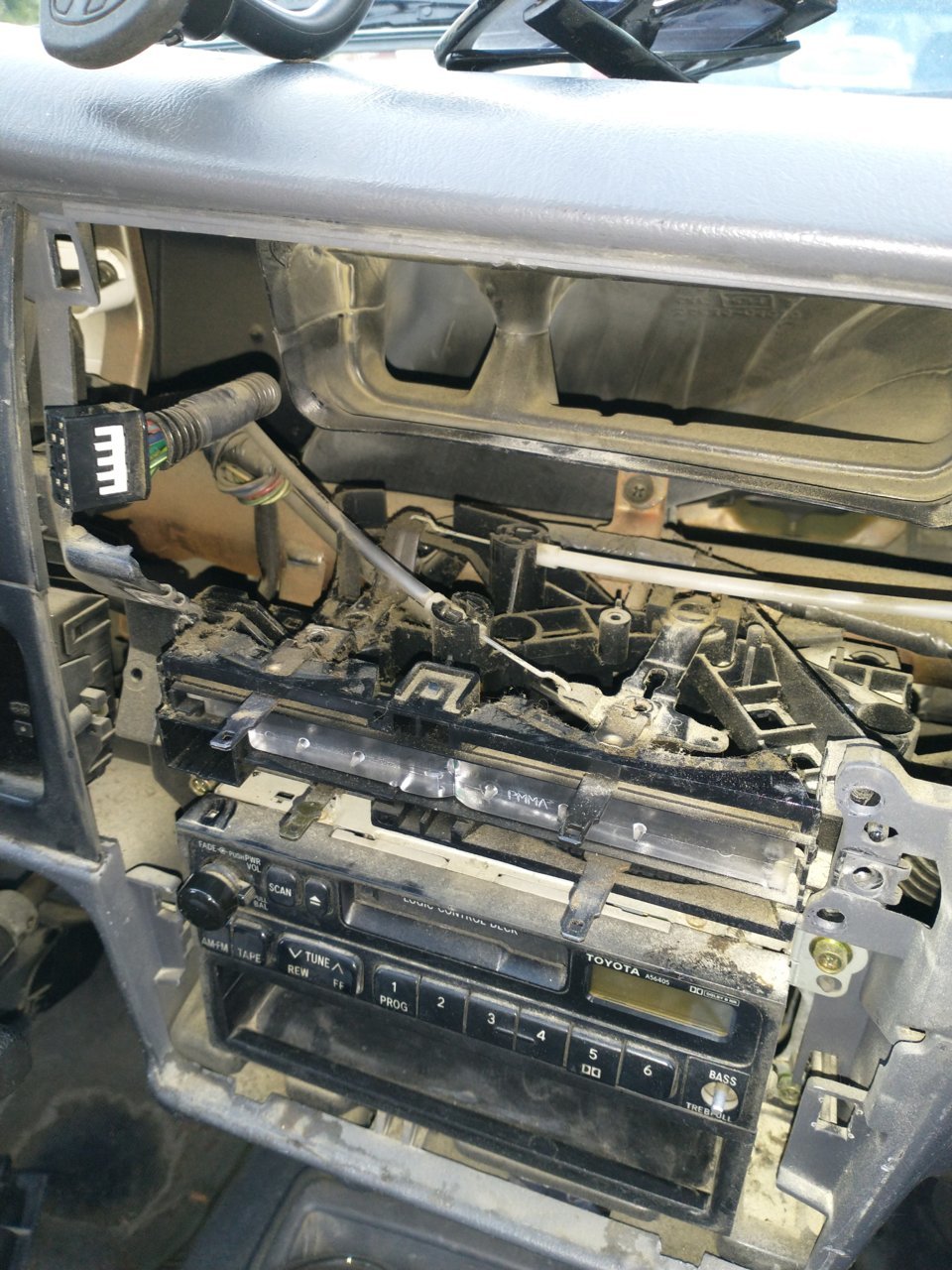

    Success! At least getting to the back side of the switch housing. Yeah, it's dirty in there... Ten years of burning man playa dust and 414k miles of everything else.
    There is a tab on top in the back that keeps the wires in the socket in place and pressing that helped loosen the switch.
    Now to out it back together and see if the switch actually works. That left hand recessed screw was tricky to remove without it falling behind the panels.

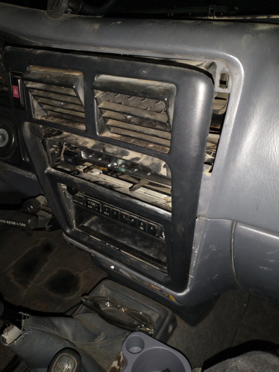

    I am now an expert in removing and reassembling the center console because you can do it right the first time or you can do it right the second. Or in my case, third.
    I had the two screws that held in the ash tray bracket and only one screw (I'm missing one in the left facing down) on the center console. The console has tabs on the bottom and clips everywhere else so pressing down on the vent cutouts and pulling out did the trick. See one of the pics where it's leaning away from the console. The emergency flasher button is still attached when you remove it so don't pull it away until you unclip that plug.

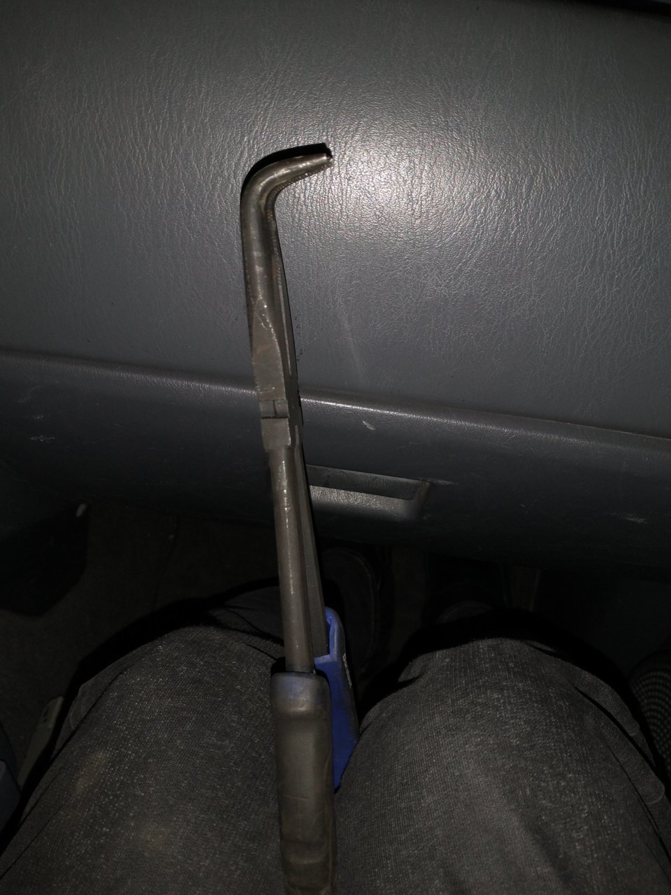

    While I was in there my bulb behind the temp controls was burnt out (thus the driving to get a new one). It's a 12v 1.2w tiny bulb that will glow amber if you don't reuse the green tint "condom" from the previous one. A 90 degree needle nose plier set really helped getting the bulb out of the housing.
