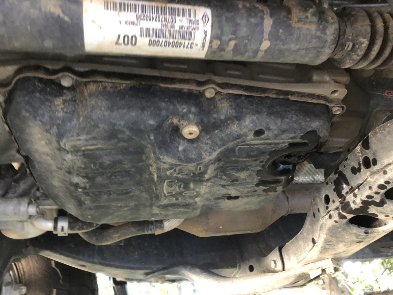

    Went to go do my oil change on 17’ TRD OR AC AUTOMATIC ( have done several with no issues) and I must have gotten distracted because I accidentally took off the drain plug for the transmission pan ( I believe). Will post pic.
    I first got suspicious when only 3 qrts. drained out and then I noticed the position of the plug ( on the pan under the trans) and the fluid was clearly red atf not oil after closer inspection. Super bummed at my goof on this one. Truck has 48 k on the clock and had no intent to mess with the trans system at all at this point into its life.

    Yup, tranny drain plug.

    Pan with drain plug location visible

    If you can know (measure) how much came out you can put the same amount back in. Get a new crush washer.

    Definitely don't drive the truck if the pan is empty. You'll risk damaging the pump and clutches.
    Try and find a ride to the store and pick up some ATF. If you want to be one and done, and do it properly, follow the lengthy procedure for fluid temp checking... if you just want to get the truck to the dealer ASAP so they can take care of it, then fill till it comes out the overflow, and drain out maybe 1/4-1/2 quart. Or have it towed, but that will probably cost more.
