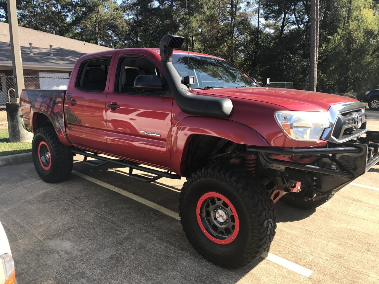

    On a brighter note it looks pretty good after the lift.

    Color match those beadlock rings

    Looks stout:curls:
