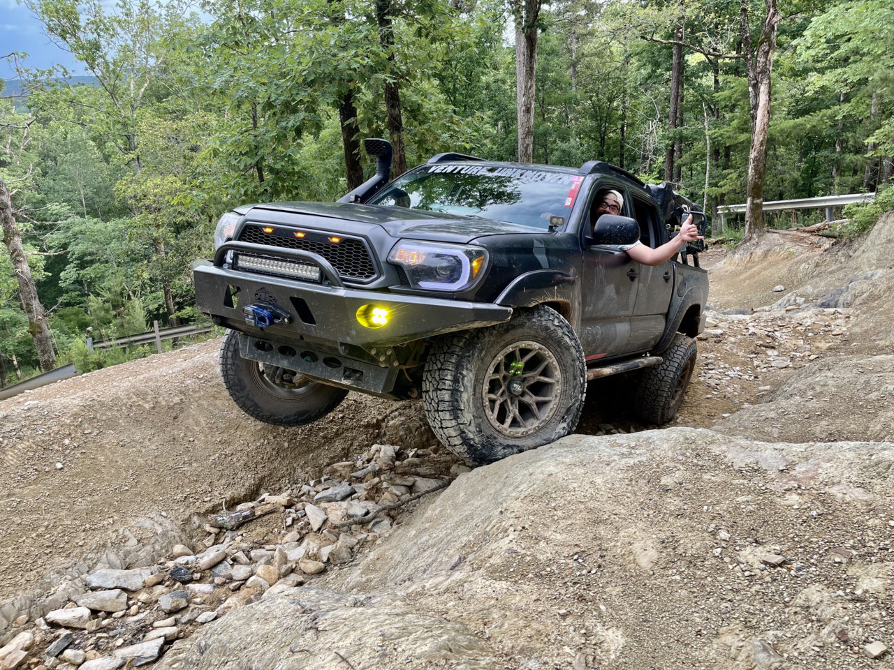

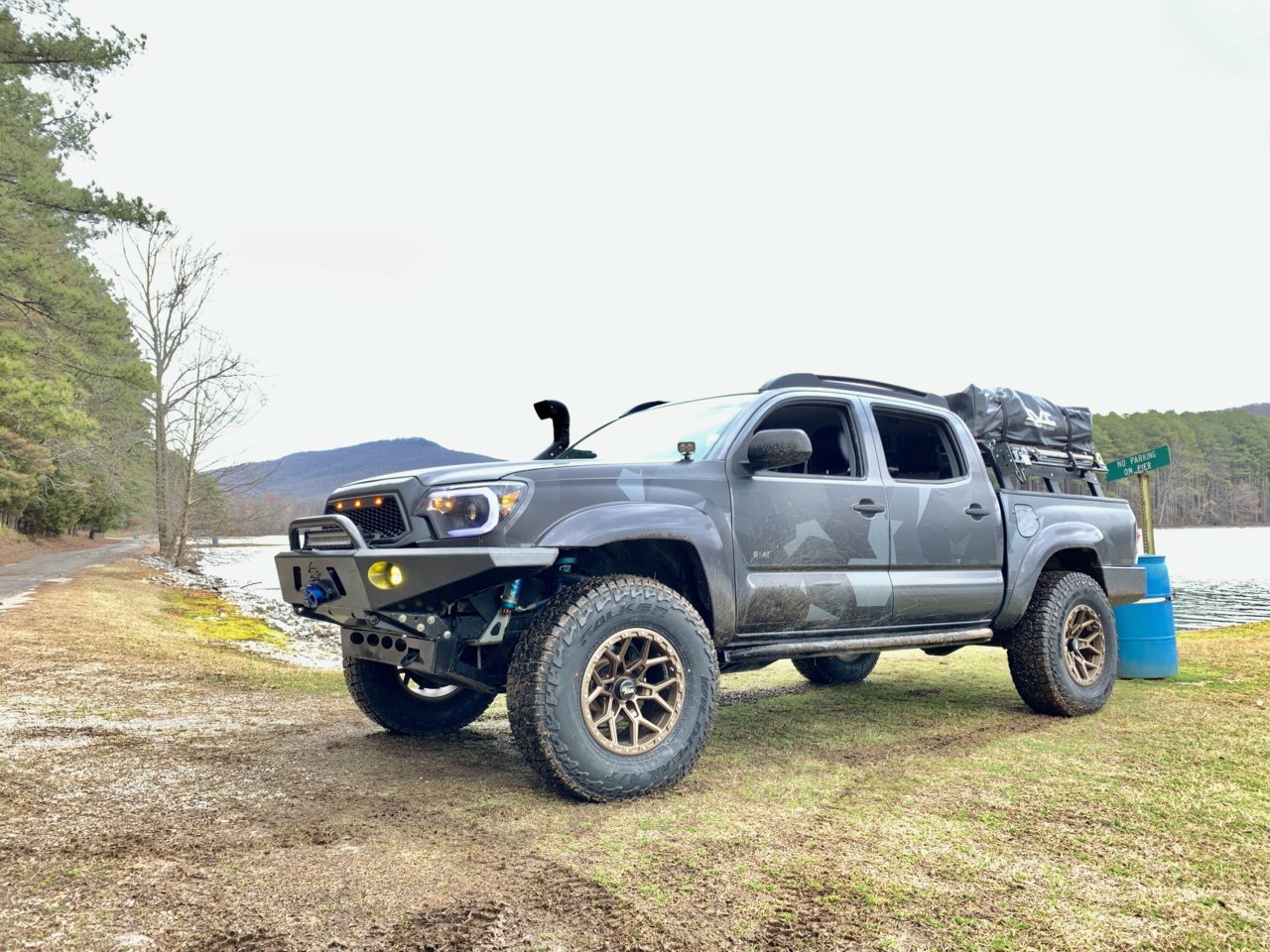

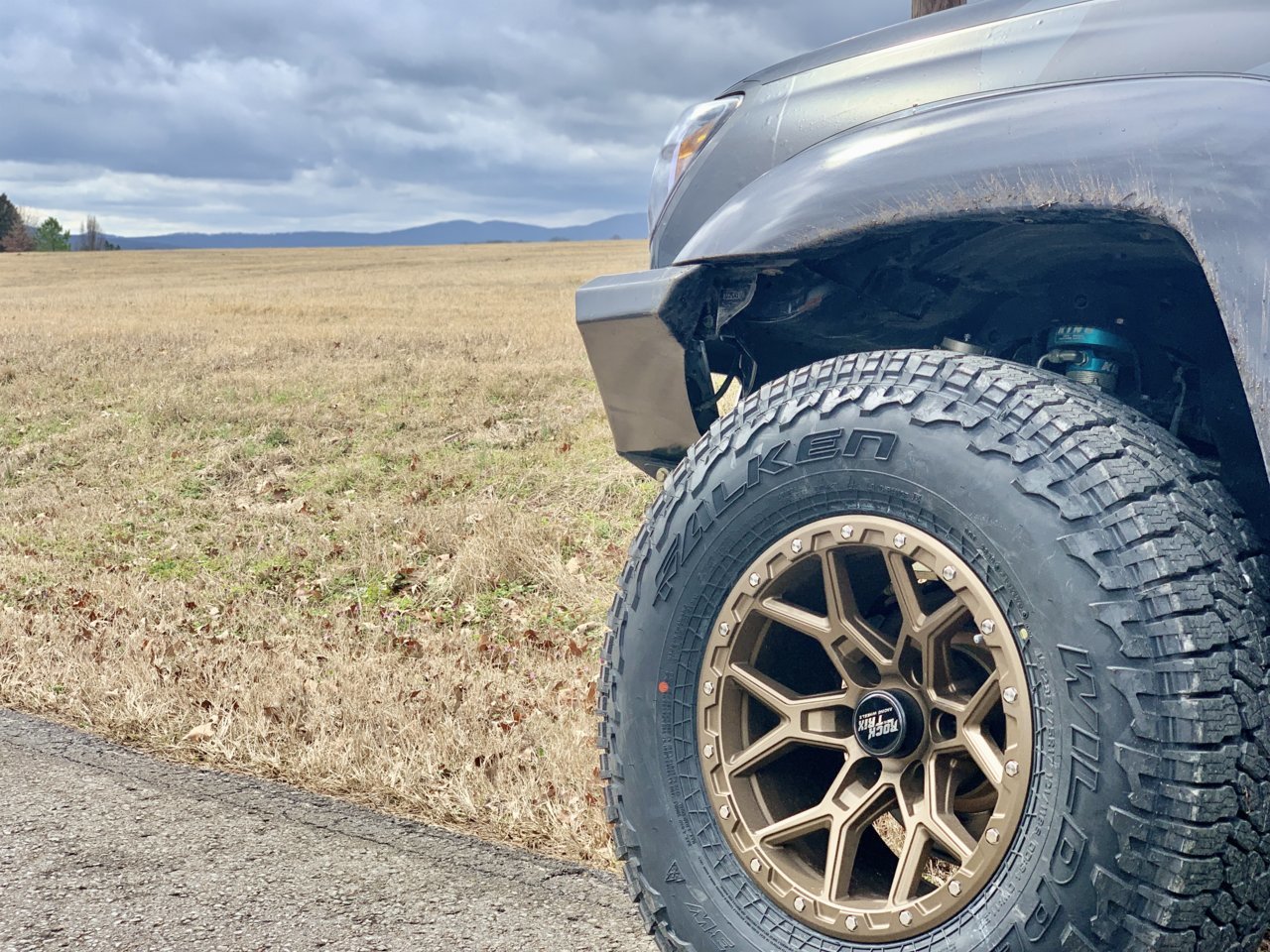

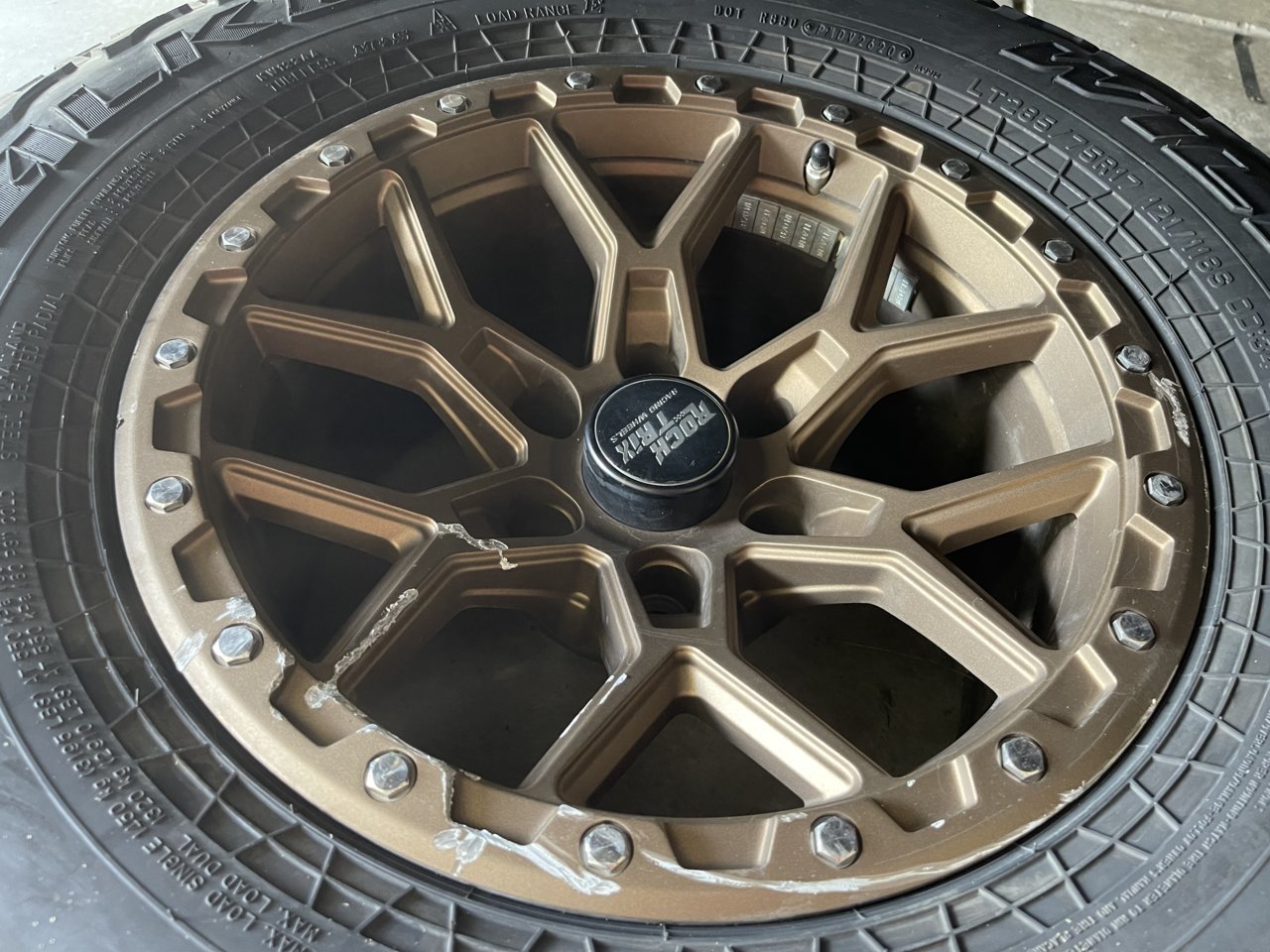

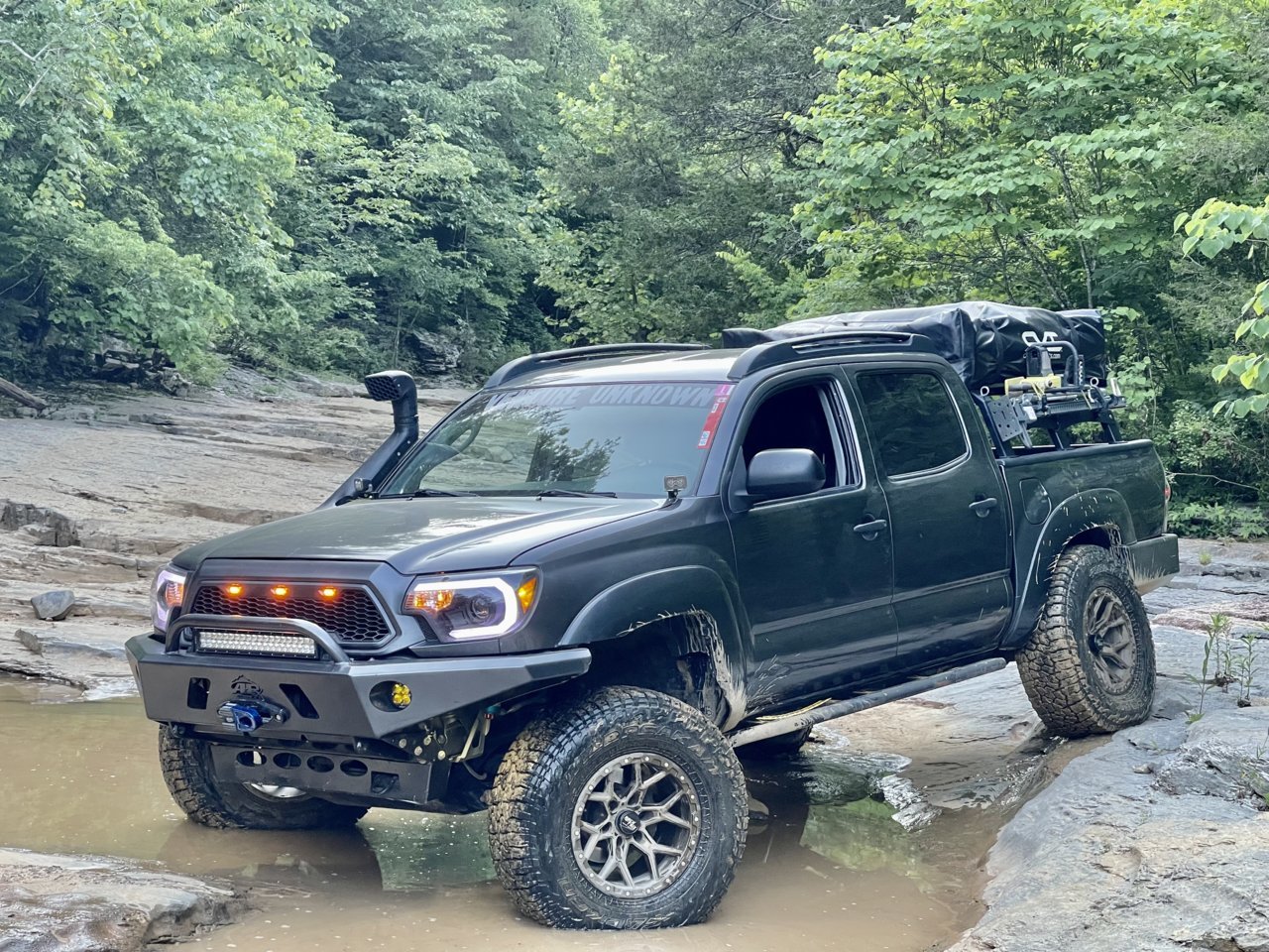

    HappyGilmore
    HappyGilmore LambTek Innovations
    Dec 24, 2018
    #276792
    2,978
    Huntsville, AL
    2013 SC’d DCSB TRD OR 4x4 | 2012 Lexus IS-F
    Yes
    Running those wheels with these lugs. Work perfectly with zero issues.
    Gorilla Automotive 21134ETBC... https://www.amazon.com/dp/B00SF8FF86?ref=ppx_pop_mob_ap_share
    Great wheels, don’t let the naysayers tell you otherwise because they are cheap or Amazon wheels. Balanced perfectly even after rashing them up nice and good. I got them bc they look great imo and I didn’t see the point in spending $1000 + dollars on wheels I’m going to rash up.
