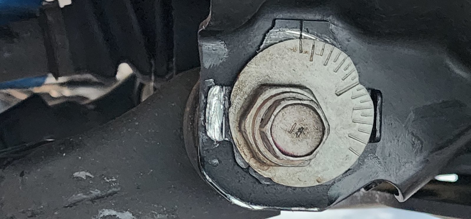

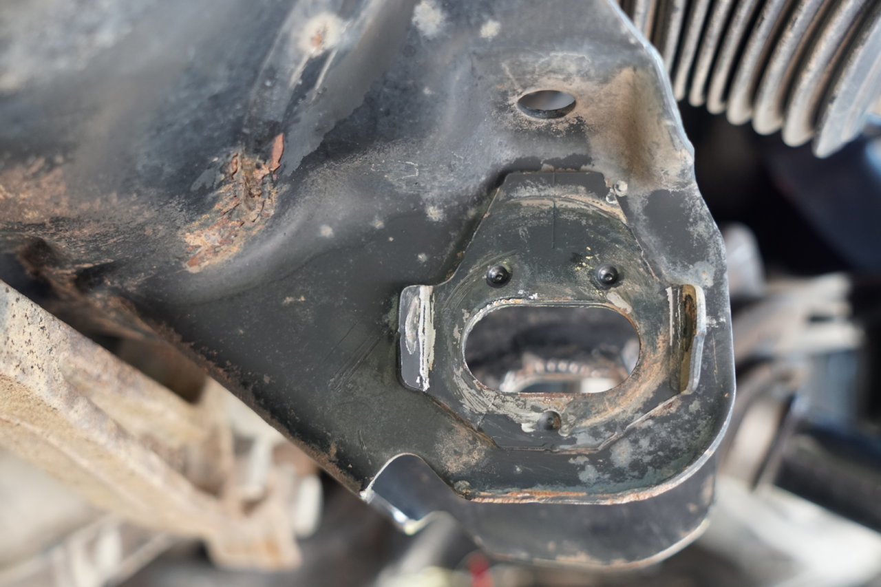

    Got an alignment done and I was notified of this. The tab that holds alignment cam in place broke off. My right front camber is off and couldn't be aligned.
    I have heard these tabs are weak and this is not unheard of, but I don't know where to go from here and I'm hoping someone here can help.
    I found this, but I don't have welding capabilities. https://www.chaosfab.com/product/20...-Lower-Control-Arm-Cam-Tab-Gussets-59860-10FJ
    Is there another option? Or should I buy these and take them to a local 4x4 shop to get welded on?

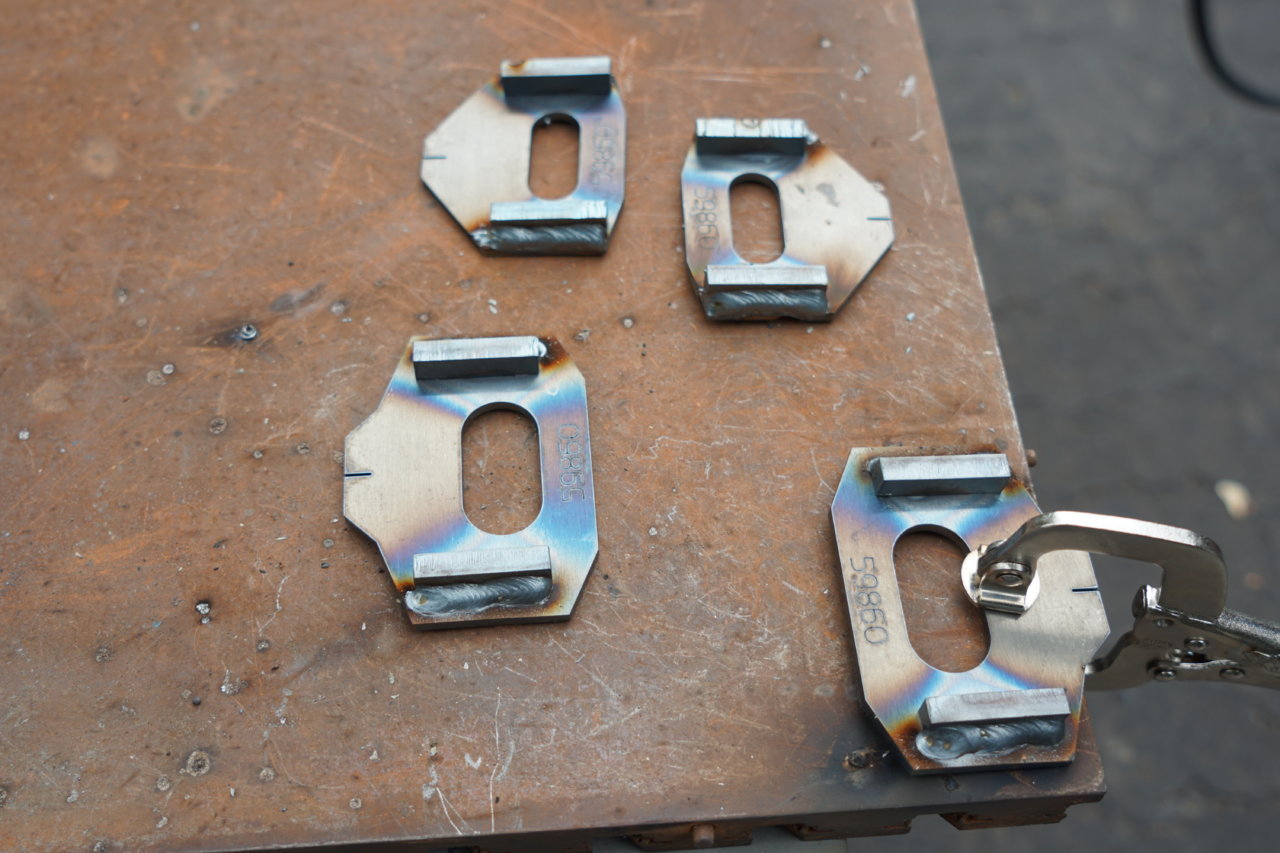

    Couple of options besides total chaos. Dirt King sells same kind as total chaos. Marlin Crawler sells the frame brace kit. If I wanna buy once cry once get the JD fab lower pivot kit.

    That ain't broke off... That clearly looks like a careless dimwit whipped that thing all over the place with an impact gun (probably attempting to tighten it using the wrong hex) and flattened everything out. Then got rid of you by simply saying "Oh, it just broke off". They should've fixed that without charge, although I'm not sure if I'd want them touching my truck anymore if they did that to mine... I'd suggest write that place off for good and get one of the options above welded on.
    Not a bad idea to reinforce that area anyway if you go offroad a lot.

    It's a 2 step process for the beef and to never need an alignment again.
    First step is new tabs many companies have a set. Dirt King & Total Chaos for the tabs. 2nd step is the cam eliminators. I like the 333 Fab the best, but there are many companies that sell kits to lock in the cams. I have not needed an alignment in 2 years with a bunch of wheeling. Before this set up I needed an alignment after every trail ride. These installs have saved me a ton of money on alignments.
    Tabs --
    Cam Eliminators --

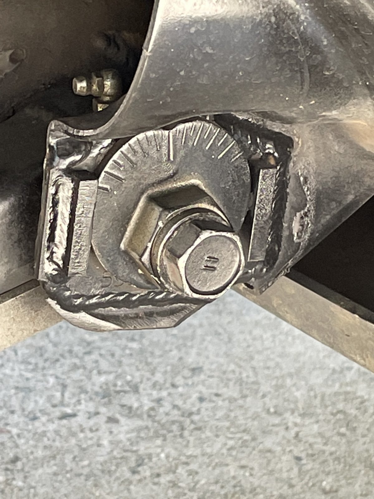

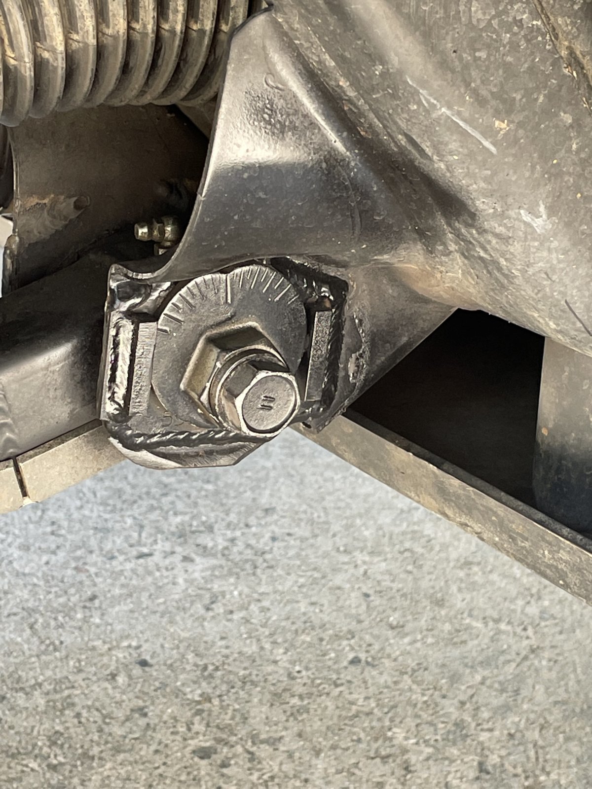

    I had my 17’s tabs welded and they were great afterwards. Held alignment great.

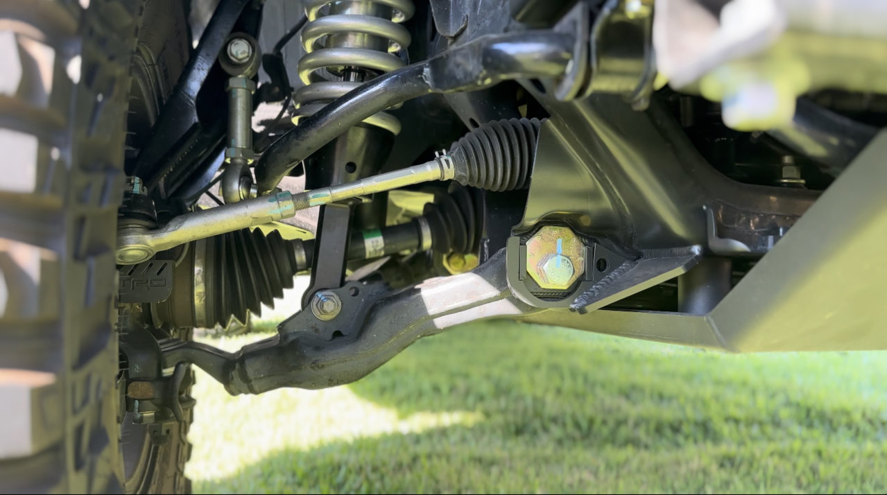

    Vmax540 and CygnusX191 like this.

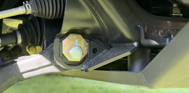

    Marlin HD and Total Chaos cam tabs with Bison cam tab stops. Just to give ya an idea what it looks like.

    The holy grail. I bet alignment shops hate those cam tab stops lol.

    Nah. When those come in, it's toe n go on that truck. Send it
