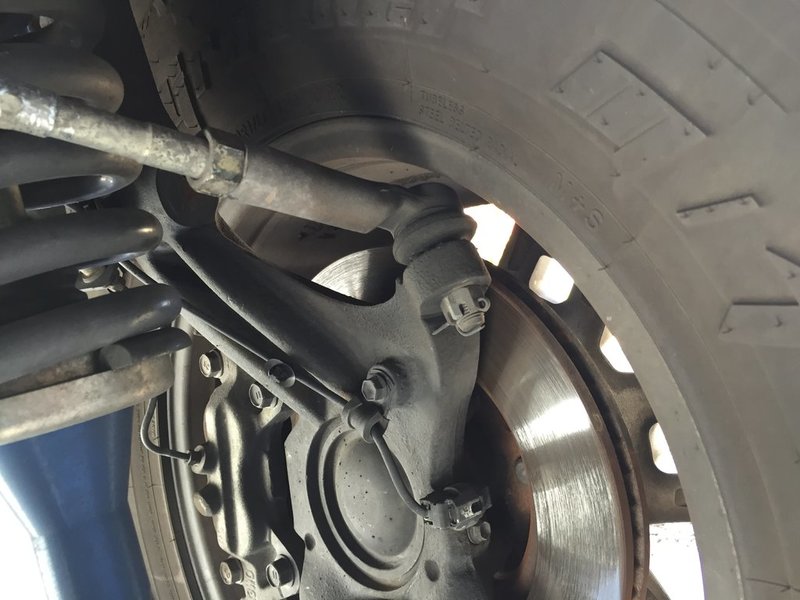

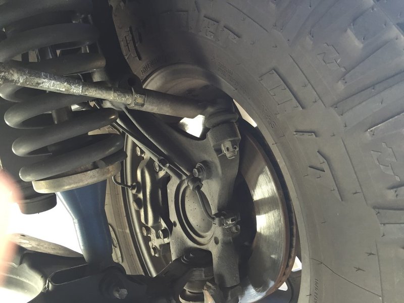

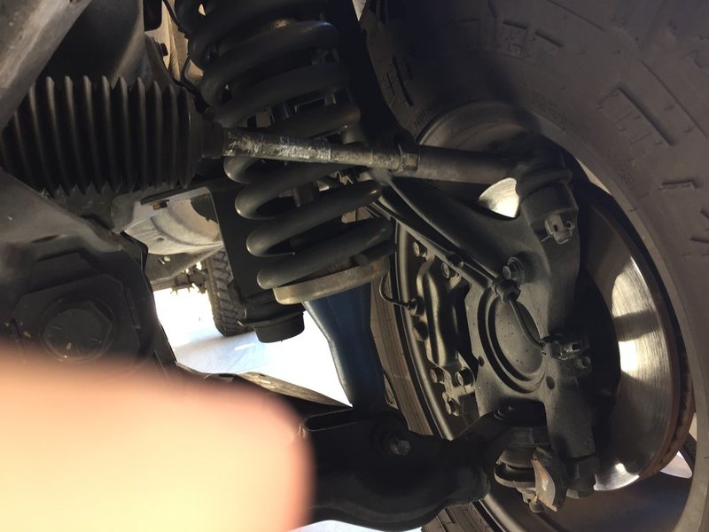

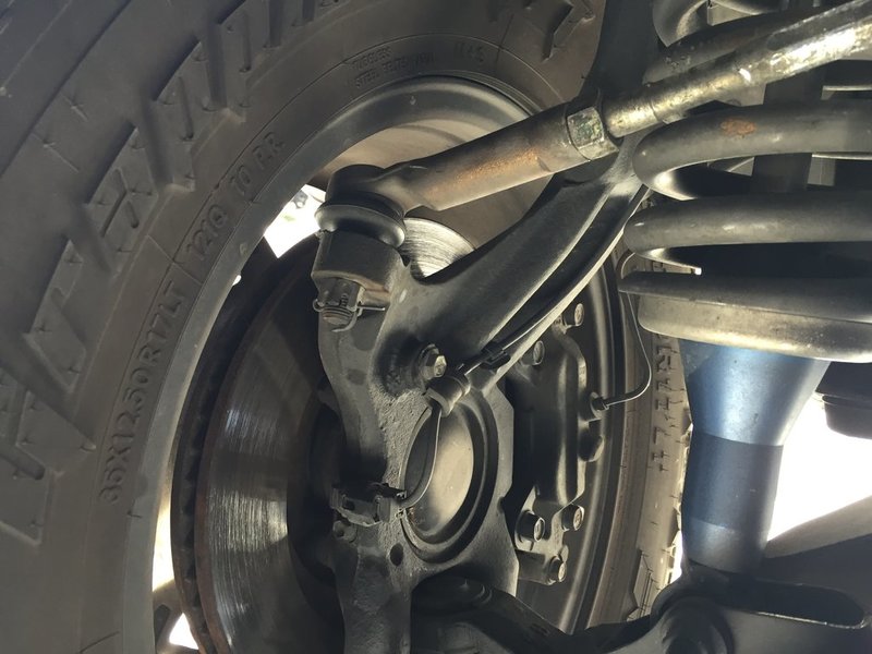

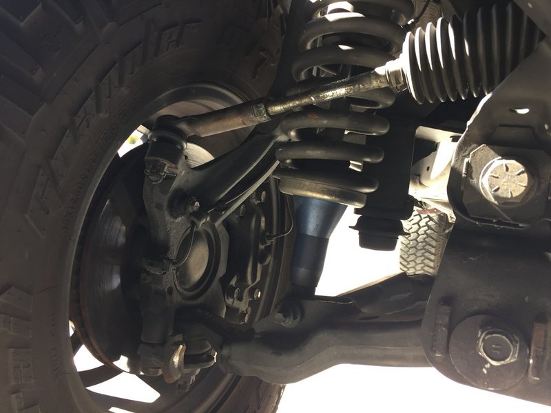

  17. Feb 3, 2016 at 12:08 PM
    #57
    Cowboyz
    Cowboyz Membor
    Dec 21, 2011
    #69143
    507
    Luke
    Southern Utah/Las Vegas
    07 DC LB TRD Sport
    6in Pro Comp stage 2 lift, 2.75in ProComp Coilovers, Rear MX6 adjustable shocks, 35in Nittro Trail Grapplers, 17 in XD Spys, URD intake, URD MAF Calibrator, Flowmaster 40 Series, AMP Power steps, debadged, blacked out tail lights, Blacked out headlights w/ Mini H1 Retros and halos, JVC KW-AVX840 7" Double-Din, Viper 5704 2way alarm/remote start, LEDs in Dome, Maps, and license plate lights, short black antenna, 5% Tint, removed sway bar
  18. Feb 3, 2016 at 12:19 PM
    #58
    Cowboyz
    Cowboyz Membor
    Dec 21, 2011
    #69143
    507
    Luke
    07 DC LB TRD Sport
    Let me know what you guys see or if you need me to take more pics or better pics.
  19. Feb 3, 2016 at 12:50 PM
    #59
    nd4spdbh
    nd4spdbh Well-Known Member
    Oct 7, 2013
    #114055
    14,582
    SoCal
    13 DCSB TRD OR v6 Auto
    passenger side spindle where the tie rod connects to the spindle doesnt look NEARLY as deep in the wheel as driver side. You can also tell by how far away the tie rod attachment point is from the disk. Passenger side is way further.
    Did the person that hit you hit on the front or back of the tire. Id bet the back, bending the tire backwards, causing you to have to run the tie rods all the way in.

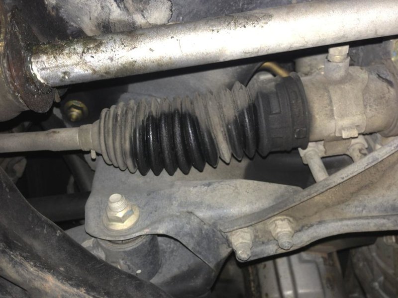

    With your wheels straight, are both of your steering boot covers of equal length? This is just a picture that I pulled off the internet to show what I'm talking about.
