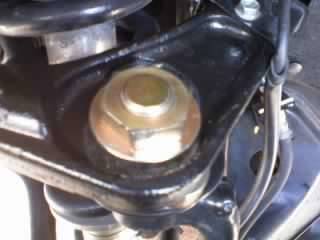

    ok i installed my l.r. uca's yesterday...
    i brought it to be alingment. shop today and here is the read out
    i even brought him the control arms before i installed them so he could see how they adjust...
    he's like yup i had them on my honda....
    now this......
    i have 265/75/16 5100's @ 2.5 stock springs
    i think i need to know what to set the l.r. adjustment at and to set all my stock caster & camber Adjusters back to Zero then bring it back to him........ help........... i am about to knock this guy out.......

    have it redone @ 0 toe, 0 camber, 2.1-2.4 caster. mines @ 2.1 which is perfect.

    yea he said this is all he can do.....he did not rotate the ball joints from how i put them in spc facing out... all he did was slide the driver side in about a half inch???
    any thoughts??????

    do you guys think if i flip the adjustmen to the - 2.0 setting which is with the ball joint up towards front of vechile..... am i correct

    So what is the complaint? It's within spec right?

    I doubt this will help, but here's what mine look like. Everything on my alignment is within spec. 0 toe 0 camber 2.1 caster.

    yea you aint kidding i put them in in an hour and 45 mins now i have to find someone to fix it or tell me how to set all the cam adjusters to zero and what to set the uca's to and then bring it back to firestone......

    I think this is wrong bud...That rounded edge is suppose to pointing at the truck...

    Thats what mine is ;)

    this is it how i installed them yesterday???

    Thanks for the pics guys...fixin to do these this weekend & I woulda had them a notch too far towards the rear of the wheel well from the looks of the pics. I'm gonna do mine the same way as y'alls. I will concur that in all of the adjustment setting pics on the install sheet, the round edge always points in and the stud of the ball joint is what moves forward or backward to regain or lose more of the caster setting depending on which way they are rotated.

    Yep, Numbers look good. Caster is high but that is fine. Both Camber settings are a little positive but are both within spec.
