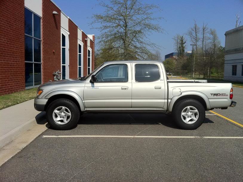

    Hye guys,
    Im getting ready to invest in a lift but want to make sure I'm not lifting on sagging or warn out springs. My truck seems to sit a little lower than the extended cab at my apartment complex so I figured I would post a few photos here and see if anyone can let me know if I should replace my springs, or just throw a AAD in there. It looks like my leafs are sagging, but I still have a little more than an inch left between the bumpstops. Any help is welcome!!
    *Note I have 265/75/16 tires on the truck now and u-bolt clamps in front of the axle on the leafs to get rid of the axle wrap I had.

    I personally wouldn't put an AAL on those, it may help for a while but won't last long since the springs are so worn. The negative arch on them is not a good sign.

    looks pretty shitty to me.

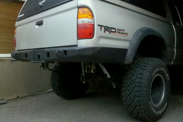

    Oh wow that new pic you posted is really bad, probably the worst I've seen. Definitely go for the new springs, an AAL wont do much on those.

    :eek: those are toast do like the others said buy new leafs a AAL will do noting with those. You have got to hitting the bumps all the time with those things.

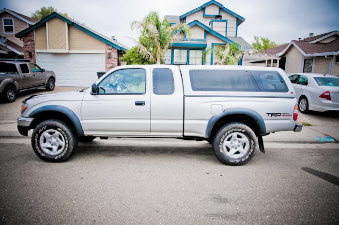

    I personally think you need all new suspension you are sagging pretty bad and 5100's and your stock coils are not going to give you 2.5" of lift in the front. This was my truck stock and mine was sagging a little and it was sitting a lot higher then yours.
    But this is with 265/70/16's so 1" difference in tire size
    And yours
