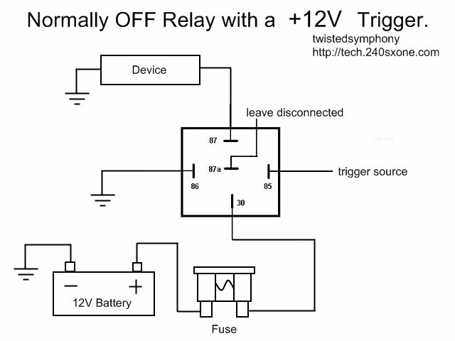

    Something like this. Have i forgotten anything

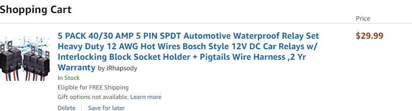

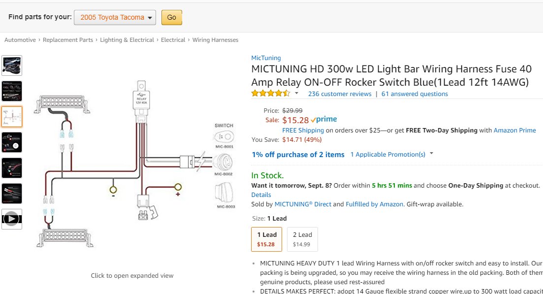

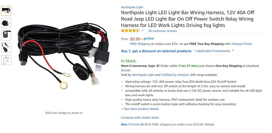

    Would this work. Just stumbled upon this Amazon searching. seems like its comes with everything i need since i want 4 switches i would just by 4 of these and that is only $60. TW thoughts?

    Trucko
    Trucko [OP] Well-Known Member
    Sep 22, 2013
    #113030
    1,289
    Summit County Colorado
    2005 Tacoma
    arb bull bar Smittybulit 9.5 winch topper shell with yakima basket piaa lights toytec boss coilovers Dakar leaf pack with boss shocks 28/75/16 bfg at ko2 Midland CB Home made trailer with CVT Mount Rainer tent and max coupler hitch
    I am actually liking this other kit more. This will be the rout i go.
