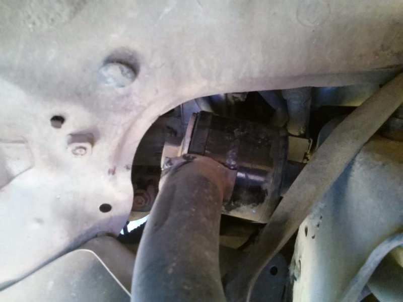

    Icon ext travel expo leafs rear billies 5125 10'' travel bamf bpv relocate Brute Force Fab Sliders allpro ss brake lines f/r LR UCA 22in wetokled bar RAT Products ifs skid ARB rear locker Ultra gauge Redline Hood Struts Blue Sea Fuse box smittybilt xrc 9.5 w/TJM synthetic rope trail-gear rock assault low profile bumper LED bed strip 12v/usb charger in truck bed
    this was mine, after a 2 day camping trip. drove 2 hours home wondering why there was a clunk on my passenger side. :(. LR sent me the new design and has held up so far. :cool:
