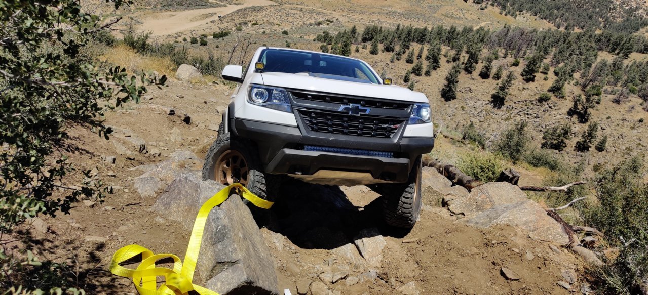

    I have my buddies ZR2 Stuck on the Miller Jeep/Lockwood area. Ran outa ideas on how to recover this bucket and I'm reaching out to TW to see who can help on this one :ballchain:. Definitely can compensate for your time
    I made him go thru an offschut and the tie rod tacod in, we parked it and went back to the city to get some Micky mouse equipment but nothing worked and his CV busted in process lol
    Plan A is he's gotta get new CV and Tie rods and we fix it up there in a few days
    Plan B would be if any member from TW thinks they can Mickey mouse this to make it to the bottom of the hill, maybe portable welder and tack the tie rod back :itllbuffout:
    This is where we parked it
    34.7306480, -119.0395233
    Posted some pics for you guys too

    replace tie rod. pull the axle and go 2x4 and use two 4x4s (with winches) one in front/rear to assist the limping chebby off the trail.

    Yeah looking like the plan, such a bust zr2 parts aren't readily available. Might leave her up there for a week

    Nope. Just three sets of jumper cables and 1/8 6010 rod. 3 batteries will do the job quick and easy.
