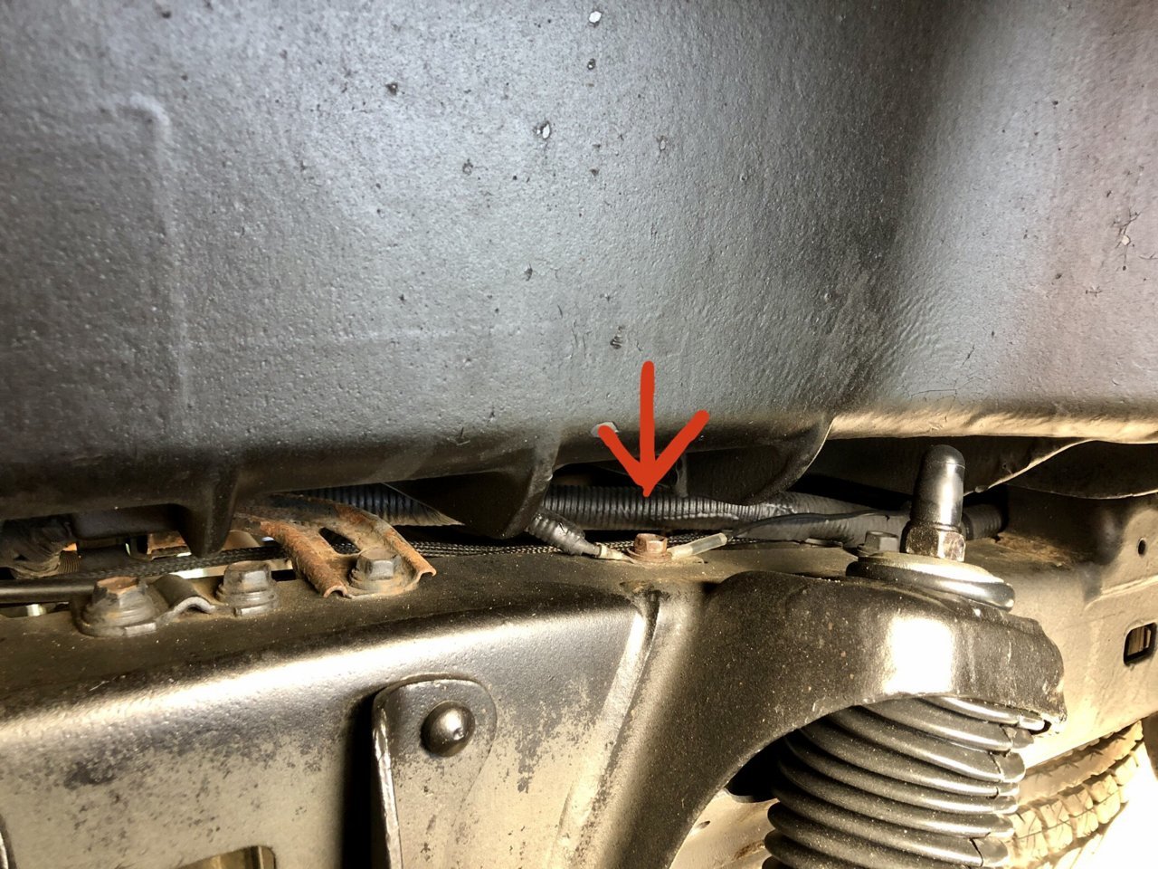

    Post pics of your ground

  8. Jul 14, 2020 at 5:24 PM

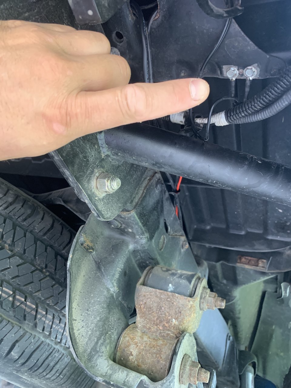

    Out of curiosity what is the 2nd wire next to your current ground? Also what AWG wire are you using?

    I would say that is probably a high resistance ground location and when the tailgate is closed it gives it a better path.
    If you have a meter test that ground connection continuity to say the frame and read the resistance. Close the tailgate and take another reading. If the resistance reading goes down you have the answer. Poor ground location.

    The second wire next to this one is another set of LED lights ran completely independently (new positive from battery and obviously a separate ground) That I stuck to the roof of my camper shell to really “Light it up” when I need to see inside to get something In the bed (white light verses Gecko cool light, and it’s too bright, LOL)

    Maybe try this ground location. As a test you can just run a jumper cable from your current ground to the factory one. This is on the drivers side BTW.
    EDIT: I just noticed yours is on the passenger side, there may be a ground location in the same location I posted.

    Moved the ground to frame and problem solved!
    I had used the location shown (bed support), but with the recall replaced frame apparently there wasn’t a good contact through the frame coating. Ground paint, raw steel, zipped the ground there and boom!
