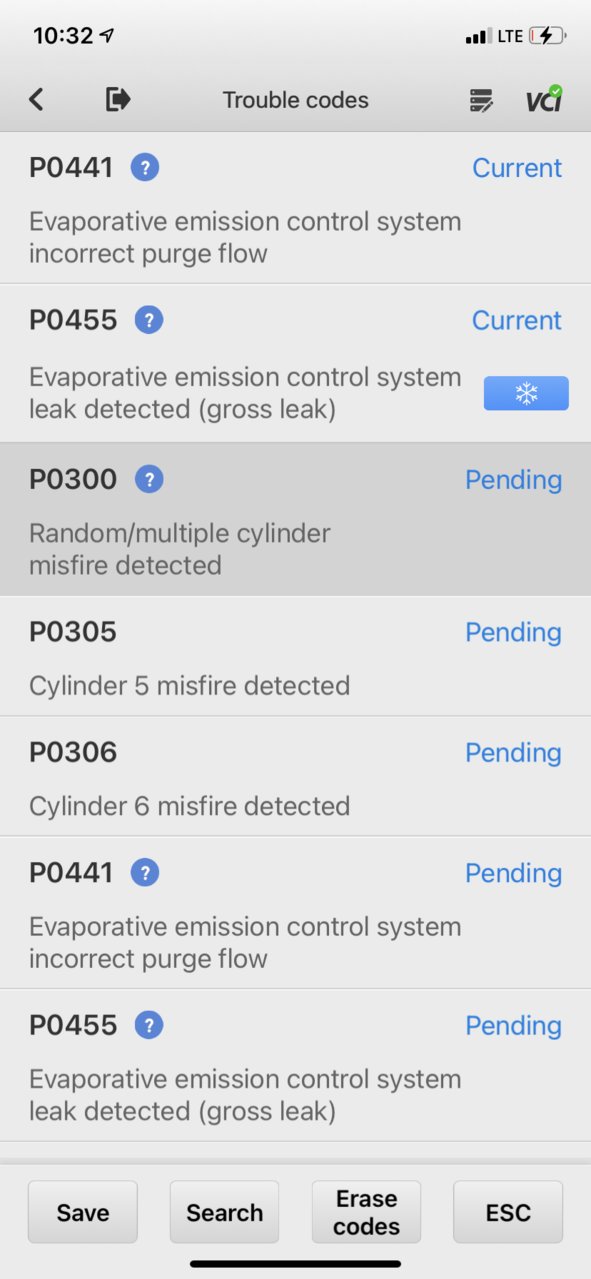

    I have an 06 Tacoma V6 4WD with 250 thousand miles on it. Have not had any engine problems in the past. Drove my truck home last night pulling the boat from the river with no problems. Went to start it this morning and it had a really rough shaky low idle and was white smoking from exhaust for about 10 seconds, then if just flattened back out on its own and ran fine for rest of day. Checked it with my diagnostic tool this evening and I attached a picture of the codes it threw about missing cylinders. Any idea on what it could be? Thank you in advance!

    I see you have a code for incorrect purge flow, if your purge valve is stuck open and your fuel tank is full or near full it could pull raw fuel fuel from the tank and cause an extremely rich condition which could also cause white smoke and rough running. While it may not be your issue it's worth checking into before assuming headgasket.

    A loose or poorly sealed gas cap will also throw those EVAP codes. Is the smoke just white or bluish white? Maybe it's just startup condensation. Tighten the gas cap, clear the codes and report back. Compression test would be next if the codes return.
