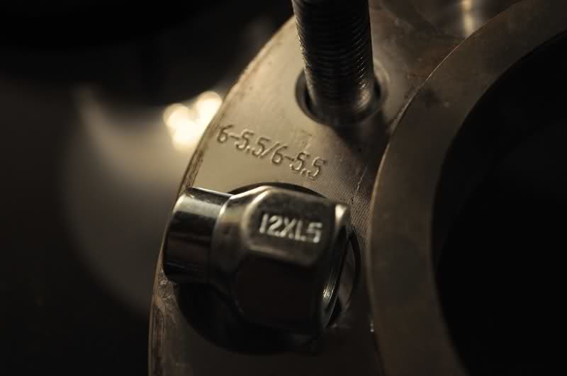

    well the nuts are clearly different than mine. here is a pic i found of the correct nuts...
    and heres a pic of the nuts that i have...
  8. Mar 31, 2014 at 7:28 PM
    #28
    Kelvin
    Kelvin Wheeeeee
    Mar 8, 2013
    #99256
    2,884
    16’ GX460 with some junk bolted on
    Those look like the lugs that come with the All-Pro's. Can't imagine why they wouldn't work.

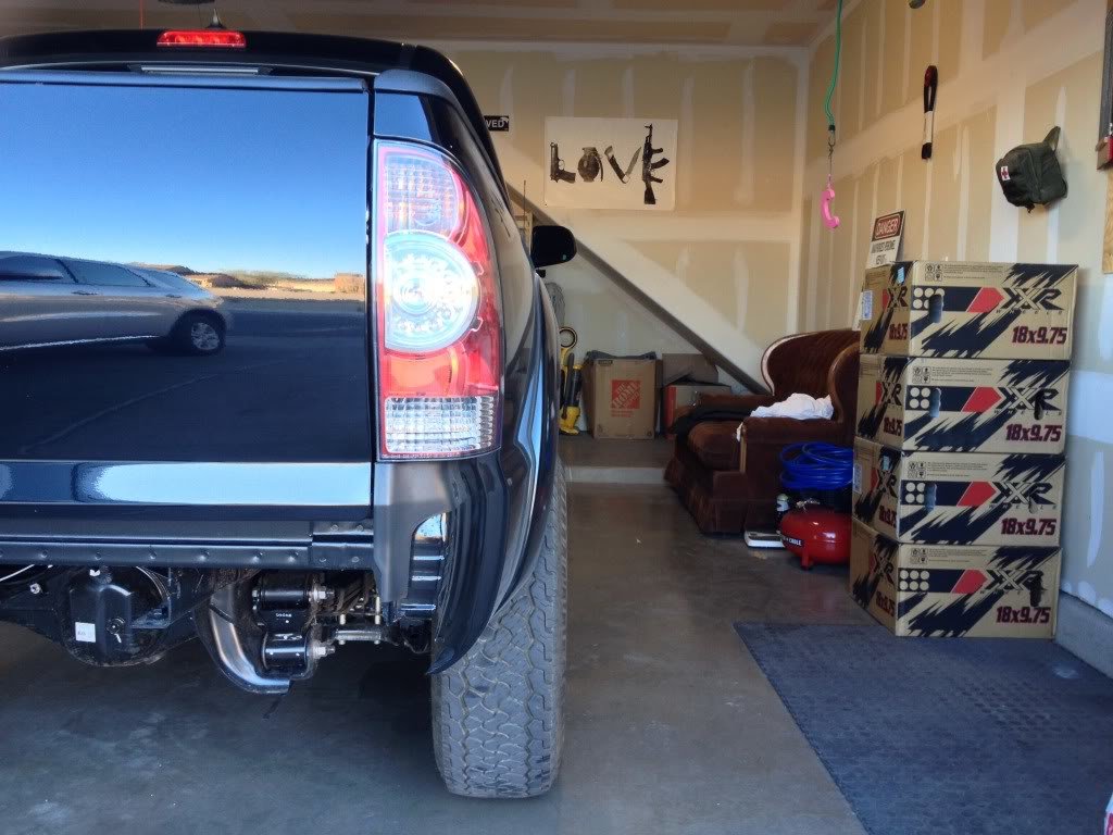

    new lugs from spidertrax did the trick. and dont worry, bumper was off so i could finish sanding it down and painting it.
