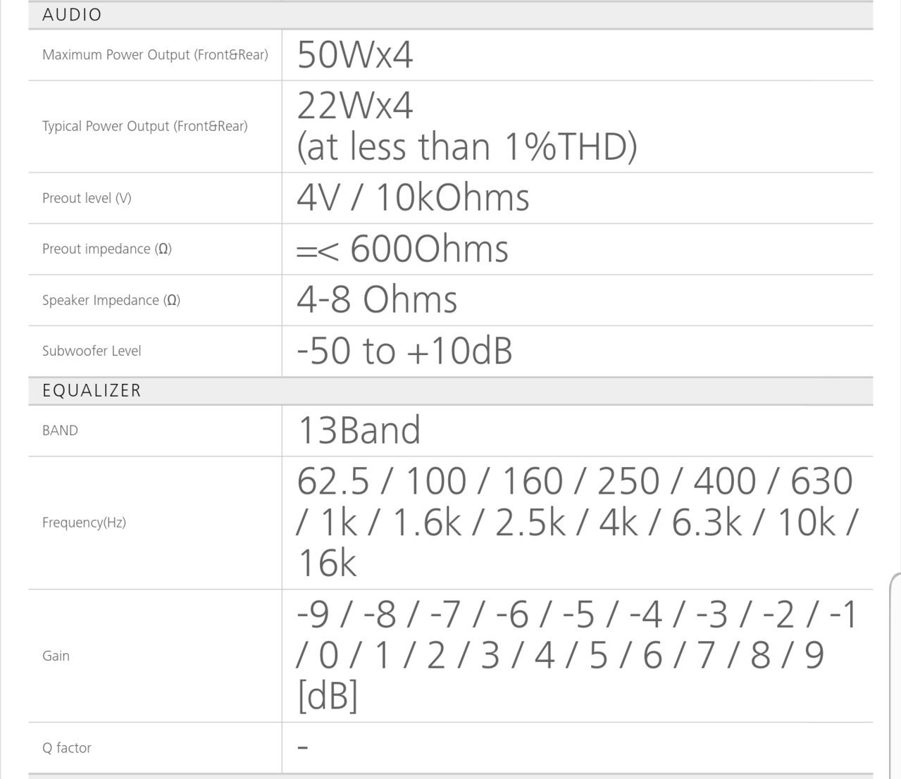

    Right now my rears are from a stock jbl system out of a 3rd gen. They plugged in and played fine, but they started popping at high volume or if there was any significant bass. I dont know if it's a power issue, but I need to get new rears that will work without popping.

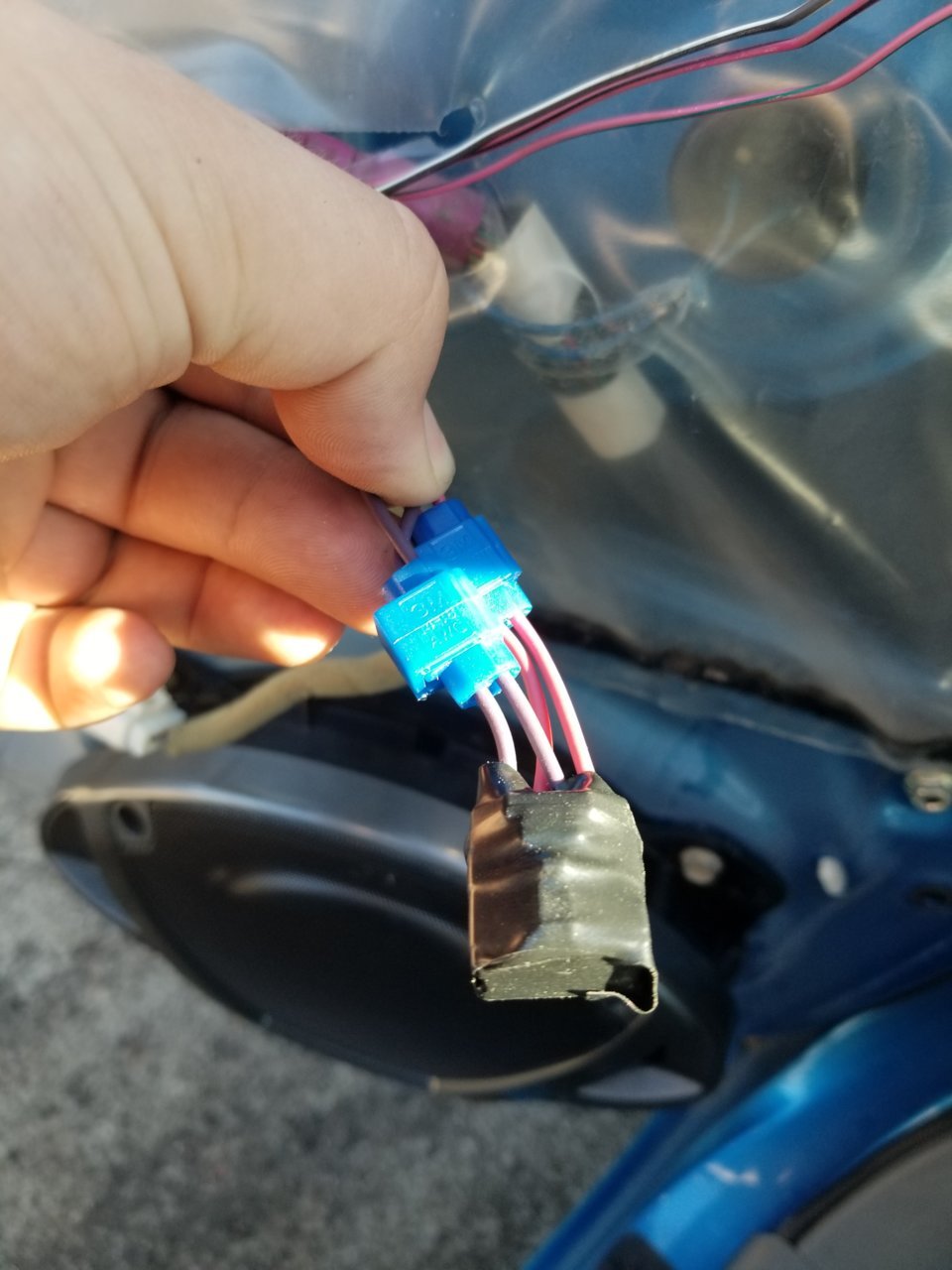

    Thanks for the advice so far, I really appreciate it! If I were to remove the stock ones, would the lower 6x9s still get power? I guess I'm asking if the door is wired in parallel or series. If it's in series, would I snip the tweeter connector and crimp the lines together?

    I'm not sure how they wired them, but I seem to recall that if you unplug the tweeter, no signal makes it to the lower connector on the door, but I could be wrong. But there's only one speaker wire coming into the door, so it shouldn't be too hard to figure out.

    Update: so I put in new kenwood KFC 1666s in the rear (way better than the stock jbls out of a 3rd gen). Then after waiting a couple days for the brackets got those 6x9s in. I did have to do a "tweeter delete" by getting them out of the door and rewiring the 4-pin harness to allow the 6x9s to work. I'm no electrician, but nothing's caught fire yet... I also wanted to keep the stock plug in case I needed it for anything.20190831_154300.jpg
    Now with everything together it sounds way better than stock and I dont think I need an amp as it's already really clear and goes way to loud for my liking, and that's saying something. One thing I did notice was what I thought was great bass performance from the stock 6x9s was really just distortion that shook my mirrors in the low tones. I now lack the low end oomph, so I guess I'll be on the lookout for an underseat sub. The sound is all there, I just like to see my mirrors shake and feel the oomph of the low notes. And all this only breaking 1 clip on the front door!
