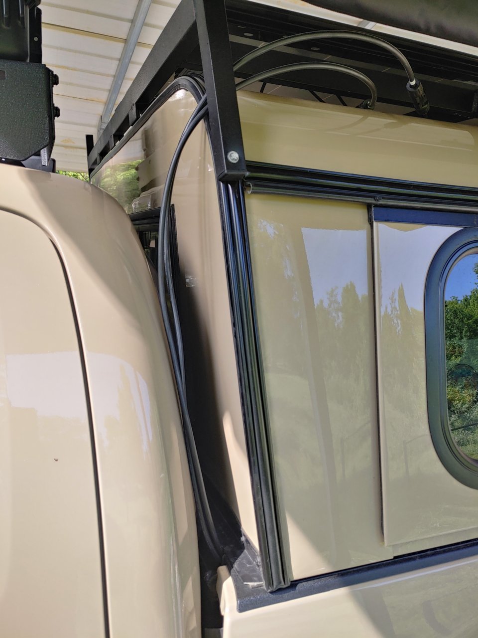

    I'm running my wires from solar panel on top of topper to inside for battery. I used the little gap at front of bed, will be redoing the putty.
    What would you guys suggest using to hold wires in place? Some kind of stick on clip. Could you link to it or provide picture? Would rather not drill into cap.

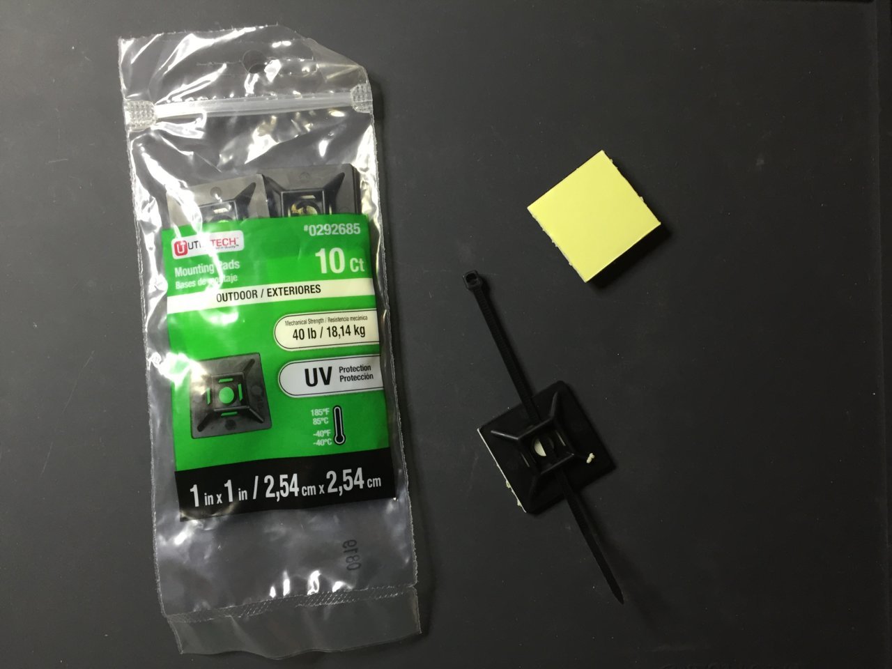

    Found these mounts at Lowes. Zip tie is not included. Works great. Found on the zip tie isle.

    YES! These are exactly what I need! Didn't know something like this existed. Thank you!

    Excellent! I believe you are talking about what EvenSlow showed a picture of. They will work great. Didn't know something like that existed.

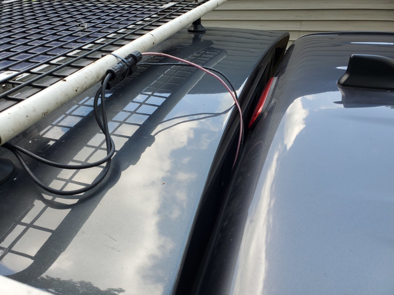

    I use nothing. I ran wires under the bed and up through existing drain hole in the front passenger side.

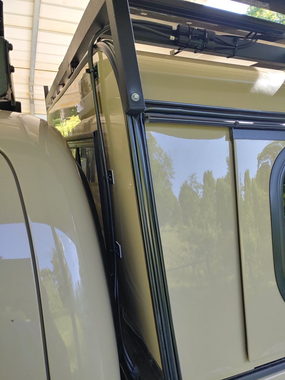

    Got it done. Looks so much better. Thank you guys.

    Bam! Looks good to go man. Carry on, peace out.
