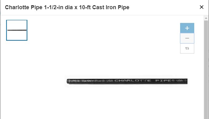

    dustin19d
    dustin19d Well-Known Member
    Apr 19, 2008
    #6076
    726
    Dustin
    Washington
    06 Sport, 4X4, 6-Speed
    Welds and Cuts and stuff
    Once upon a time I picked up a 1.5" Dia X 4' cast iron pipe from Lowes. It has man handled many a axle nuts over the years.
