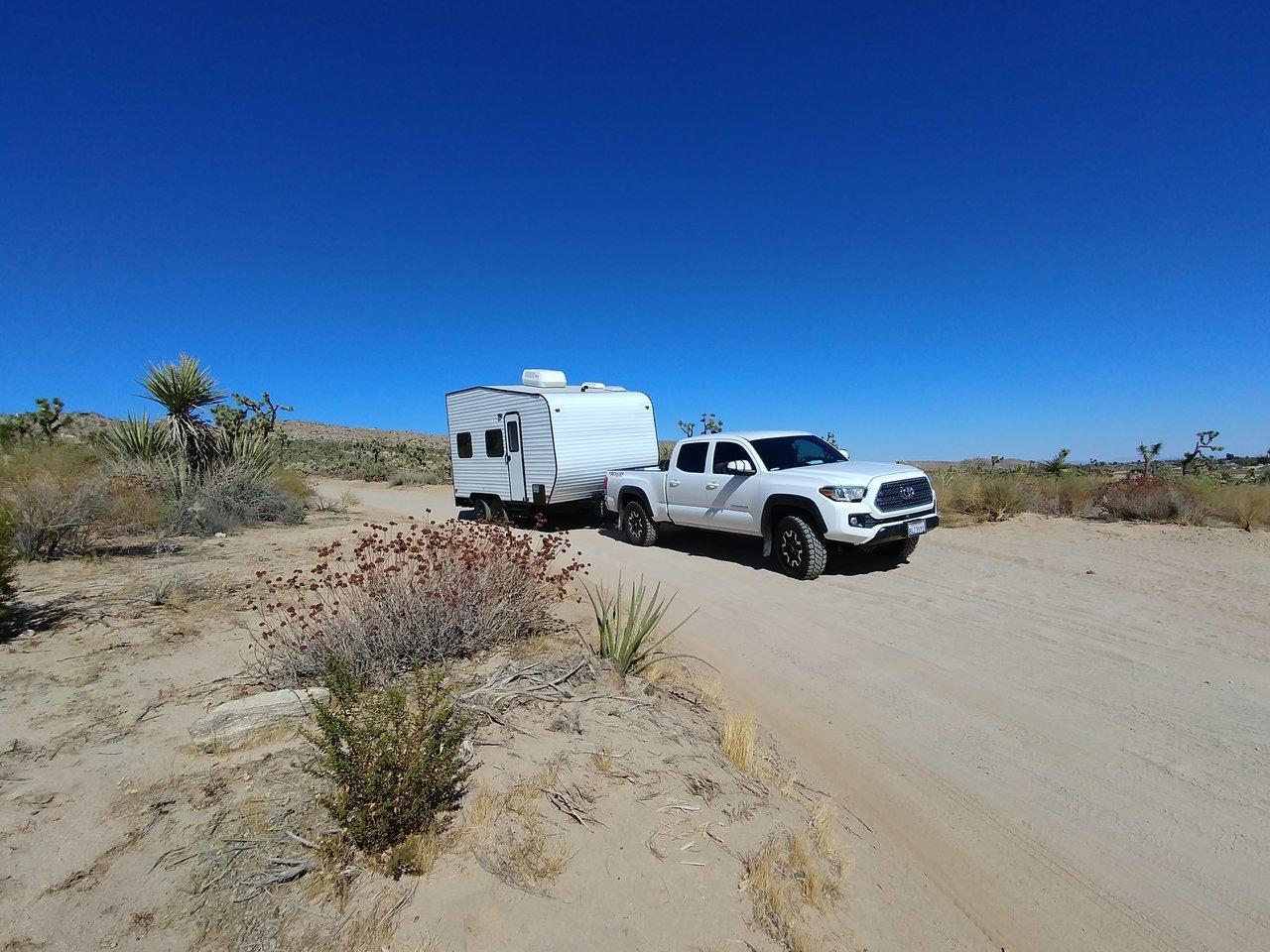

    I definitely undersrand your conundrum. I tow a 3500 lb loaded travel trailer fairly frequently and don't have any desire to own a full-size pickup truck. If I did I'd have to get a bigger trailer / toy hauler and carry around and RZR for the trails and probably end up with a diesel pavement princess tow rig easily tripling the cost of my current setup.
    Right now my tow rig / trail rig is a 2016 TRD OR. I'm running icon suspension with Firestone Ride-Rite air bags and Daystar floating airbag cradles. I'm also only running 265 75r16s with 4.88 gears and a monster ATF cooler and always tow with weight distribution hitch and sway control. The truck will go just about anywhere and does a pretty damn good job of towing the trailer too. It could use a little more juice it's still able to maintain the speed limit going up a 9% grade while keeping the transmission temps reasonable. Depending on your budget I hear Magnuson will be releasing a third gen supercharger soon.
