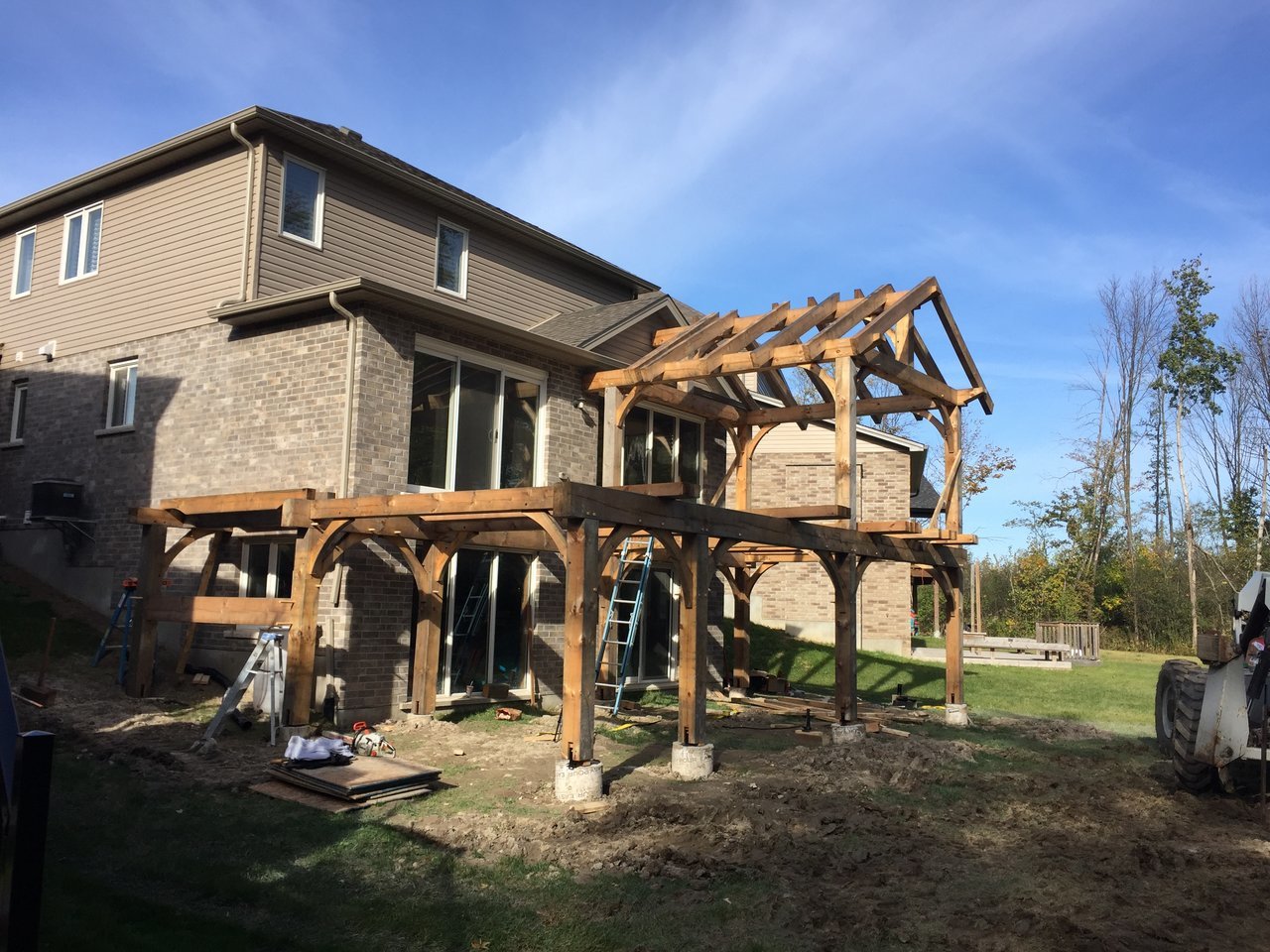

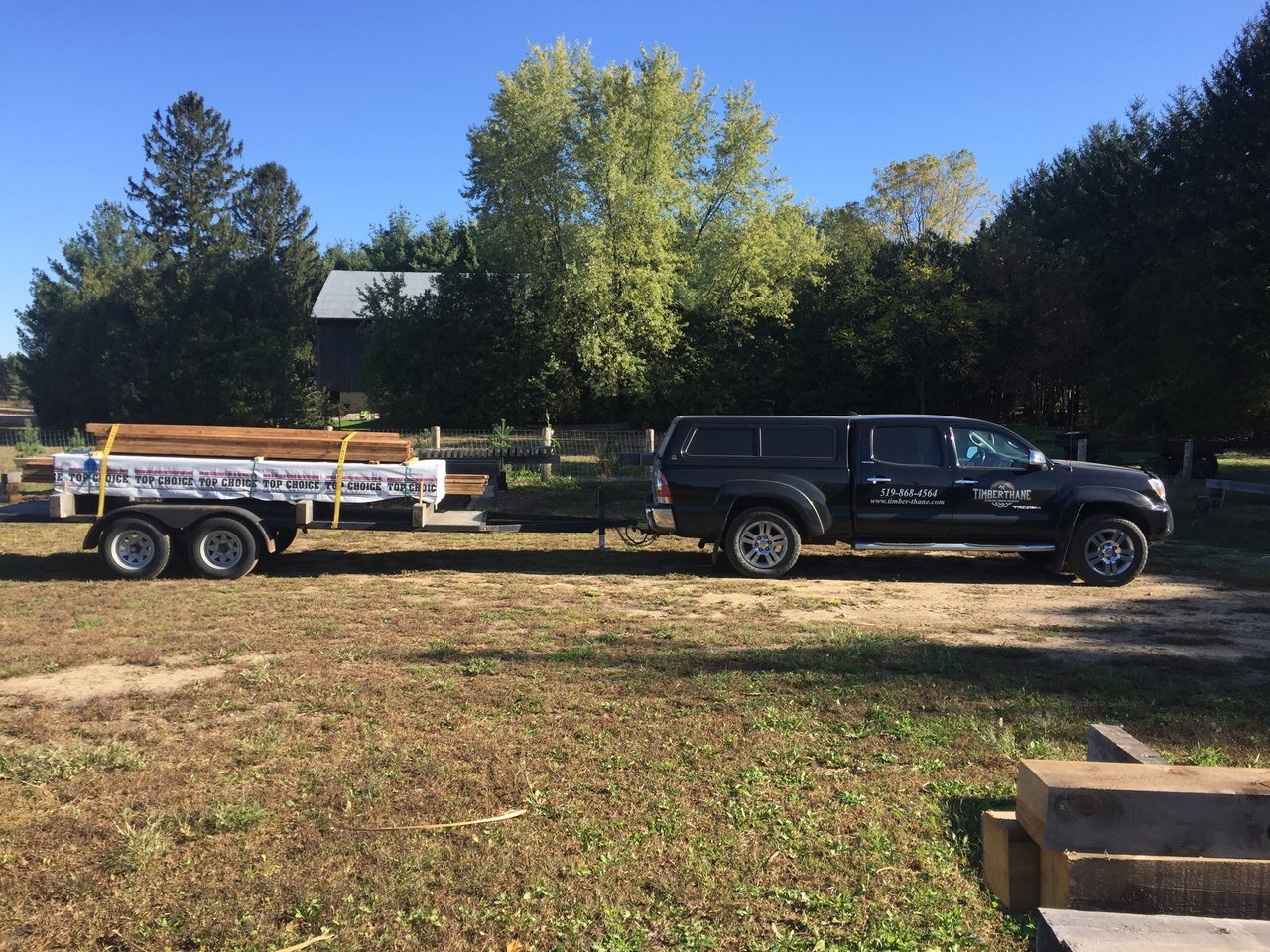

    So I had to pick up some PT at Lowes today for a deck I'm building. I remembered this pissing contest so I videoed the "burnout" with my phone. The load was likely about 4000 lbs based on how it felt towing. You can see by the picture, there is plenty of tongue load. The trailer empty has a 150 lb tongue load. Video to follow... going to be a while uploading at .5mbps.

    Sweet. Ass. Deck!
