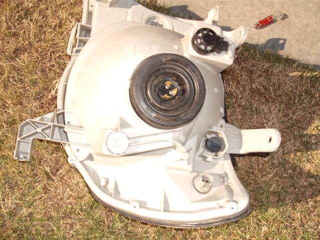

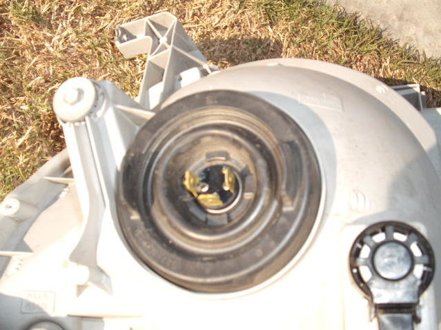

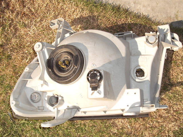

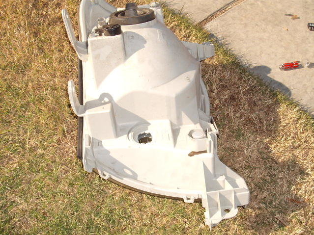

    help! BHLM. o im trying to do this and i think im ready to put it in the oven but I dont know if i have everything off thats needs to be off. Anything else? Thanks!

    I would take the headlight bulb and the rubbler seal around it off. Also the plastic vents and the plastic cover off the adjusting screws.
    Edit: looks like your marker bulbs are still in might want to take those out too.

    So is the marker the one on the top left of the light if ur looking at the lights on the truck? I cant get it out. also, does the foam rubber strip come off the top of the light? seems like that would melt

    So I started turning that one knob/bolt because i thought it would come off. I think its an adjustment is that right? Did i screww something up from turning it?

    The marker light is the small bulb in the corners above the yellow reflector. I left the foam strip on when I did mine and it didn't melt.
