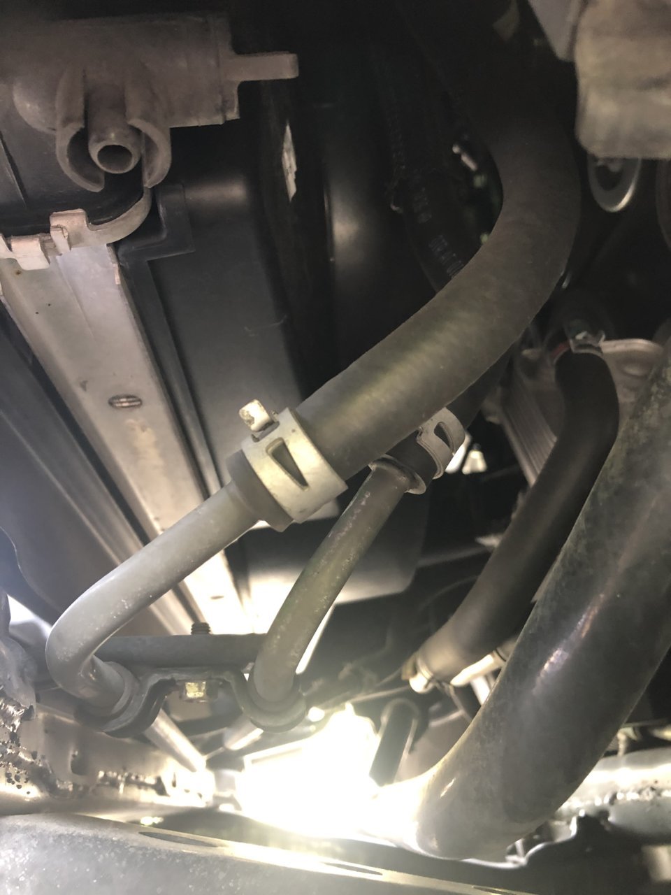

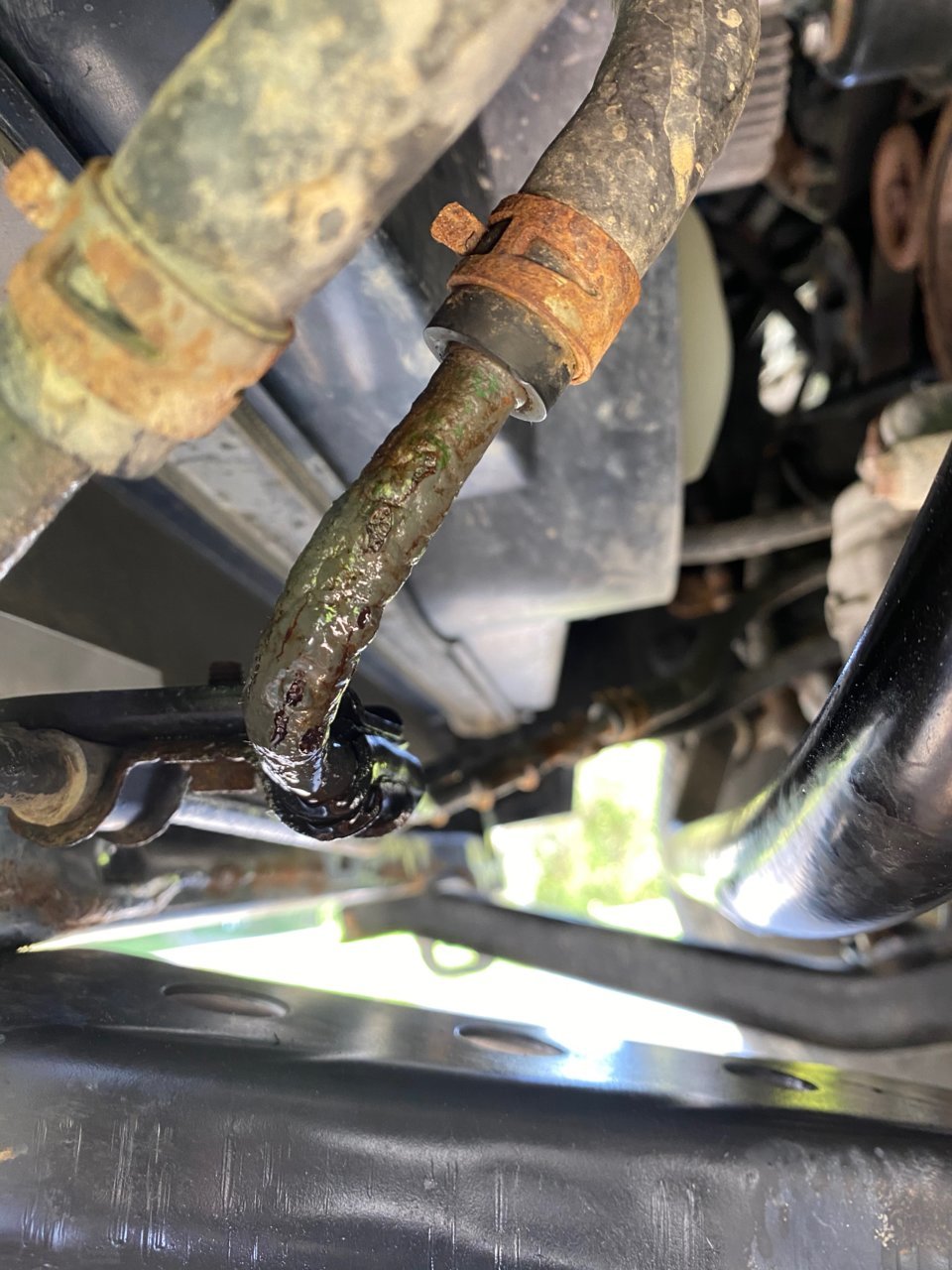

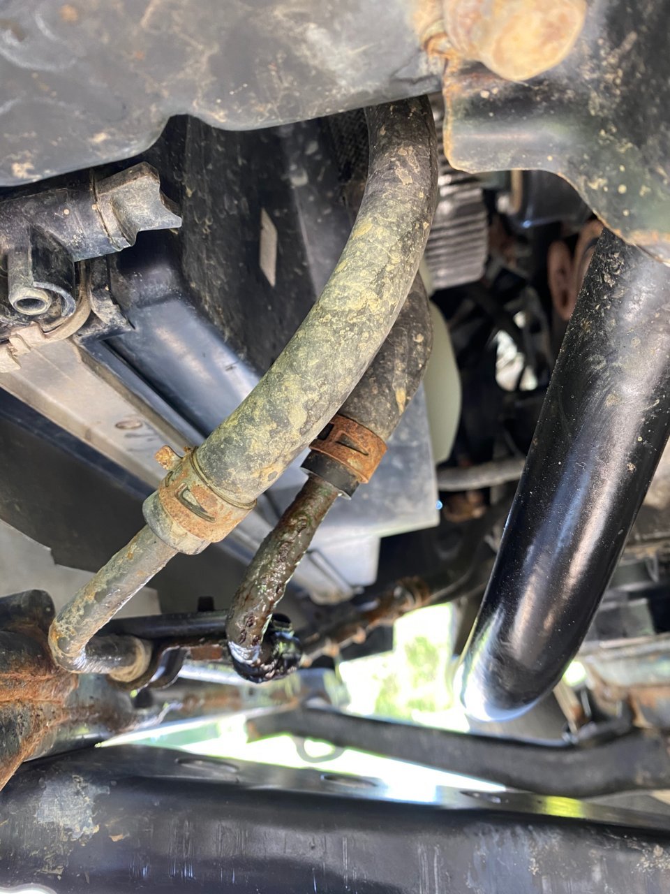

    I posted yesterday thought I have a power steering leak, but I think I finally found where the leak is. Please see the picture below. This line from the top of the radiator is all cracked and is leaking. It is a pinkish oily fluid, so it is definitely not coolant. I can see a much bigger rubber hose (coming out the bottom of the radiator) go to the thermometer and into the engine. This line comes from the top of the radiator. As you can see there is another similar line (I guess it is the return line) that comes out of the middle of the radiator.
    I have a 2016 Tacoma Limited without the towing package, so I though I shouldn't have a transmission cooler. Or does all 3rd Gene Tacoma have a standard transmission cooler (integrated with the radiator)?
    I really wish they still have the transmission dipstick so that I know exactly where my fluid level is. I should mention that there is a big puddle of this pinkish oil in the skid plate just overnight, so wherever it is; it will be empty very soon. So I am really worried about destroying my transmission.
    Also, it seems easy enough to replace this line. Is there anything I need to be careful with? Can I just replace the line and re-fill the transmission fluid (I know I have to monitor the transmission temperature when re-fill it).
    Please help!!! Thanks.

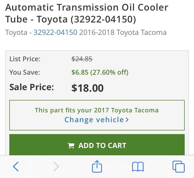

    I believe this is the correct part number for that line but I would check with your local Toyota parts department to confirm.
    As there is more than one

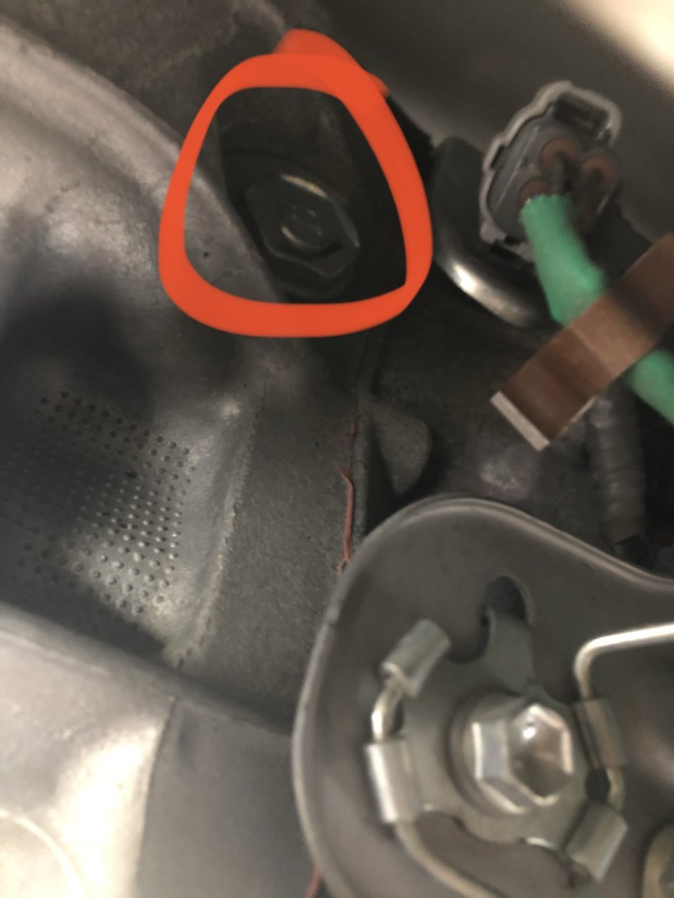

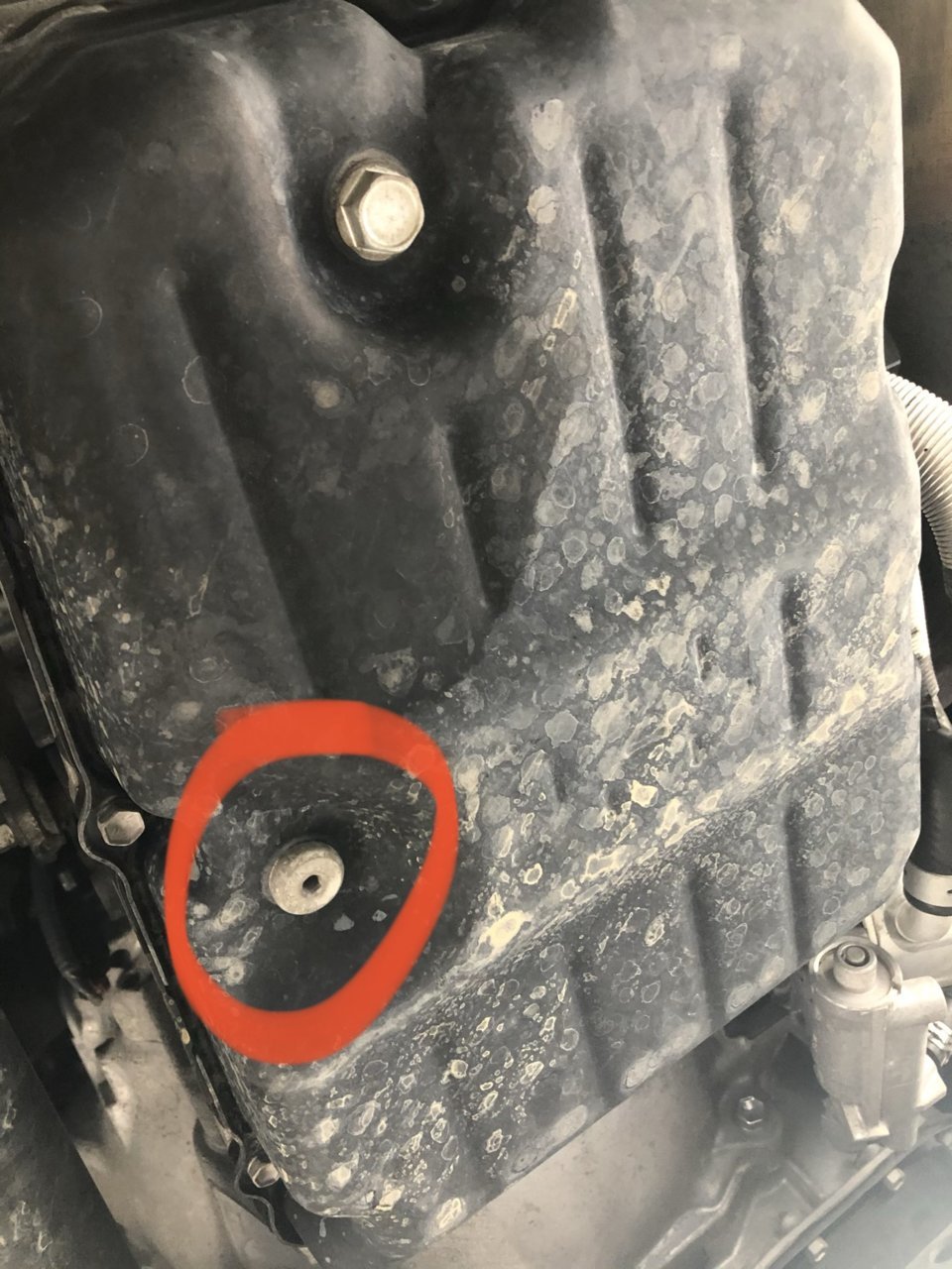

    0DB3462A-B458-4B0B-AA1C-40B9E77DEFFA.jpg BBFCE496-85B1-402A-B04D-540B4B30EFDB.jpg
    You can check your fluid level here (photo above) on level ground engine running transmission up to operating temperature...the fluid should just trickle out indicating full.
    The photo below is where you fill the transmission passenger side towards the rear of the transmission up top.

    From the picture its hard to tell what is actually leaking. Is the metal line cracked? Is the rubber hose cracked? Is the clamp tight? My inclination is road salt did not eat through that line in 4 years. Regardless, to be safe I would inspect all lines (e.g., brake, fuel).
